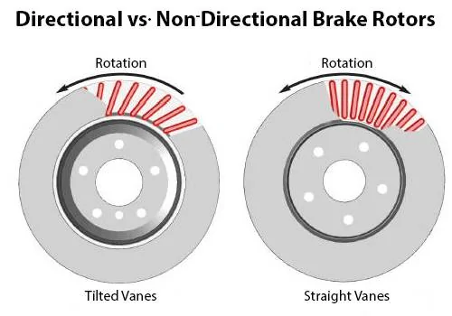

Both should point towards the back, sounds like you got two of the same side.
Great point!! I always thought that diagram was for the outside - slotted rotors. I didn’t even realize the inside (vented) vanes could be directional as well. Thus on RockAuto.com, some are right and left (directional) rotors and some not. I went and looked up my backup rotors (front and rear) & marked up the boxes as to which are which, lol. Thank goodness for your helpful threads ??
