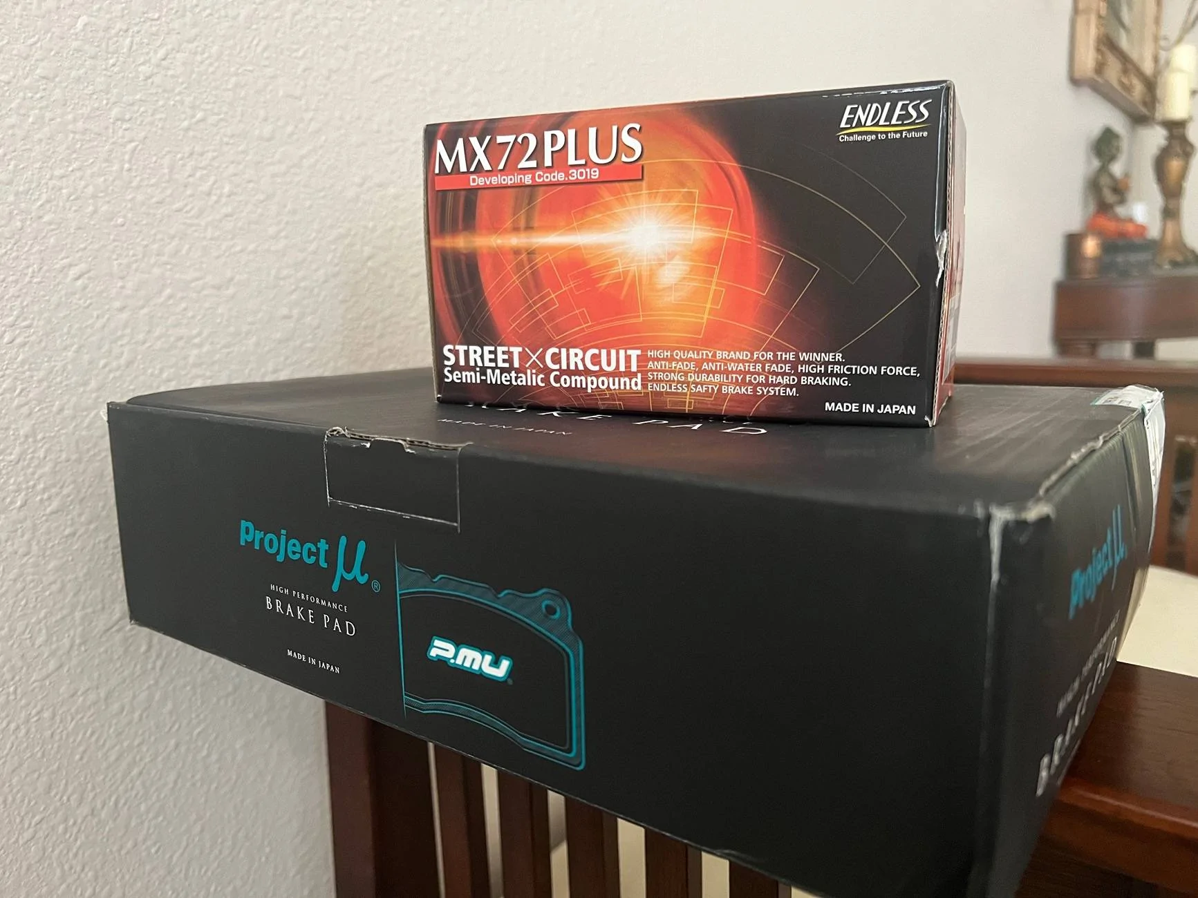

Pads are here. Project Mu Type HC+ for the front calipers. Endless MX72 plus for the rear calipers. Apparently I’ll have to bed them in even when I think they’ve been bed in.

While the wheels are off get some 400-600 grit sandpaper and rough them up to take off some of the glaze should speed up the process a bit.

Well alright. Does rubbing them against each other also count?

If you've had success with that, excellent. Personally, I've had zero success with removing deposits/glaze by hand with sandpaper. There is a 3M product that attaches to a drill with an abrasive that's designed for this - I've yet to try it, but it's in my Amazon shopping cart right now.
Since this has been discussed in this and other threads, bedding in PMu pads is more difficult than others. If you _CAN_ do it, start with fresh rotors for the PMu's.
Edit...this is what's in my Amazon shopping cart: https://www.amazon.com/3M-01411-Sur...a01-b60f-a7fe25ada257&pd_rd_i=B0009IIZGE&th=1

Yeah. I think I got lucky with the sanding. Did what I thought was a good bedding but at the track really hard braking caused some studder. But then did some sand paper and next track day was fine. Maybe just time in between days was enough but they are fine now

I do not plan on changing the oem rotors for now. Maybe in the future.
Garnet paper (low grit sand paper made for rotors) is preferred to remove old brake pad material, glazing, or uneven deposits on old rotors. Make sure you don’t sand too hard or long & inadvertently create an uneven surface. Or you won’t get the full/intended performance from the new pads.
Brand new rotors with new pads do not have these issues. The new rotors come factory prepared, ready to bed. All it takes is one lost track day $$$ to realize just replacing them with new pads is cheaper. At least in our case, with the Supra/Z4.
Some really good sites I found & saved during my misadventures - worth checking out (the 1st one especially - the tabs on the left side - many good topics):
https://www.brakes-shop.com/brakepedia/general/myths-of-the-braking-system ?? this one
http://cartechstuff.blogspot.com/2013/03/brake-rotors-part-2.html

No sense in tossing perfectly good rotors for a pad change, IMO. If/when they start to shudder on track, just power through and it will get better. A rough session or 2 but multiple days/sessions later and zero issues since.
