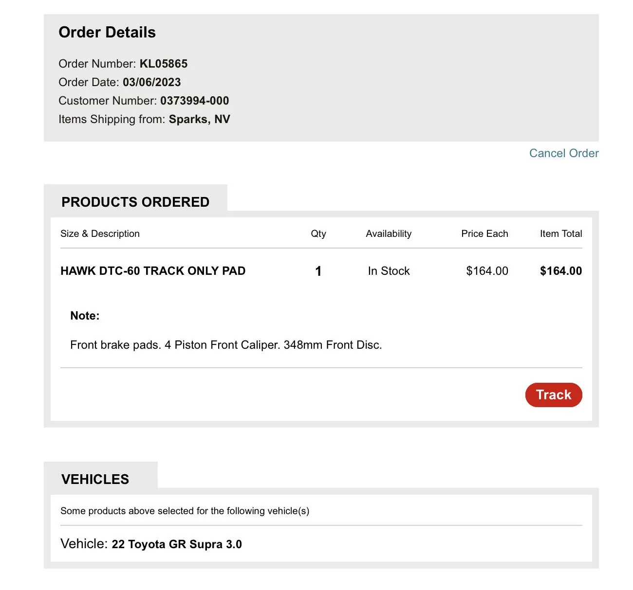

Since you and I are using these pads as intended, on track, what should I be looking for with the average Mu? I’ve run Hawk DTC 60 and Paragon R7. Both worked great in town and on track. Stopped repeatedly w/out any fade. That being said, the Endless (for example) matches the highest price CSG, on paper (Temps and average Mu). Can one assume they‘d be comparable?
I know you’ve said before that we don’t need to spend an arm and a leg on pad. I agree but…. I haven’t used the gold standard CSGs yet. I’m only repeating this in case new peeps are checking out your awesome thread! Carlos (faster than me at Homestead and @Todday1) uses Hawk DTCs and I’m sold on how long they lasted me compared to my only other tested pads, the Paragons.
Thanks again Brian for all you do for us track rats ?
It really comes down to the setup of the car and what the driver likes. However, IMHO, baseline for real track use should be a pad that can tolerate 1200F+ without a significant Mu drop-off.
I personally like a pad with 0.50+ Mu. These published ratings by themselves have to be taken with a grain of salt though. The best pads will have a more linear Mu plot across their optimum temp ranges. Spikey Mu is harder to drive in my experience.

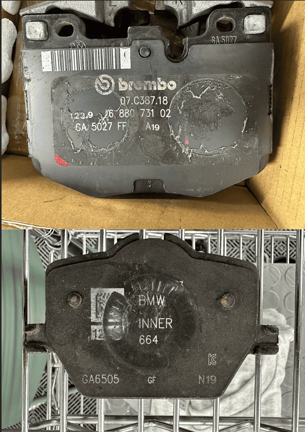

Update! Found my OEM 2020 Supra pads.
Front pads: FF
.35-.45 from 200-650F
Rear pads: GF
.45-.55 from 200-400F
.35-.45 from 300-650F
Front pads: FF
Rear pads: GF
Dude…. You are a genius & quite the detective! I really thought (assumed) these had a higher temp range. Confirms I wouldn’t use them on track but would be great for the “canyon carving” as mentioned above ??
Keep up the great work! So glad we’ve got you on our forums ✊?
