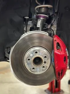

Question for the track Goers out there, I just had the Endless MX72 front pads on my car. Put them on with brand new OEM rotors and a generic DOT 4 fluid (stock lines) First track day January this year was excellent. Car performed fantastic, brakes were great. A few weeks later at the next track day, I lost brakes on the first session. Pedal all the way to the floor. (Butthole puckered up nicely). Done for the day. My technician bled my brakes and we did have a little air come out of the right front. After flushing the fluid, this time with Motul RBF 700, I still don't have brakes. Rotor's are gone. Is it possible the pad scorched brand new rotors beyond use? They do have a blueish hue to them after this second track day.
I am looking to replace Pads and Rotors all the way around this time, along with upgraded lines. I think I'm going to go with the Hawk DTC-60's. I would love to use the OEM rotor if I could but worried of having the same issue?

No pedal/pedal going to the floor is boiled fluid/air in the lines. If it was pads you would feel pressure but it would feel like wood and not stopping.
Plenty of people using OEM rotors with no issues, myself included.

Boiled fluid and insufficient pad for track use. Boiled fluid also means there's going to be oil in different parts of the system.

Wow ? and so sorry to hear brother! Hence why I bleed more than most. At least on this forum. I had this same issue long ago and now I bleed the ? out of em. Brian is spot on as usual for your reason, air or fluid boil. However I personally doubt it‘s fluid boil unless it sat in your car for a while ?‍♂
Steel brake lines are easy and affordable. Good thinking!
The rotors, I’m still learning more for this car but really surprised the OEM ones are (were in my case) so stellar. It’s really odd that they put such good $$$ rotors on a stock car. I’m guessing they are lighter (2 piece) than the replacements ones I bought at RockAuto. I‘ve always gotten the cheapest “coated” vented rotors, out of habit, for track. It’s what my previous race team buddies always did for me, down here in FL. That being said, once you’ve cooked them (turned blue) they are done. The guys always pulled em off and replaced mine if/when that happened. It’s not often but it does happen.
If you do stick with your OEM rotors (still thick enough), you could scrub them a bit with low grain sand paper and then clean everything with spray can brake cleaner. This is overkill but would ensure a proper bed in. Piece of mind if I was doing that.
Which leads me to… our Supra 3.0 premium rotor cost have come down so much since these threads started. I just spent $400 bucks for a complete set of new rotors (front and rear). They are going on with my new Hawk DTC60/30 pads next week. It’s mega controversial ? but I want to start fresh. Like you, one bad experience is all it takes for me to go overkill . Time = money and I personally don’t want to screw around.
