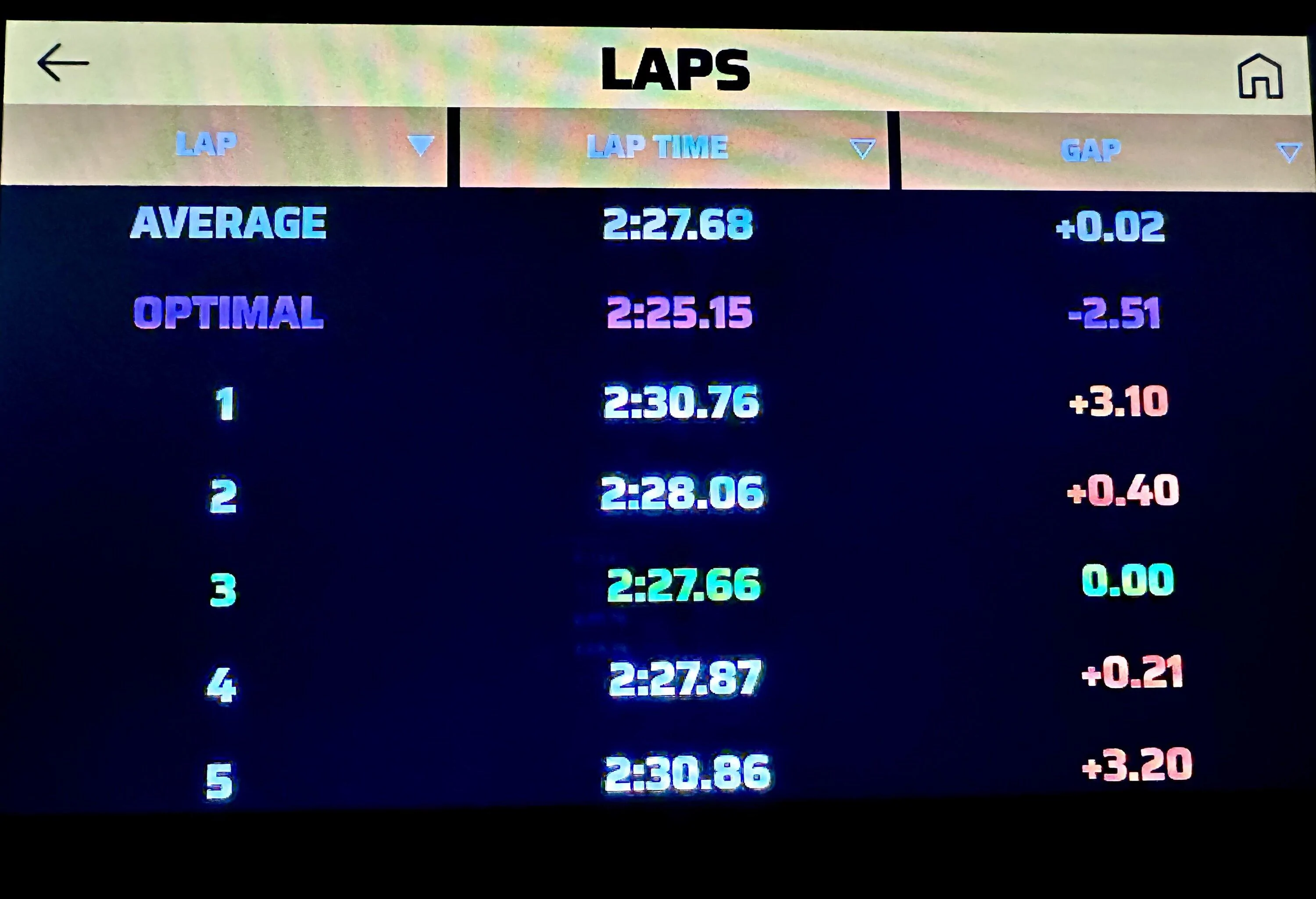

Beat my previous track time with braking less & more trail braking. Tried making a full weekend on them. Wife & I driving double duty. So they were getting their fair share of track time. Hindsight is 20/20, I should have brought another set of fronts to the track. Will do that next time ?
