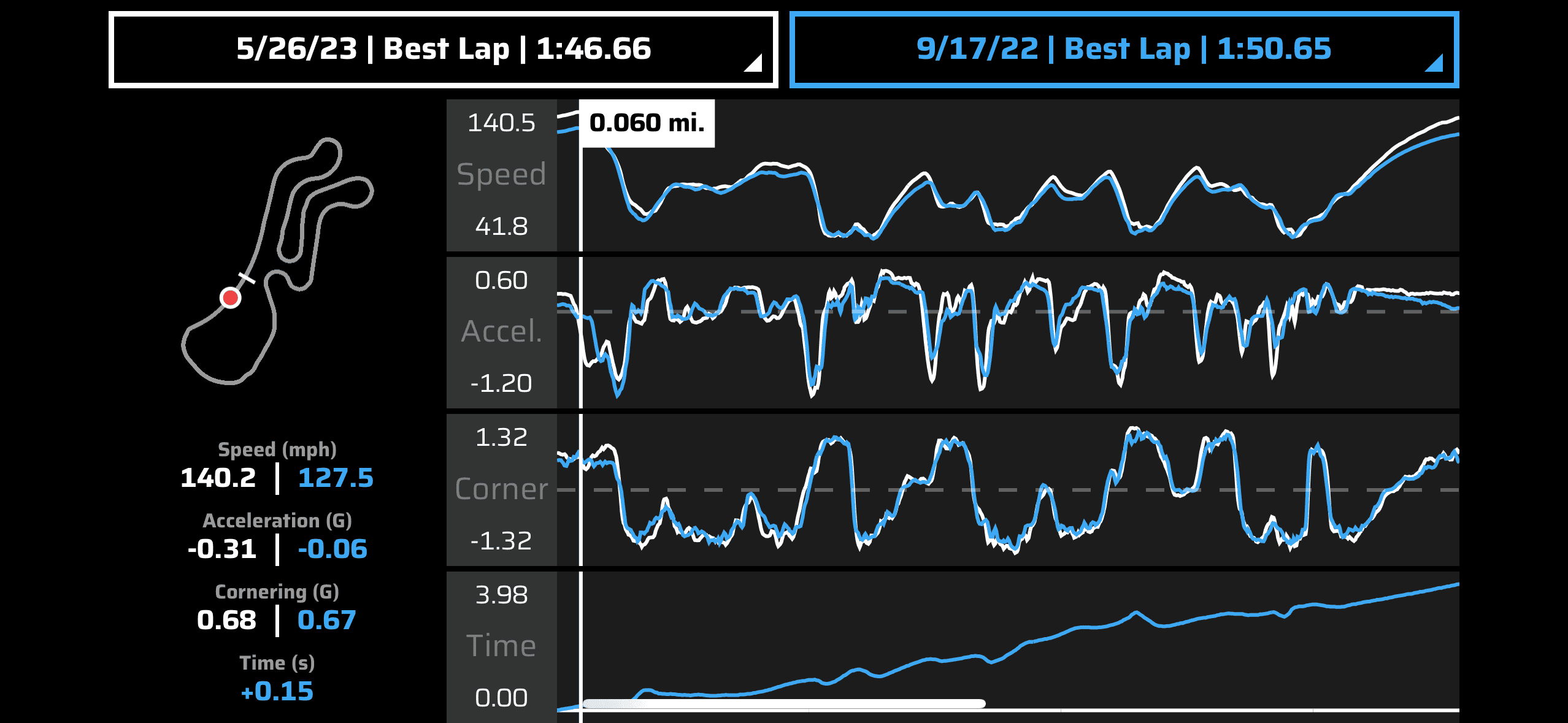

I’m up 13 mph in the straight at Palmer compared to last year on stock power and still have zero issues with the Project Mu Club Racer brake pads. Great price, great track performance. YMMV depending on your local track.
What software are you using? Is that the catalyst?

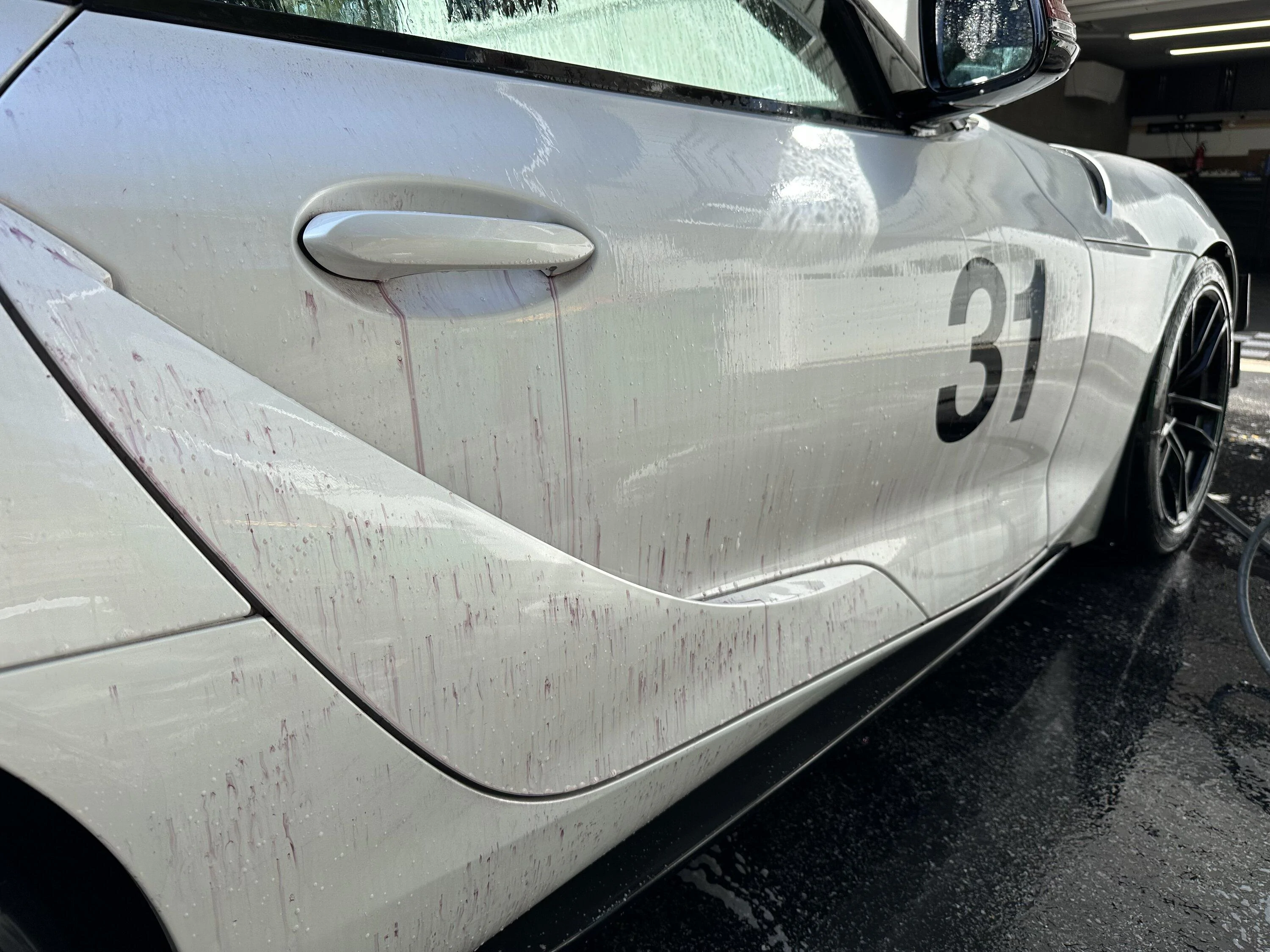

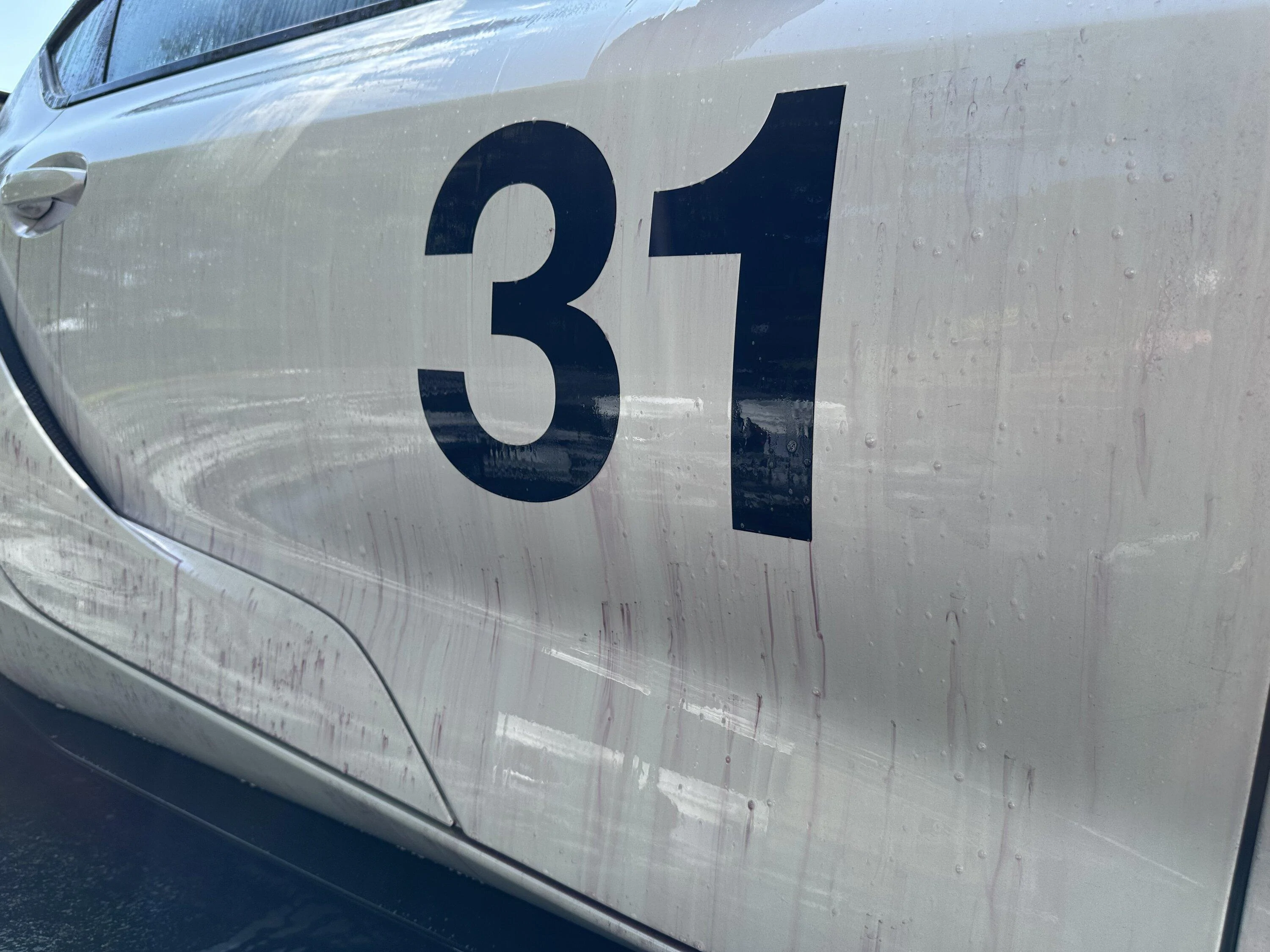

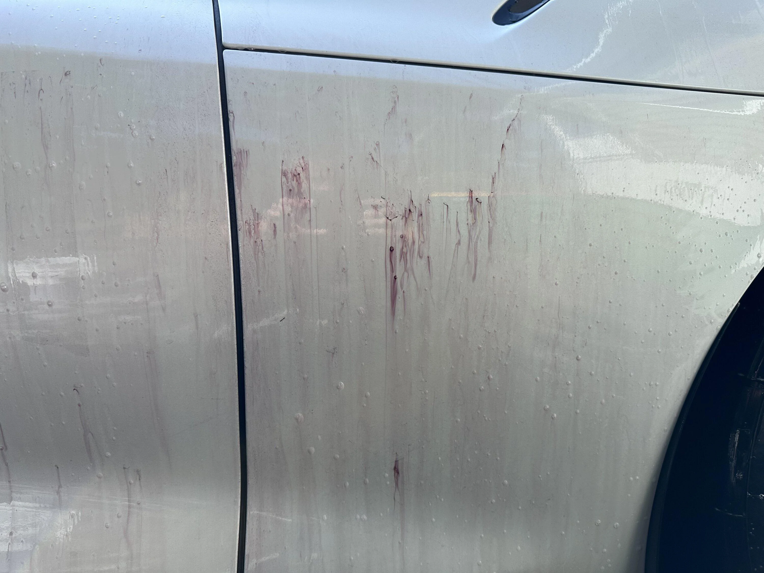

If you use CSG brake pads and care about your paint long term, make sure you use a good iron remover when washing your car after a track day.
This is after one track day with CSG C21 pads in the front. The whole side of the car has iron embedded in the paint. My PMU Club Racers also did this, any good track pad will, but at a MUCH smaller scale.
Holy shit ???… That’s a bit excessive. If that’s from the CSGs, I’m digging my Hawks even more ?
