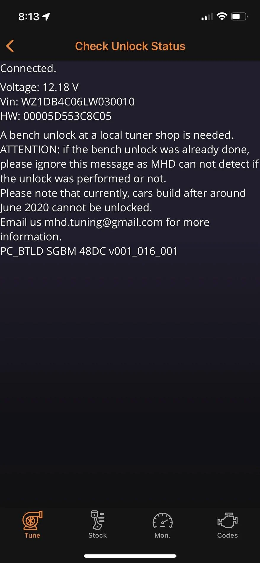

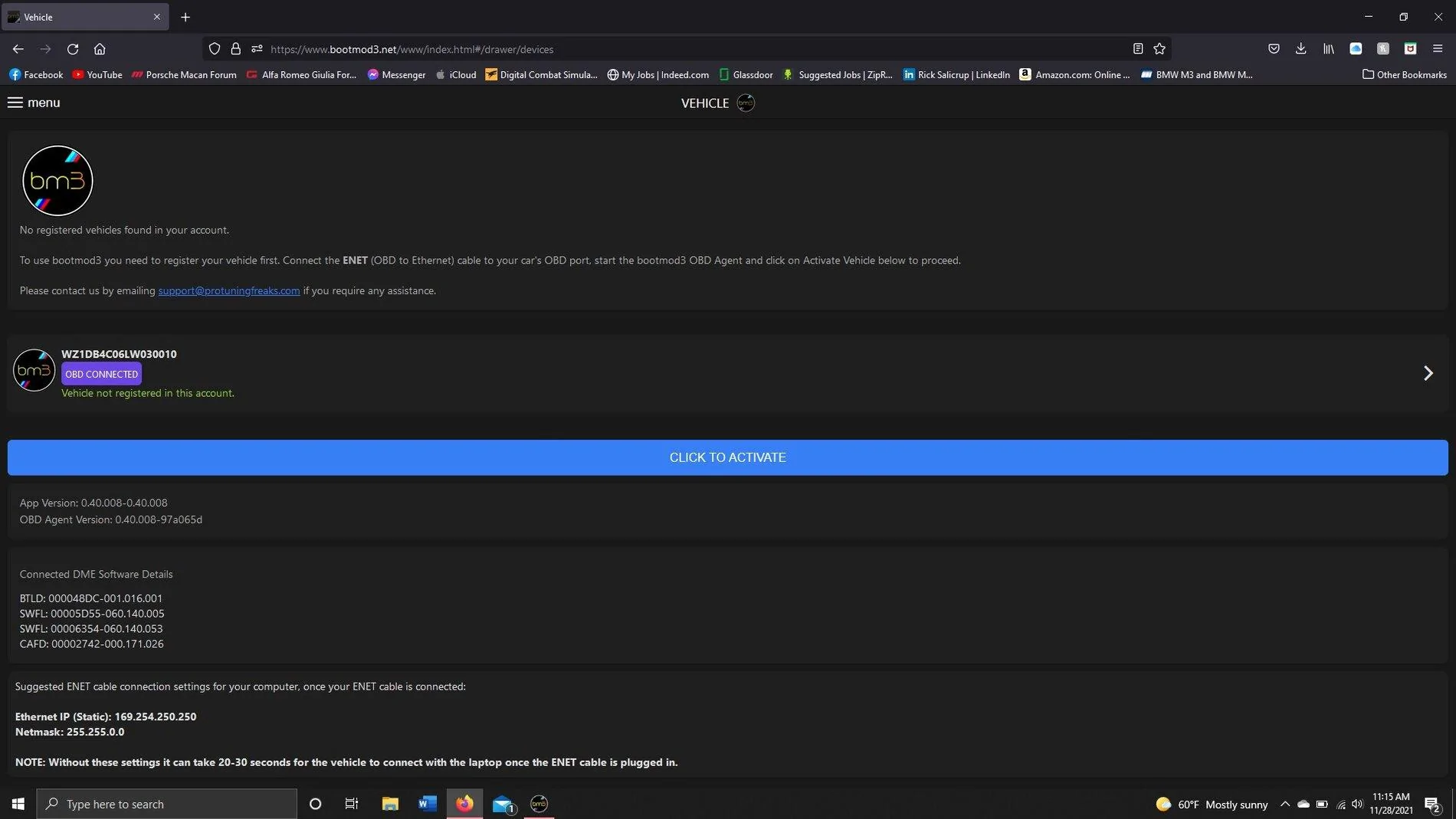

Ok. I’ve linked to my ECU via obdII > Ethernet cable > to BM3 app and screenshot my vehicle ECU data and was told it doesn’t need unlocking at this time. Not sure what “at this time” means, but what would my next steps be to running the car?
You would need to purchase a tuning license for your specific vehicle platform through BM3's purchase page and then you should be able to literally just flash the OTS maps straight onto the car, assuming it works anything like MHD does.

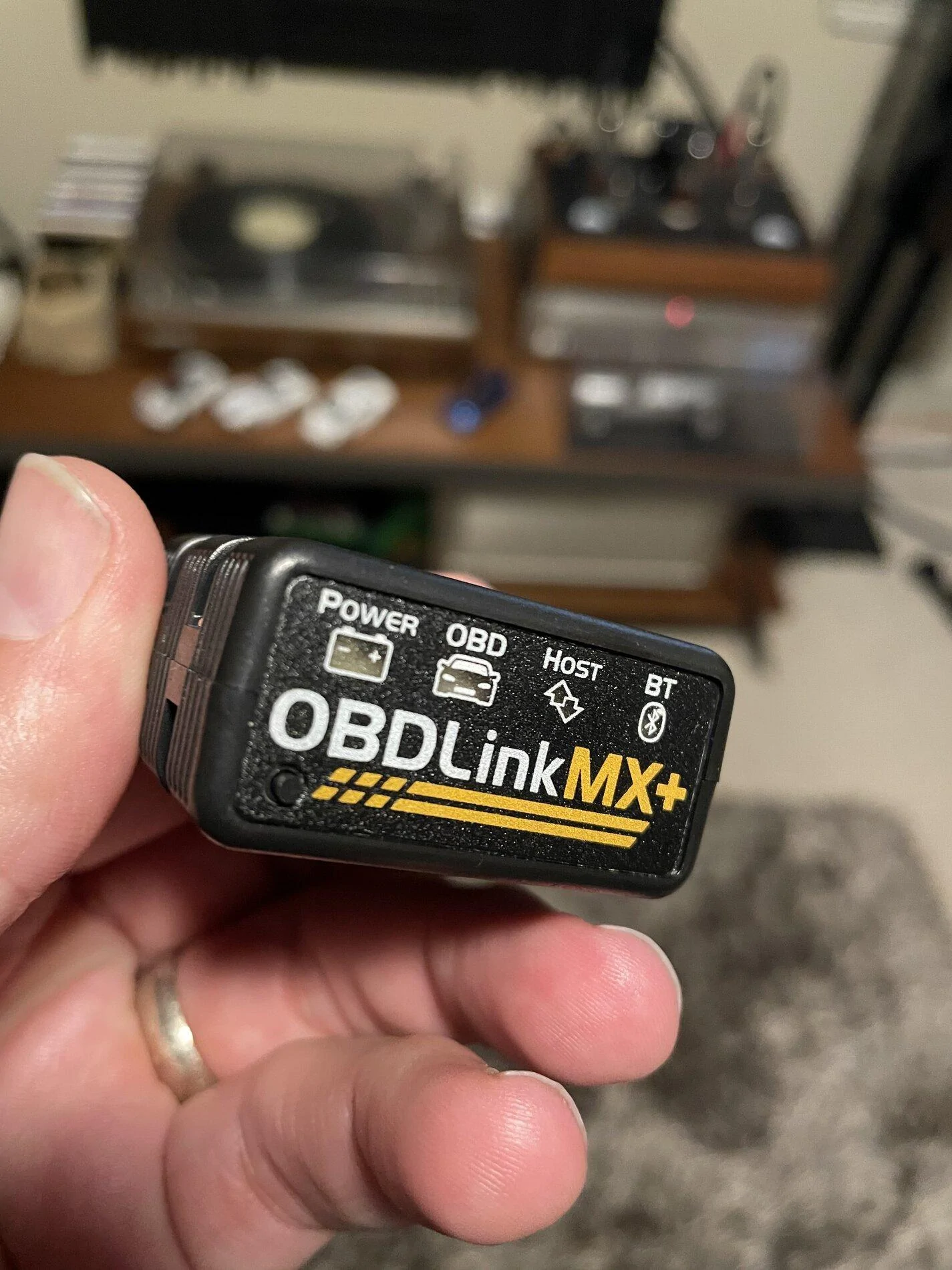

Ok. Went to pro tuning freaks webpage and their diagram for programming the software to the car shows an OBD AJENT device between the phone and the CPU, what is this piece of gear for? The description doesn’t really clear it up for me.
also, if the agent is just a way for wirelessly hooking up you phone can I use this:
That device is not the same type of OBD2 Device you would need to tune, that device would be used for check engine code scanning and using Bimmercode to actually code software changes. If you're going Ecutek, you will want to look into an Ecutek branded OBD2 device, an Ecutek software license, and either your phone with the Ecutek application or a laptop/tablet. The same thing goes for MHD. MHD has an OBD2 device as well, and perhaps Bootmod3 does too, I'm just not familiar with BM3.
