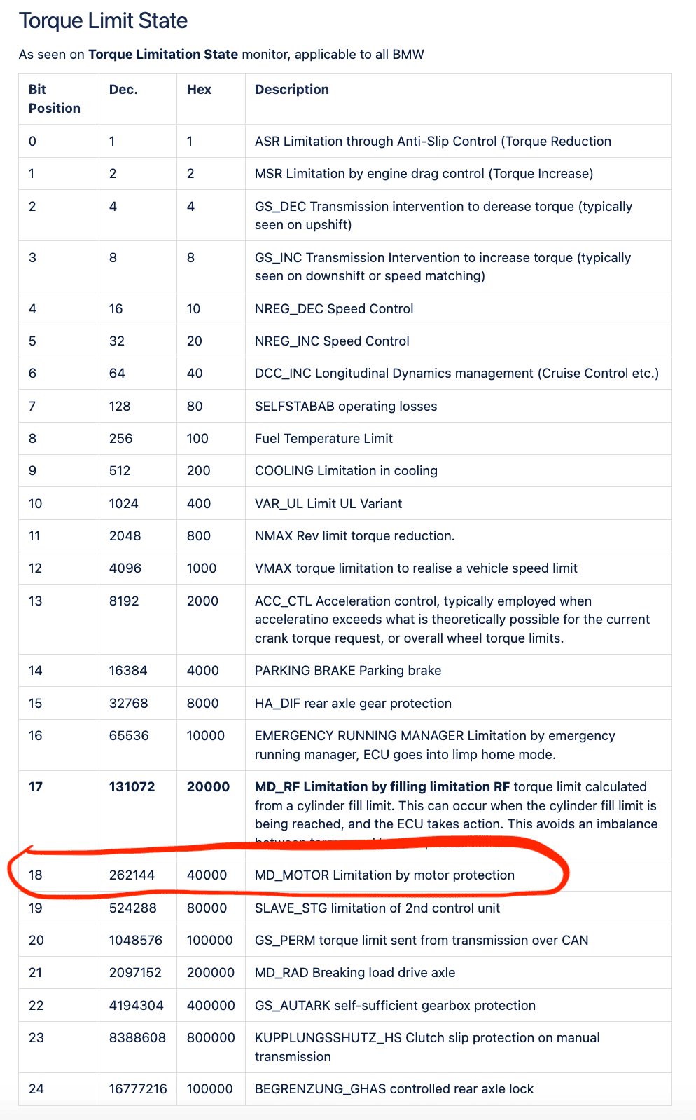

Torque Limitation 262144
Ecu is only targeting 100 load and throttle is limited to 50%.
You're in limp mode. Did you try clearing everything?
yes i reflashed mhd to the car several times and cleared the codes it would run fine for a day or so then it would start to act funny again and go back into limp mode.
