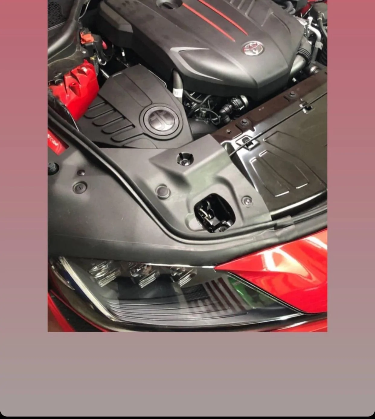

I have the Takeda, makes nice whine and spool sounds. Can only really hear in normal mode though, because of dp. Also customized the box so it looks more stealth and doesn't have red and fake carbon sticker rice on it haha.
