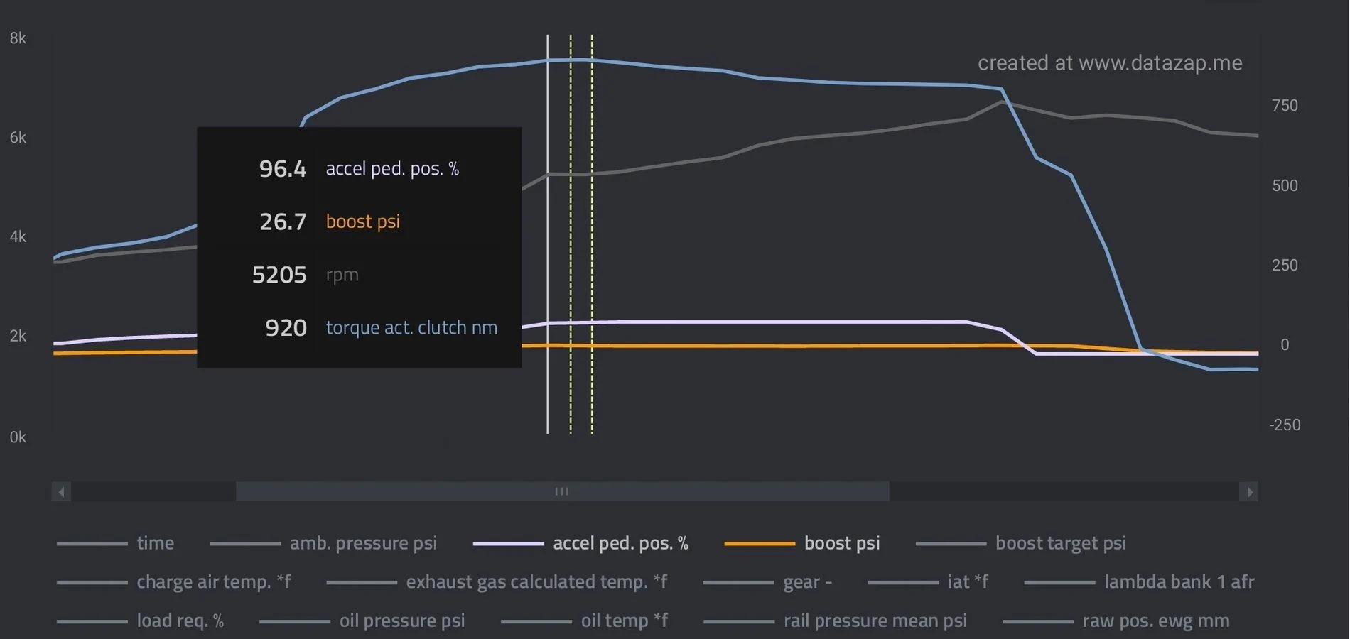

Getting around to some more transmission testing last night. We are now sending over 900nm of torque to the TCM. Still a little less than the real torque we are making on our car. But the trans is definitely liking seeing the right amount of torque on the software side.
Car is more snappy and less lazy under full load. Shifts better than we had it shifting in prior video shares. Weve done pulls 1st through 7th gear and touched 8th a few times. Of course this is all done on a track or mexico.
And yes, the trans tune is still completely stock and untouched.

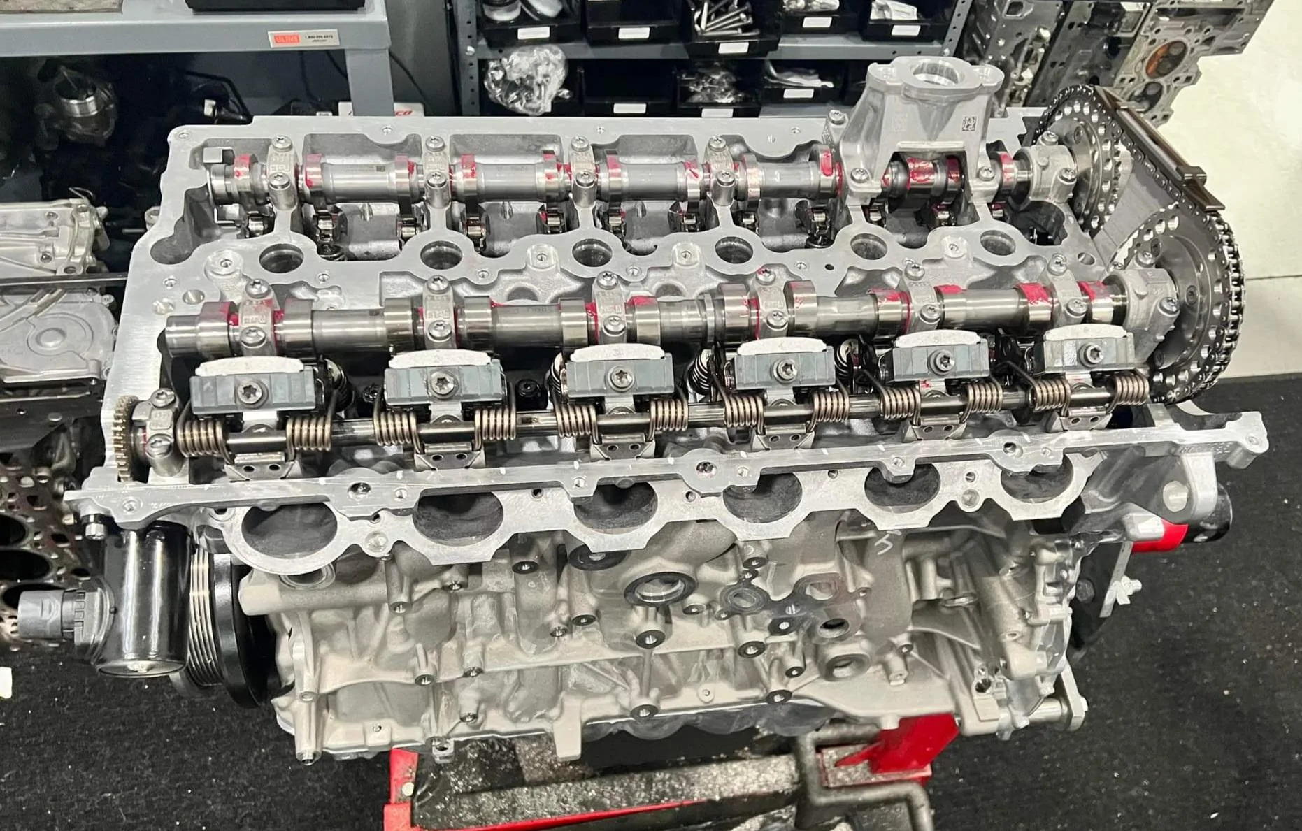

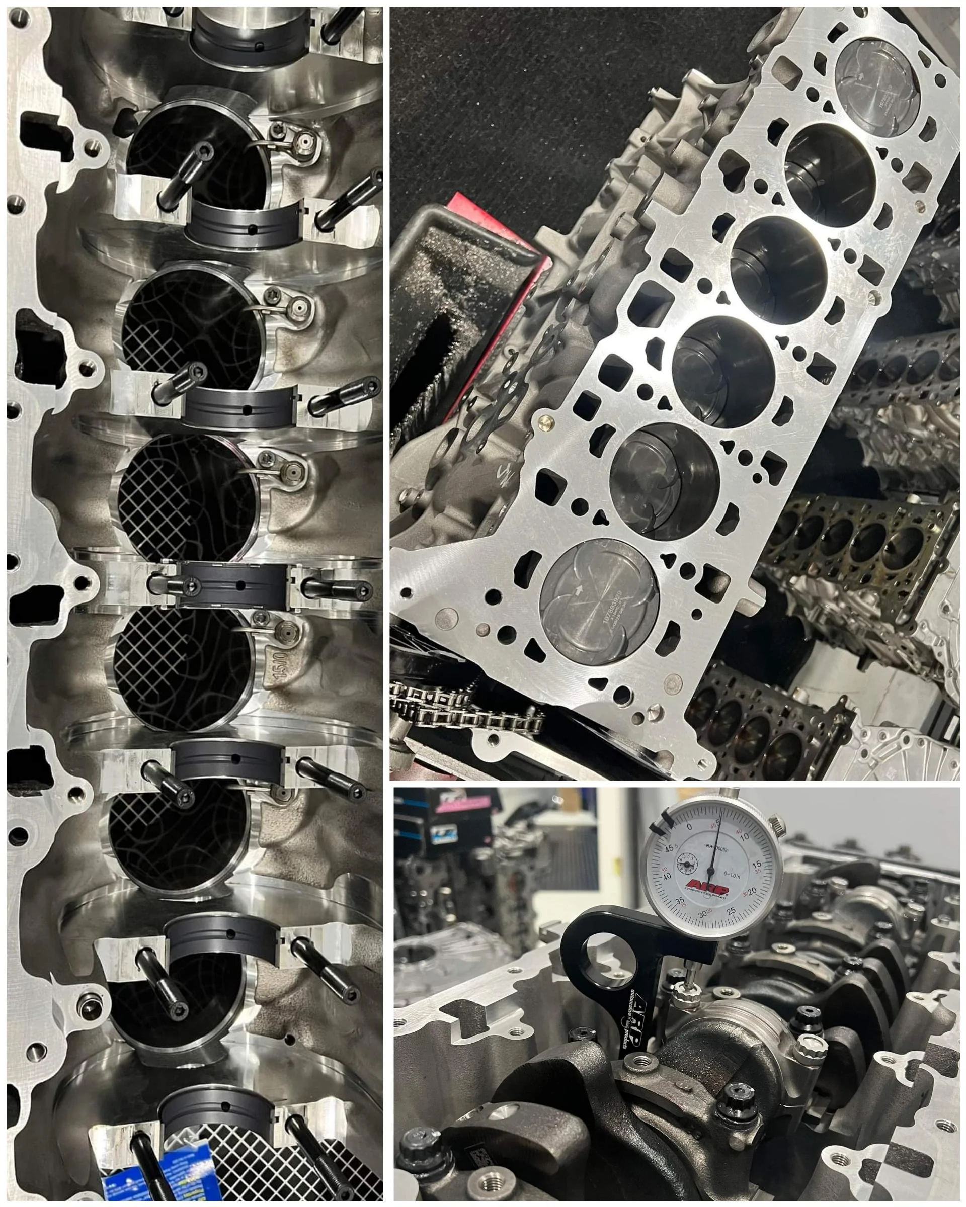

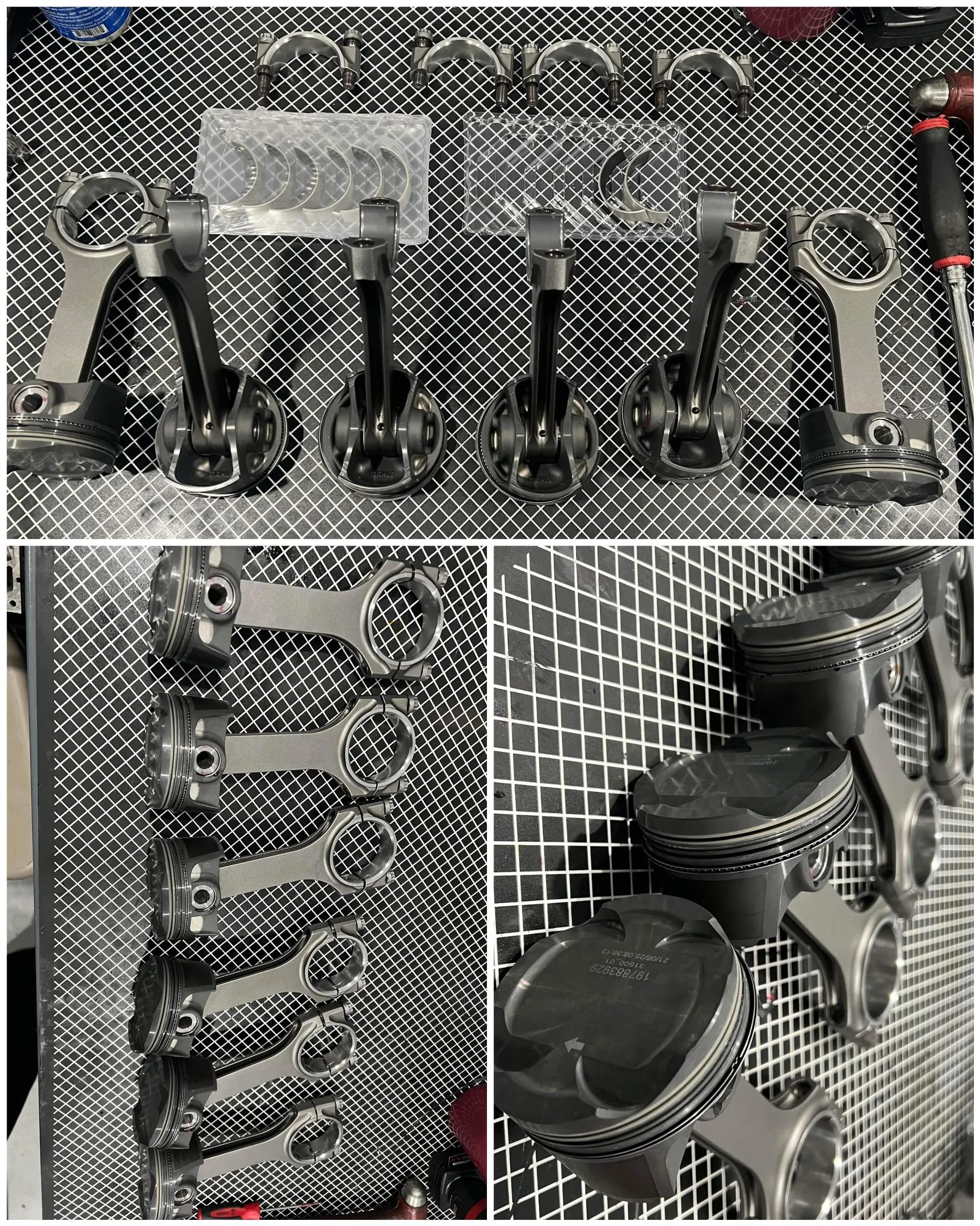

Been busy developing things for the community and keeping up with customers and day to day. Just wanted to Toss in an update in outs shop car.
We finally got around to getting our spare engine built and finished.
Next milestone for our car is 1000-1300whp and will likely leave it there for a while until we decide what we want to do with it next.
Some photos of the engine.....

Looking great. Just pistons and rods or did you go all out??
rods and pistons, with upgraded and coated bearings, ARP rods, mains and heads. Didn't see the need for anything more. If by chance i do find other limits. i'll use my stock engine that im removing to rebuild stronger/better than whats currently going in.
