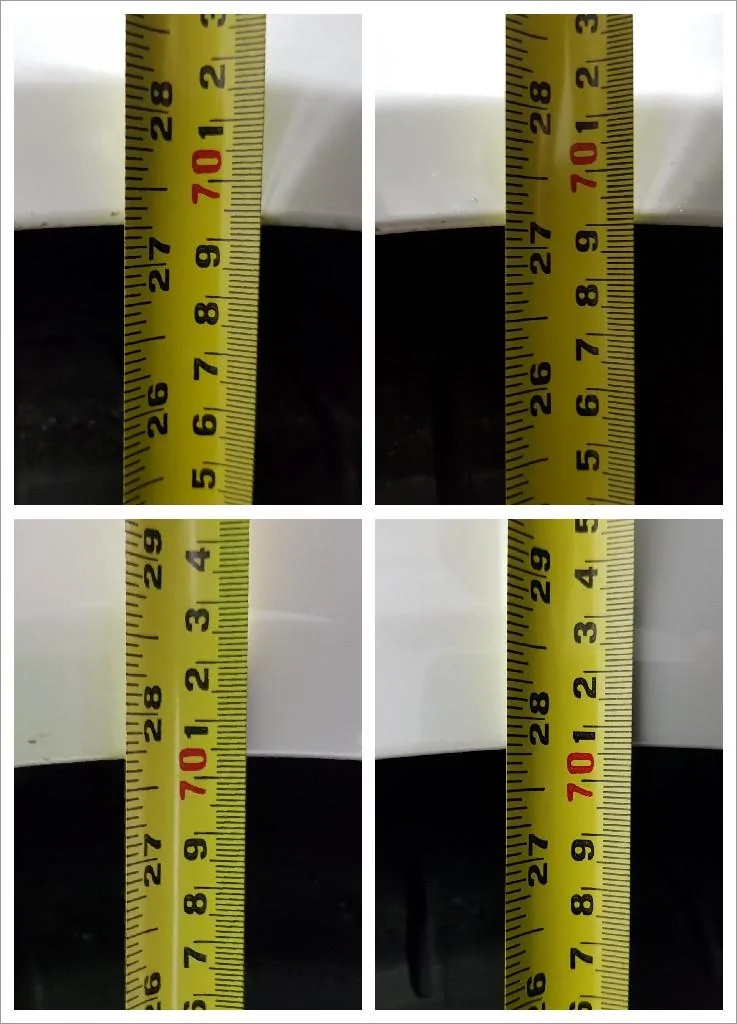

A coworker mentioned my car looked a little crooked so I broke out the measuring tape. Sure enough - he was right. The passenger side is 0.625” higher than the driver’s side when measuring from the ground to the top of the wheel arch. The front and rear show the same height difference, and the gap between top of tire to top of wheel arch is visibly different. Car has 3000 miles on it on stock suspension. Planning on bringing it in to get checked unless others are observing the same. Anyone?

Here are my measurements.
Top - fronts
Bottom - rears
Right - driver
Left - passenger
[Edit]Sorry the collage software put it like this. Just realized it.
FD 69.0cm 27.17"
FP 69.3cm 27.28"
RD 70.7cm 27.84"
RP 70.4cm 27.72"
Both 3mm 0.012" difference. [/Edit]

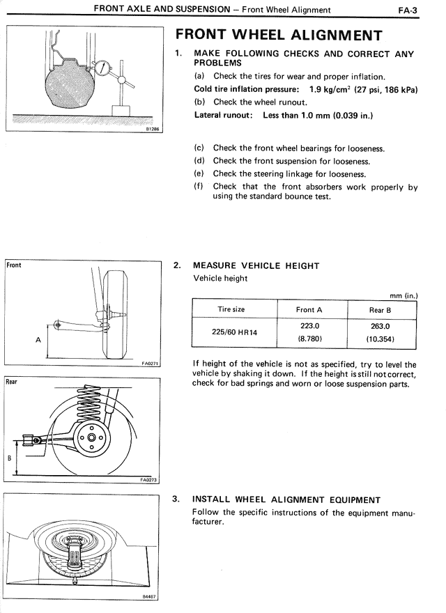

Just a FYI, but the distance from the ground to your fender line is an inaccurate way to measure whether your suspension is sitting correctly. The engineers don't care about the distance of the fender to the ground, they care about what angle your control arms are sitting at. I don't know if there is a FSRM for the mk5 yet, but the mk2 is mac strut as well and this is how you check your ride height on it...
Measurement A is what you want to compare, to the other side. I'm not sure what B would be on your car for the rear, probably the inner bolt on the lower A-arm or lowest link depending what style of arm it uses. You can't compare B to A, you would need the correct numbers for your car. These are the distances the engineers care about, and any variance in them from stock (not including from tire height differences) will affect your alignment and how good your suspension geometry is. The front end is particularly susceptible to bump steer and camber loss\mid corner grip from height changes due to the mac struts.
Keep in mind you need to put the car on perfectly level ground for the measurements to be accurate, and the amount of gas in the car will affect the results. When I align my race car, I actually do it with the amount of gas I typically run (about 1/4 tank, the mk2 has wicked baffling), and I throw a bunch of weight into the driver seat to approximate myself sitting there.
I know, the distance to the fender is what your eye sees and effects its look in pictures the most, but it doesn't actually matter. I would be suspect of the mk5s poorly fitting hood too affecting those numbers. Besides the fitment issues, a clam shell hood's alignment can effect the number you are coming up with as the hood stoppers at the front are adjustable, another reason not to measure that way.
