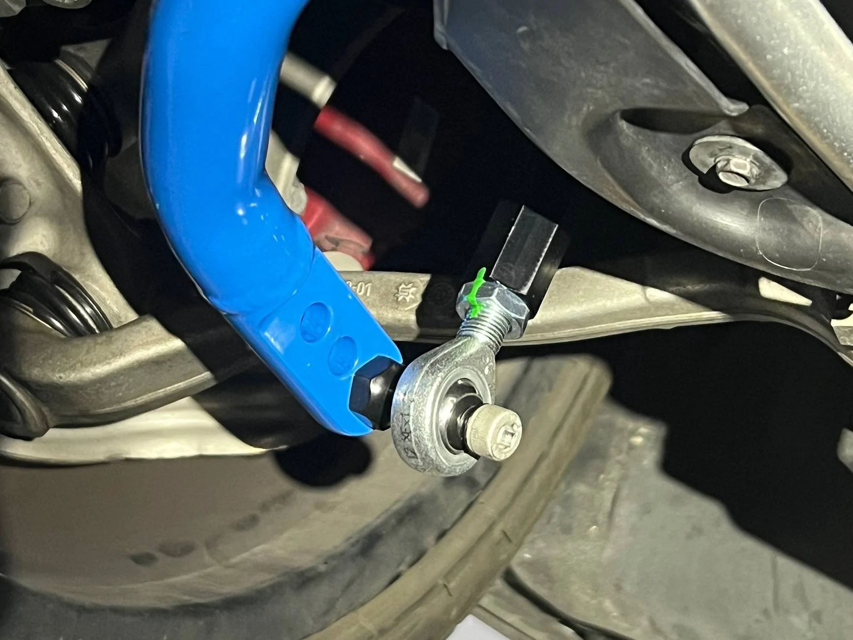

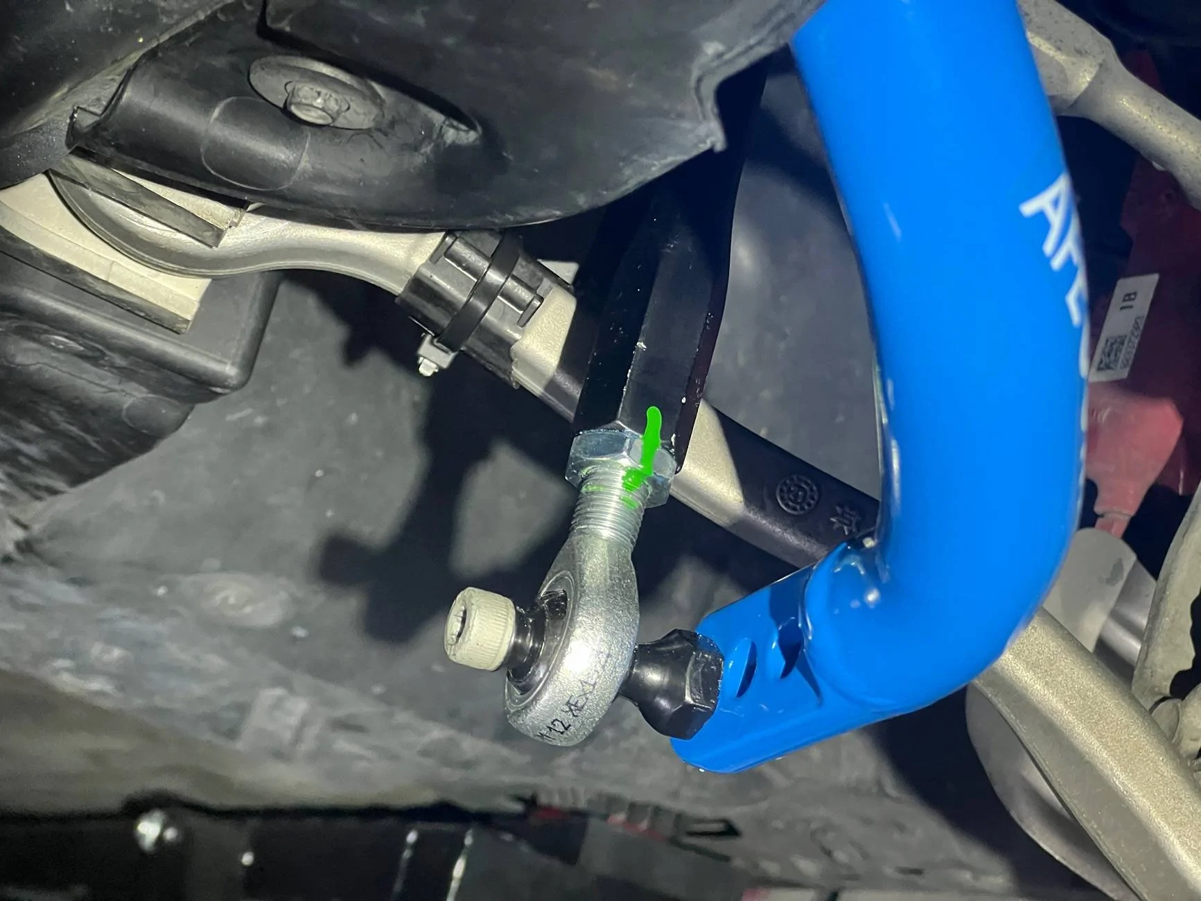

That’s actually clever. Attaching the sway bar last instead. I’ve been fighting with these adjustable end links for a while now. Originally had everything set right but noticed the tie rod bearings on the last end link I had tightened down was completely offset. One bearing completely turned full lock and the other one exactly in the center. Car was on the ground, wheel straight, pressures matched and weighted driver seat. I got everything set right now but my driver side tie rod has more threads protruding than my passenger. Maybe I’ll just fix it later on if I have any issues lol.

As long as they aren't bound up, aren't about to strip, and go on/off without effort, I'd send it.
