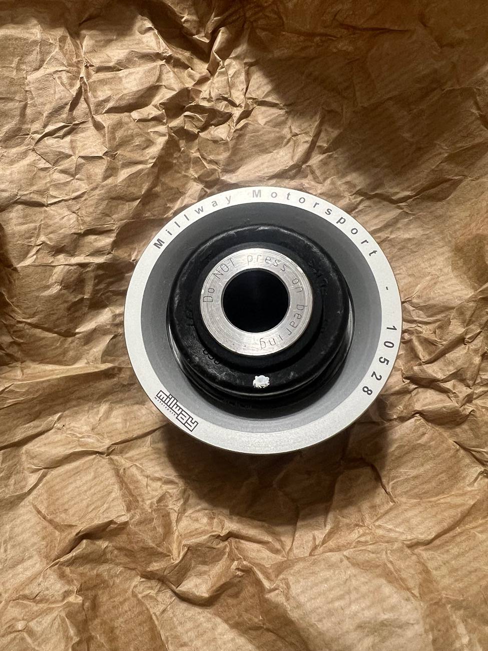

The thrust arm bushing I used Millway:
Front Tension Strut / Thrust Arm Bushing Street BMW G20 G21 G26 G42 – Millway
The lower control arm bushing from Millway would also be very great option, unfortunately it wasn't available when I was in the market.

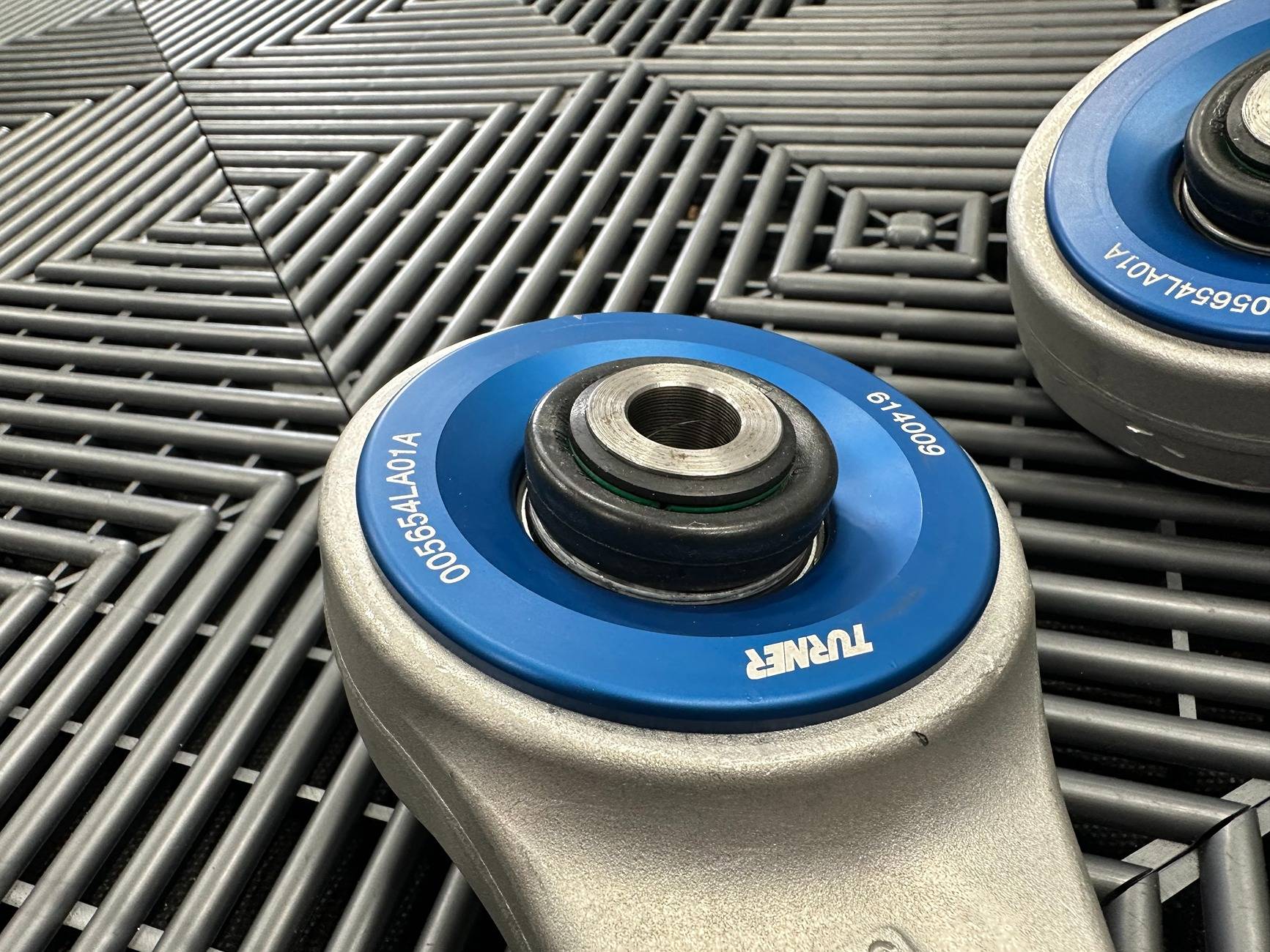

I bought the LCA bushings made by Turner Motorsports. Very well built as well. All bushings are sealed and won't need any follow-up maintenance from rusting.
005670LA01 - Turner Greasable Front Control Arm Monoball Upgrade set - A90 G29 Z4 | Turner Motorsport

The arms with monoball bushings are surprisingly quiet. The improvement in handling is dramatic. For the front I installed monoball bushings to the OEM arms just to avoid issues like tiny Allen key locking mechanism getting lose for those adjustable arms. The result is very successful. No noticeable NVH but huge improvement in handling. The “response time” for the car from steering input feels like improved 500%. The thrust arm bushing dramatically improved toe stability from hard braking, as well as greatly reduced nose-dive behavior. Braking becomes much flatter and gives me more confidence.
Nice, I used the Turner bushings in my caster/thrust arms. So nice that they are sealed.
