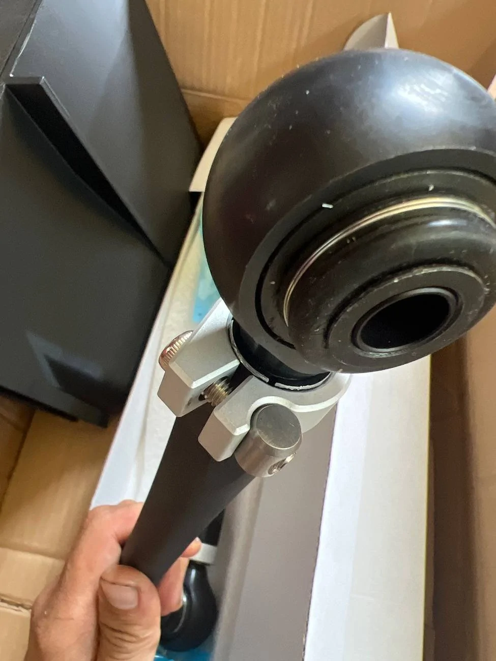

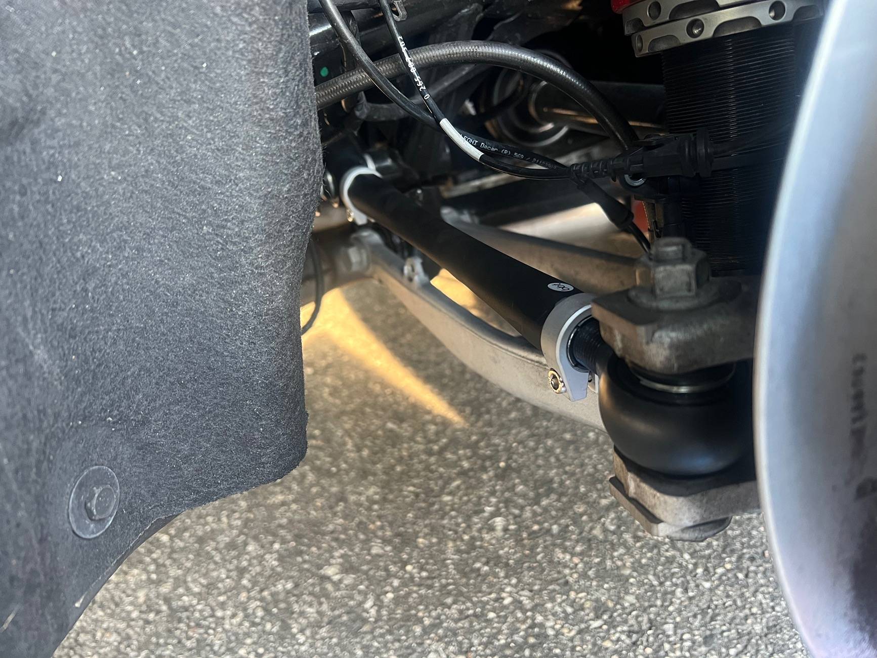

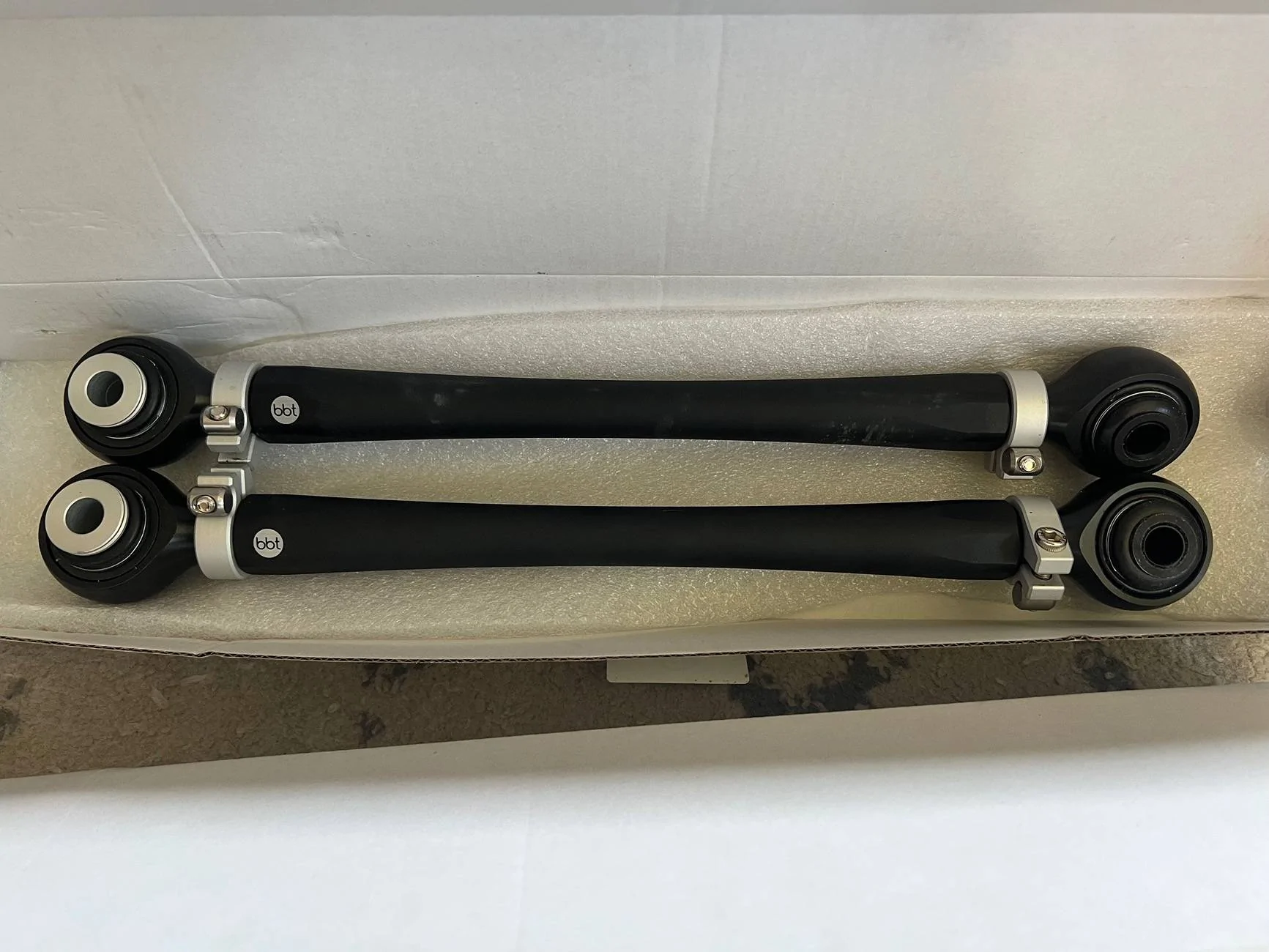

I understand that verkline is proven at this point. I am looking to buy a full set of Verkline myself but they are always out of stock, they are expensive, and if i need to warranty their parts I have to send them to Europe. Is there a reason you say SLG products aren't trust worthy? Or just buy Verkline because they are proven?
If you do buy, hit up [email protected]. He's on the forums too but doesn't really participate. He's the one who specs out the FA510 suspension for members. I just got my full Verkline setup from him and he has direct distributor access with more up to date stock info. Half the stuff I was looking at was sold out on the Verkline website but when I ordered from him, they had everything in stock except one bushing.

I wouldn’t touch that rear arm kit.
besides the fact that I’ve got 0 confidence in anything they design, they’re running the same fk bearings that fail on SPL stuff.
FWIW, I have built trophy trucks and trophy buggies that have raced as much as an entire season with exposed FK Rod Ends. I have a strong suspicion that something else is at play with SPL aside from the rod ends. My guess is the top hats. Slightly oversized top hats will murder rod ends in under a minute. My second guess is that they aren't running the right series rod ends.
If both your 16mm FK rod end and your 16mm Aurora rod end are failing, you're undersized.
If your 16mm FK rod end is failing but your 16mm Aurora rod end is fine, you have a top hat issue.

Outside of quality assurance and performance standpoint. When installing my Verkline end links, I somehow manage to lose one of their washers (unique to their endlink). They're Poland based, so it did take a while for it to ship... SPL is US based.
Same for me. Love the parts & can’t wait to test them more. But from a warrantee standpoint, it can take a while to get things. They sent me their online catalog for exact part numbers. If anyone else needs it (below). Saves some time & nothing gets lost in translation.
https://drive.google.com/drive/folders/1bEiiArbMPhojfa_vtYBemcDk9GCau7bb
