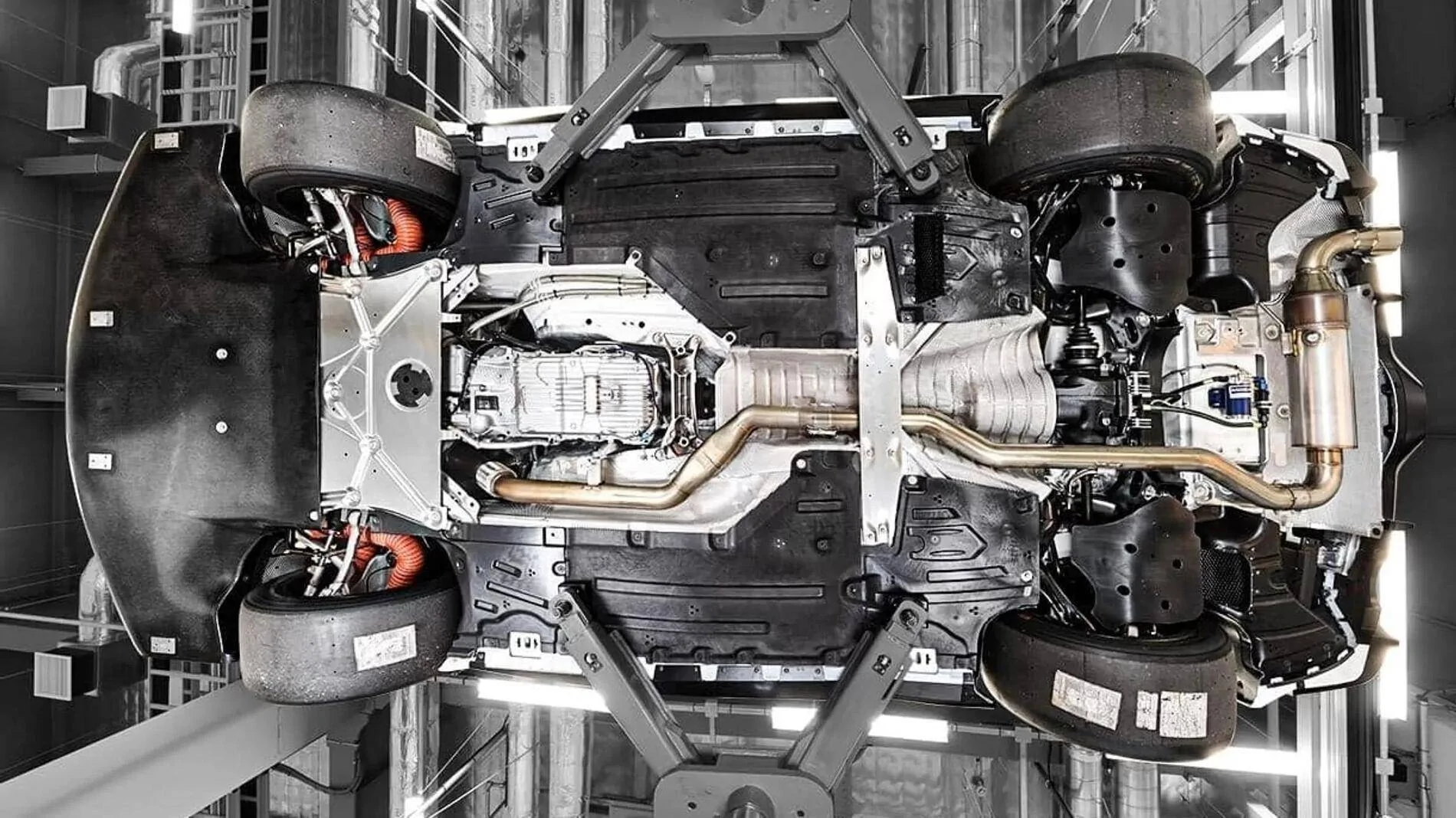

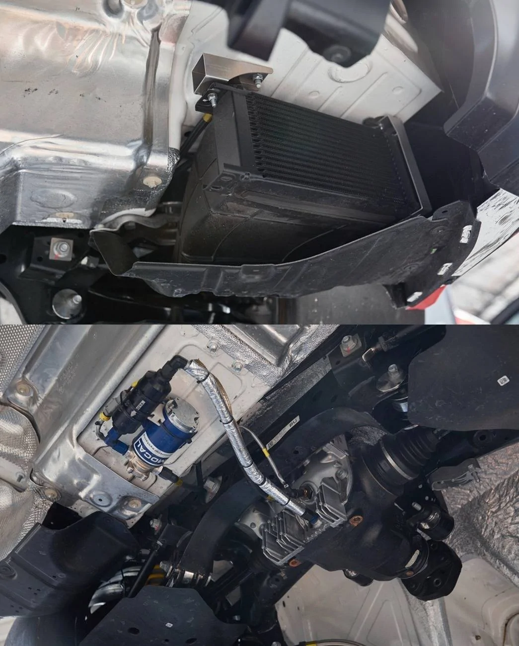

The Supra GT4 uses a pre chiller system based off the AC unit. That is how it gets away with the OEM intake manifold. Def not like the janky ass aftermarket systems I have seen though.
Ice box systems are different as it’s using passive cooling from… an ice box. It would last… maybe a lap at a short road course.
Again… it’s usually the guys that are the first to get triggered and nasty that are the most ignorant.
interesting about the GT4 version. I had heard of other actual race cars using AC for cooling like that, but not to that level. It’d be cool to find out how much cooling is needed via that system or if it’s a mixture of a more normal heat exchanger with the ac cooler being for supplemental needs. I’ll have to go read and see.
I would never suggest an ice box beyond drag racing. I’ve seen them used in all sorts of sprint style events and beyond the annoyance of carrying coolers around, being gridded next to someone who has one and keeps dumping water on the ground is pretty bad.
They add an additional cooler in the charge pipe as well. Delete one side aux radiator and use it for the condenser. External engine oil cooler under the car before the back left side wheel, and diff cooler on the other side.
