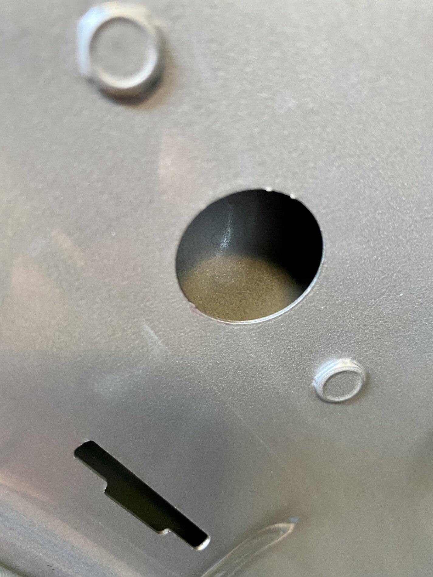

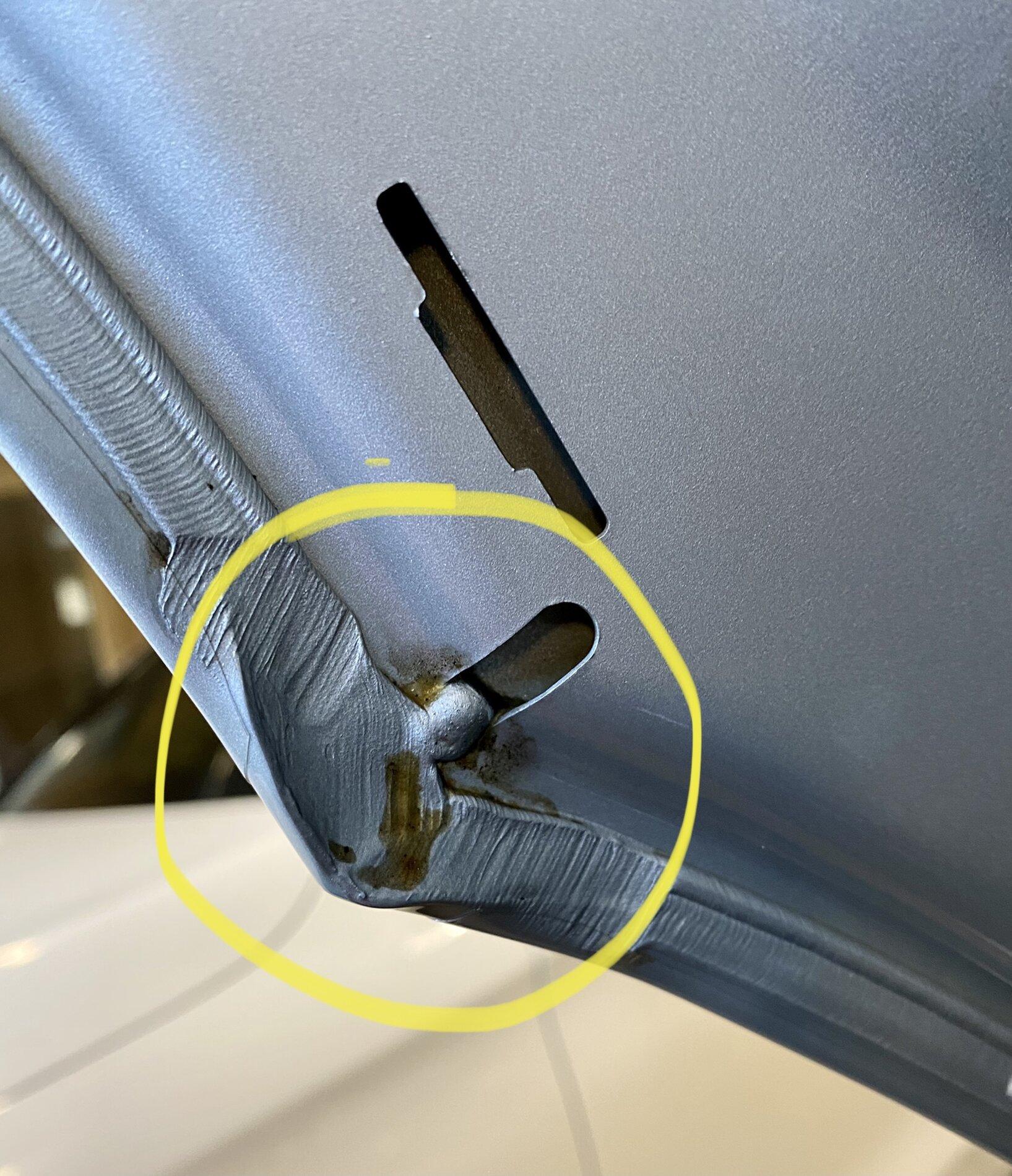

Yep, same thing on mine. Some IPA wipes cleaned it up pretty well but it took some scrubbing, I think it’s some kind of coating they spray inside the hood that starts to leak out the vent holes and then run down the inside of the hood to those corners.

You may be referencing the factory rust proofing or cosmoline seeping out of the lower door bottom or hood edge weep holes. This is an orangish color.

It's a corrosion inhibiter and it leaks out when it's hot... park it outside for a few 90 degree days, wipe away, and you shouldn't need to deal with it again.
