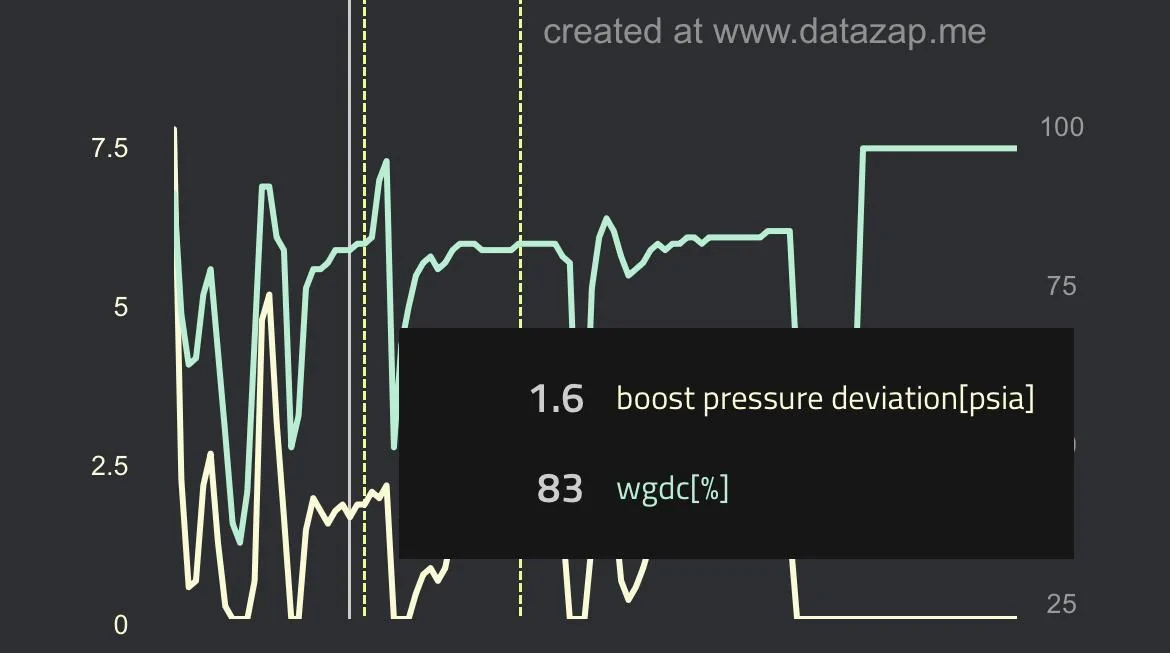

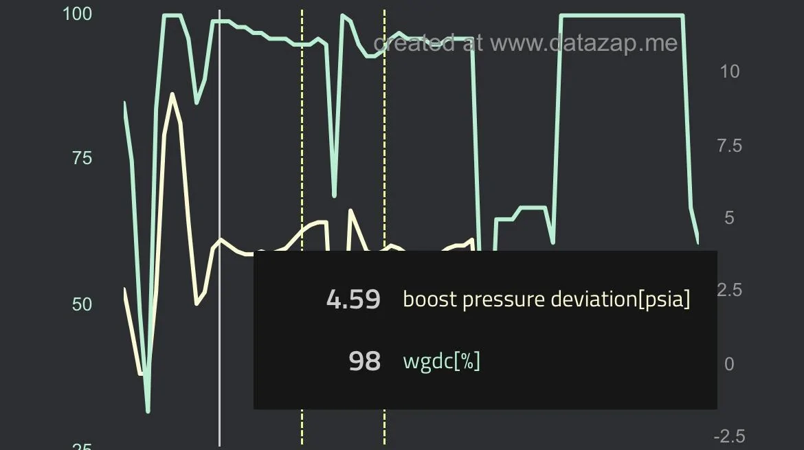

Fixed the boost leak I never knew I had. Explains the lower dyno #’s when I was on JB4/WMI and now BM3 OTS E50. Thanks to @zrk and @ColonelAdama for taking a look at my logs.
My dumba** never transferred the seal from the oem chargepipe that attaches to the turbo. ??‍♂
New log
Old log

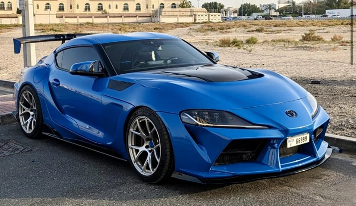

2021 Toyota Supra
Uhhh need stats on that kit. That front bumper makes the front look like a Gallardo. But, in a good way, and better. That front nose being more angular looks awesome. ??
Thank you so much!
Indeed the hood vents layout and the nose on the front bumper work really well ❤‍?
The front bumper is from Kuhl Racing JP, bonnet is from Varis, side skirt and rear bumper from Ings+ and wing from Voltex.

Goes insanely hard. How was the install for the front bumper?
Honestly, very easy and infact impressive. They used all OEM mounting points and also came with a steel number plate mount that is custom to the bumper. Did not require any trimming or shaving was as bolt on as it gets.
