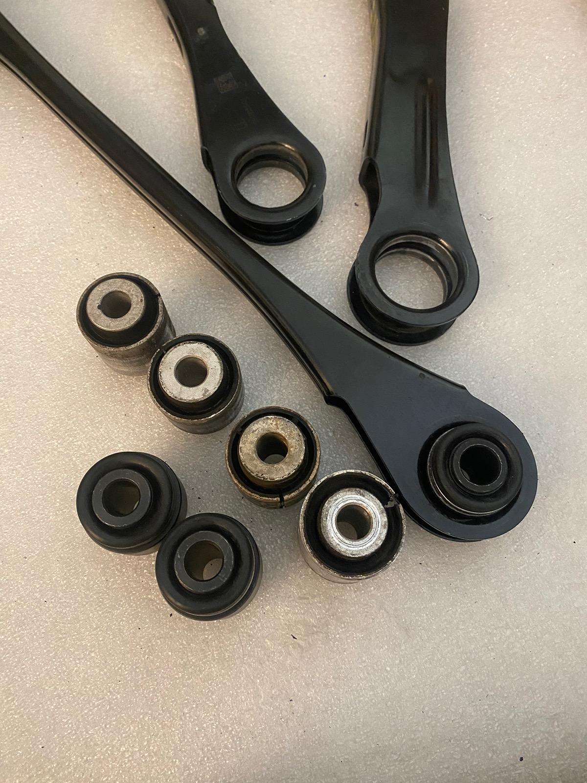

Been working on this project, figuring out which bushings I can find an oem monoball to fit in its place. Found 5 of 7 bushings can be replaced, the others will get a cup machined with a spherical bearing.

Are you going to share your findings?

If anyone is interested they can message me. They are direct replacement, you do need to run a misalignment sleeve/collar as the replacement monoball 14mm ID vs the oem bushing being a 12mm.

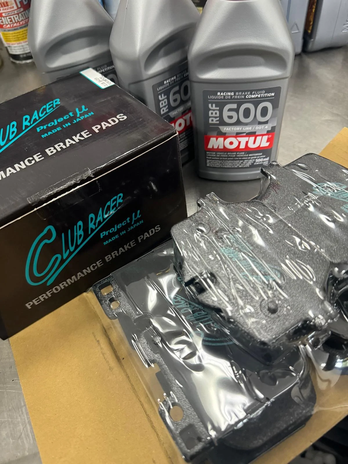

Whats the issue with it?
Phil
Needs to be maintenance bled a lot to keep a firm pedal. As soon as I (and others) moved to a different fluid it all went away. With Endless I can do 10+ days without any maintenance bleeding. With RBF I would need to do it after every track event to keep the pedal firm.

please don’t use that garbage brake fluid on your next flush.
Luckily that flush will be sooner than later when his pedal becomes spongy. ;)
Endless FTW
I give him 4 laps, maybe 5…..
awww great lmao.
Well, it's in there. Luckily i don't think i can get 4-5 laps out of my tires either.
if i order the fluid now i can probably have it by... maybe july.
