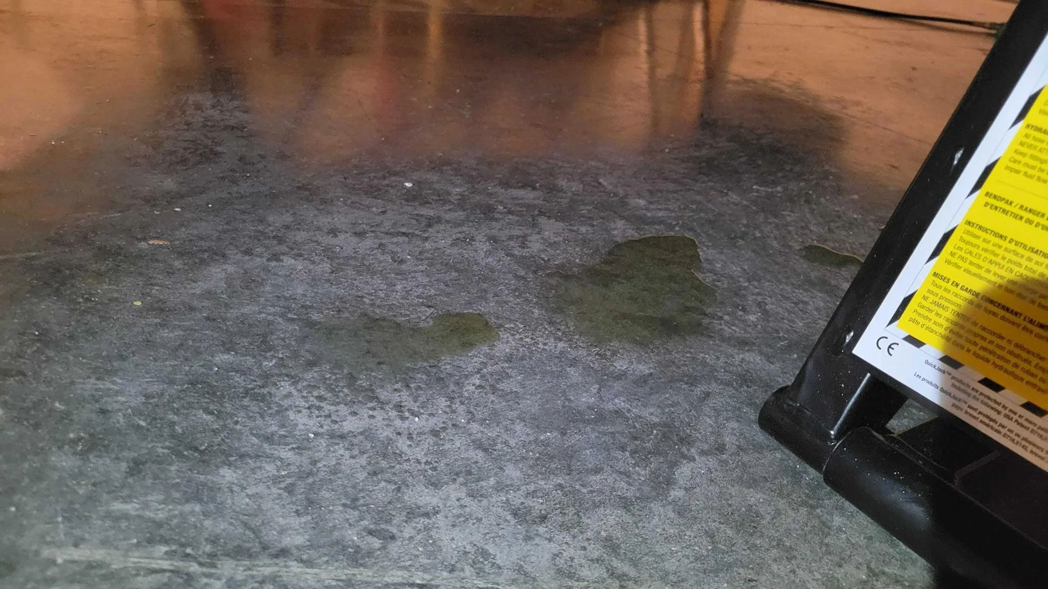

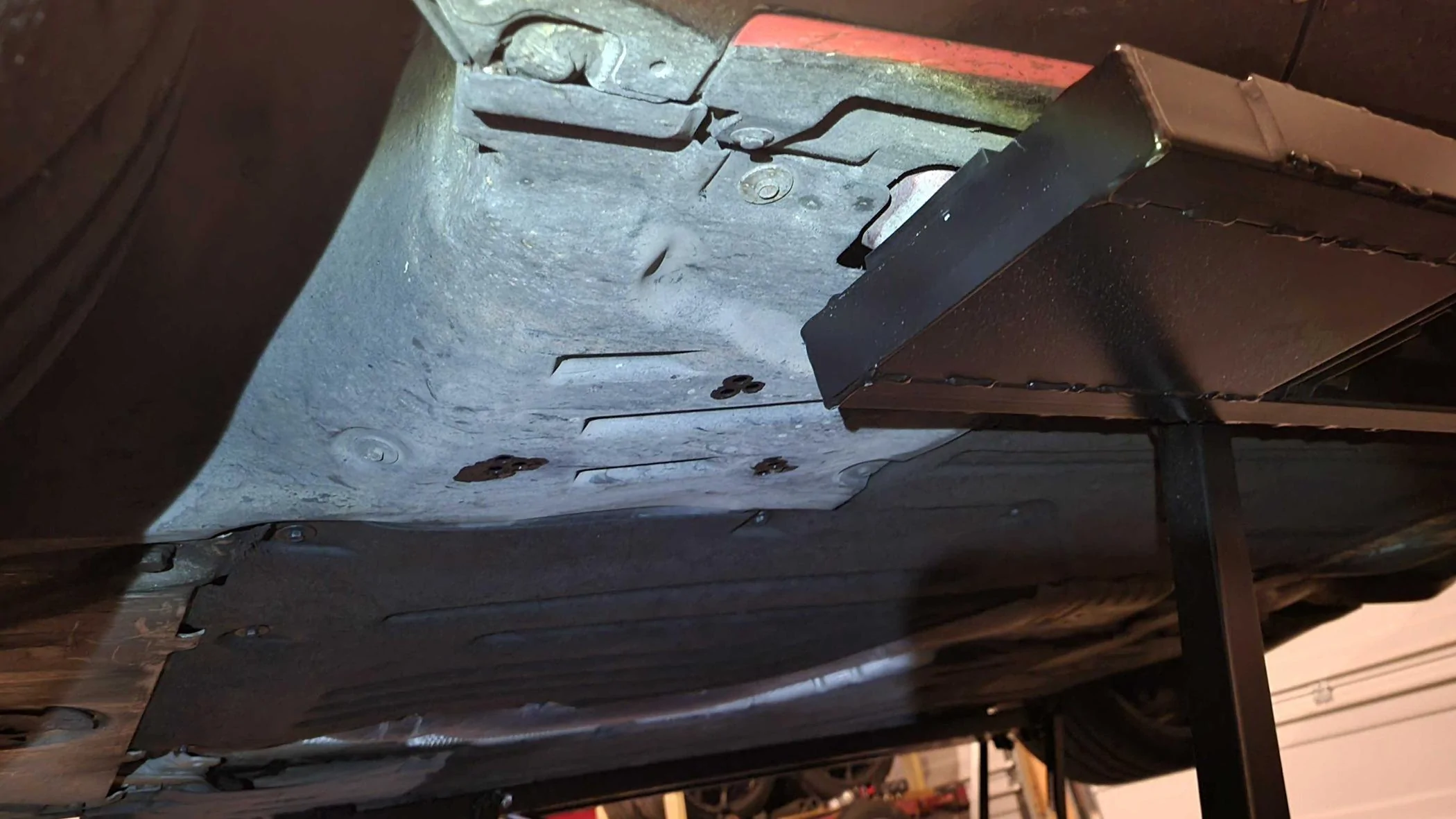

Changed out rotors and pads but noticed this leak. Anyone happen to know what I'm leaking? This right under the driver side farther back than the wheel well. It's dripping down through those triple dot holes. I'm trying to remove the cover to check it out in the meantime.

Update I'm pretty sure it's brake fluid. I opened the hood and the reservoir has fluid around it and it's overflowing. I'm assuming this is because I pushed the pistons back which caused it to overflow back up through the top to relieve pressure. Anything I should be cautious about since that happened?
Brake fluid doesn't like paint would be one. Dragging brakes another with an overfull reservoir.
Wash the car in that area right away to get rid of the brake fluid. Use soap and water the best you can and try and rinse in all the books and crannies around and below the brake master cylinder.

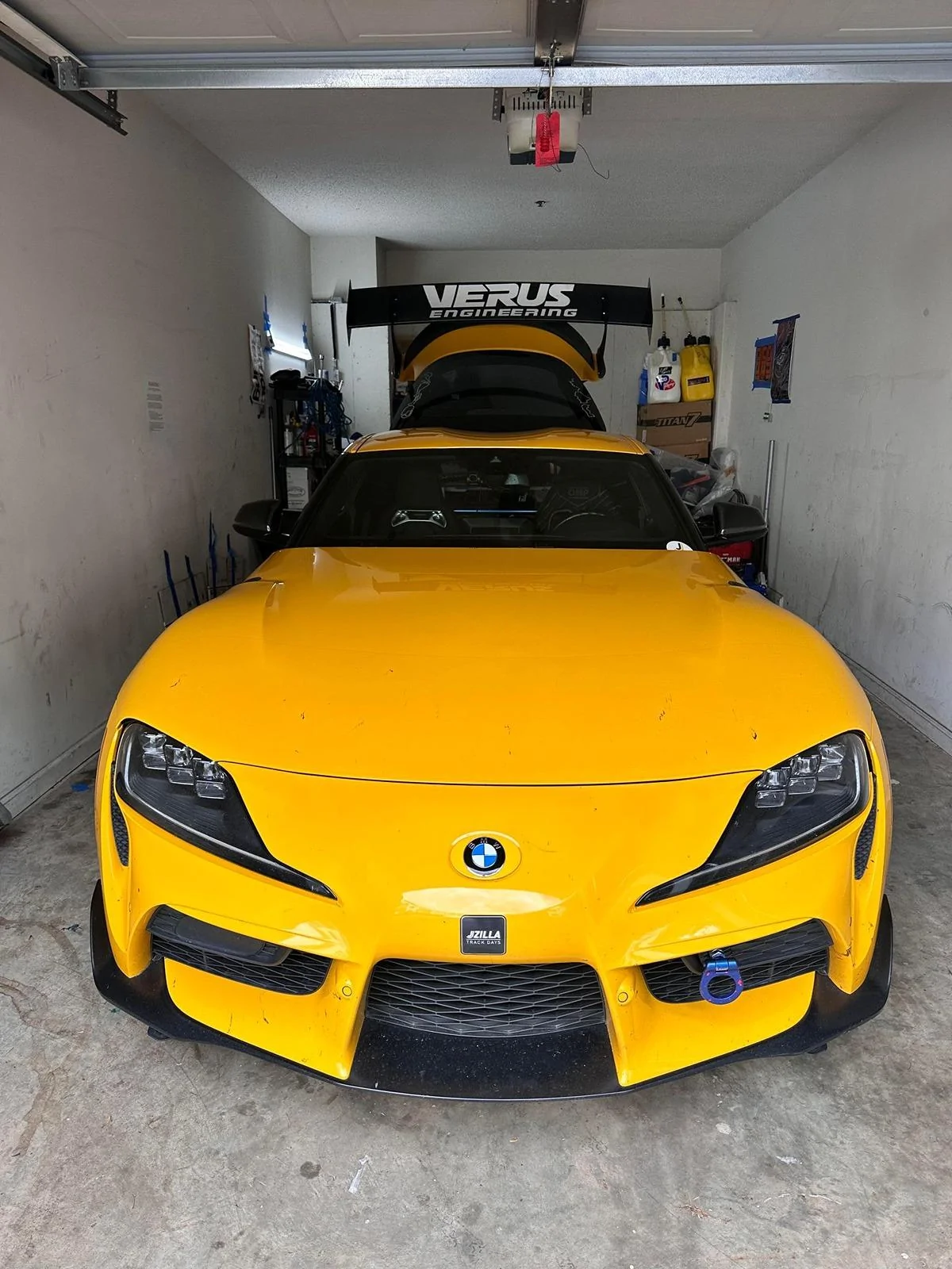

Installed verus aos and cusco front bar, cut up the Apr cooling plate to fit. And getting ready to install Adro front lip and some mismatched rear spats and side skirt.
