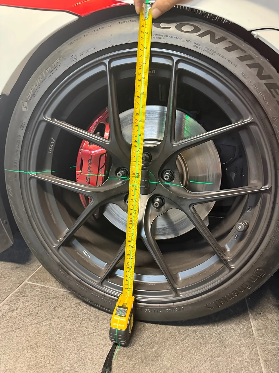

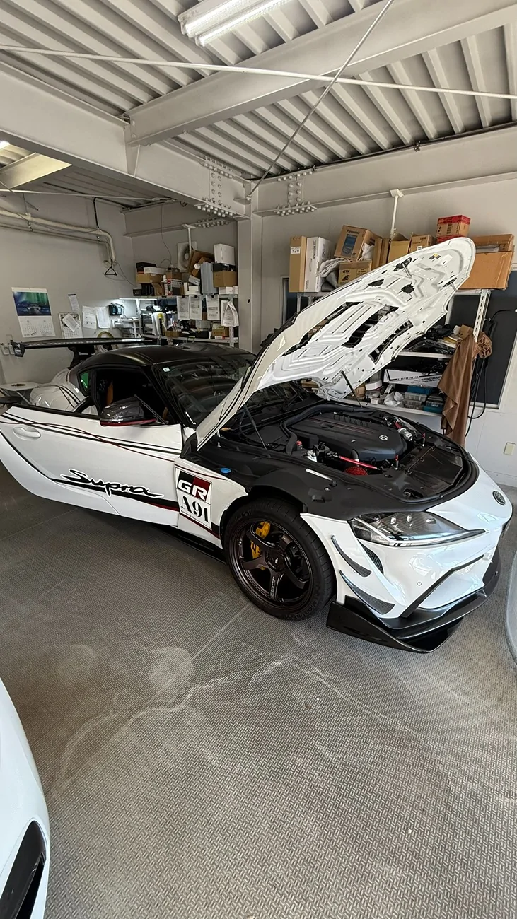

Measure from the center point of the wheel to the fender lip, that way your measurement doesn't change with tire diameter changes. If all you care about is ride height, then sure, do the above.
Your car is crazy low, I can't imagine the geo is having a good time.
8,801
17,265
I think that's what he's doing? I'm seeing 12.75-ish inches from fender to center cap.
The tape roll is just on the ground for convenience
Ah, that is what I get for not bothering to convert MM to IN. ;)
So his car is 1.75" lower than OEM in the front.

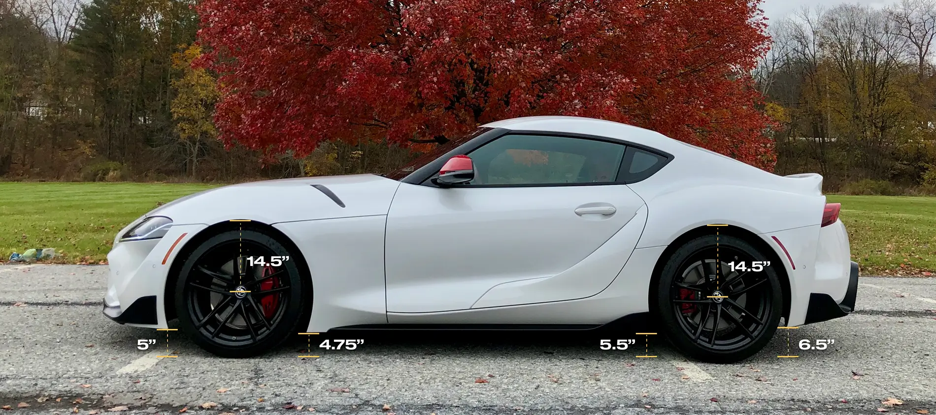

Yes. The car is too low. I wanted to have that specific floor height and rake, but I have been on 19 inch staggered wheels. It required a very short hub to fender lip distance.
Now I have a new set of 18 inch squared wheels. So The suspension has to go up in order to keep the same floor height. And it will go up to 13.25 inches (1.25 inches lower than OEM)on the front and about 14 inches in the rear (0.5 inches lower than OEM).
I will keep pretty much the same floor height and the same rake, but on 18 inch wheels.
Im already on adjustable links and arms. I will be adding the Coilovers and camber plates.
8,801
17,265
I have a set of 18 inch squared wheels. So The suspension has to go up in order to keep the same floor height. And it will go up to 13.25 inches (1.25 inches lower than OEM)on the front and about 14 inches in the rear (0.5 inches lower than OEM).
Wait, you are on OEM struts and that low? You must just be riding the bump stops everywhere. The car is going to feel like a superhero compared when you get coilovers.
Answering with a little shame: Yes.
