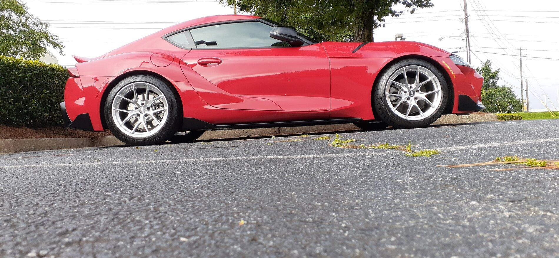

I dropped the car off on May 3rd to have Coilovers and Big Brake Kit added to the car. I was told that the Supra would be available for pickup on May 7th. I explained in detail that I wanted to NOT have any of the wheels tucking into the wheel well.
They did not reach out to me about any delays on the project. When May 7th arrived, I had to call them before close of business to be told that it would not be ready until Monday or Tuesday the next week. I waited until Wednesday without communication from them to have them let me know that the car would be ready on Friday. I had to call on Friday to have them tell me the car would be ready on Monday.

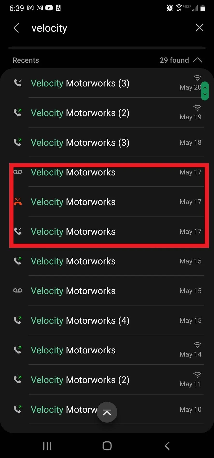

On Monday May 17th, I was told the car would be ready for pickup from the shop. My wife and I drove there to pick up the vehicle up. Unbeknownst to me (because I keep my phone on silent not to interrupt people during the day) they called my phone and left a message at 5:35 pm (after hours) that the car was not ready and that it was tripping a chassis code (later found from another mechanic that it was the car being too low). I then told my wife, who already left, that she needed to turn around and come pick me up. We live 25 miles away in Chatham County, so she was upset. The bad thing is that no one took the time to tell me that I was left a voice mail, so I walked around the shop with people looking at me like I had a third eye on my forehead. The owner then snapped at me in front of everyone saying that they had already called me and told me the car was not ready. Then I had to explain that I just checked my voicemail while I was there and did not know until I was there.
I ended being very apologetic and felt bad that people were staying late to try and figure out the chassis code issue. I felt super uncomfortable being there during the remainder of the night while waiting to see if the issue could be fixed. I ended up taking the car home with the chassis error persisting. This puts the Supra into a limp mode and locks all safety features and locks all sport features in disabled mode.
They ended up charging me about $1750 ($1950 after taxes) for Coilovers/BBK/Alignment. This price also included multiple ride height adjustments. It was never set to my specifications, but I just smiled and nodded because they were staying so late that night and I felt guilty. I was also told that there needed to be modifications on a bracket for the brakes which I was never consulted on until I arrived Monday.
I felt like I could have called the vendor to get some answers before the work was done. During this whole process not once did I have a coarse word with them or raise my voice. I remained jovial and laughing the entire time and paid what I owed them without complaints. I think the straw that broke the camel's back was coming home to see a pressure dent on my rear drive side quarter panel. Luckily Dent Dominator fixed this issue in less than 20 minutes, but it came out of my pocket. This is my fault since I did not inspect the car upon taking it into possession. Maybe I just caught them at a bad time while they were slammed with work. I do not know. I just know my experience was not what I thought it would be.

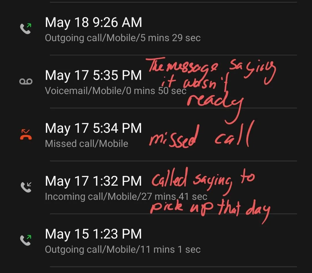

During the phone call, I was basically called a liar about the dates/times given. This was the first time I lost my cool when talking with them. The owner told me that I was wrong about all the timelines I posted. Which is not the case. I could hear an employee in the background who initially gave me all the dates trying to say that it he initially said 2 weeks and that he had called me at 1 that day to tell me the car was not ready. As I stated in my original review below, I called multiple times with the date continuing to be pushed back.
  • Delivered Vehicle May 3rd
  • The car had brakes and Coilovers done on May 6th. They provided this evidence with their timestamped promotional video.
  • Initial date of pickup: May 7th
  • Then: May 11th
  • Then: May 14th
  • Then: May 17th (Told that the car was not ready at 5:35pm when we were 5 minutes away from the shop after driving from Chatham County)
I understand that this type of work has variables, part acquisition was not one of those since I supplied them with everything. I NEVER got a phone call from them when the timeline got pushed back. I WAS THE ONE calling them trying to understand why no one was calling me when those dates went by without any notifications. The only times I got a phone call about pickup was on May 17th.

I included the call log of the 17th below and I referenced the specified dates as to when the car would be ready from my Outlook calendar.

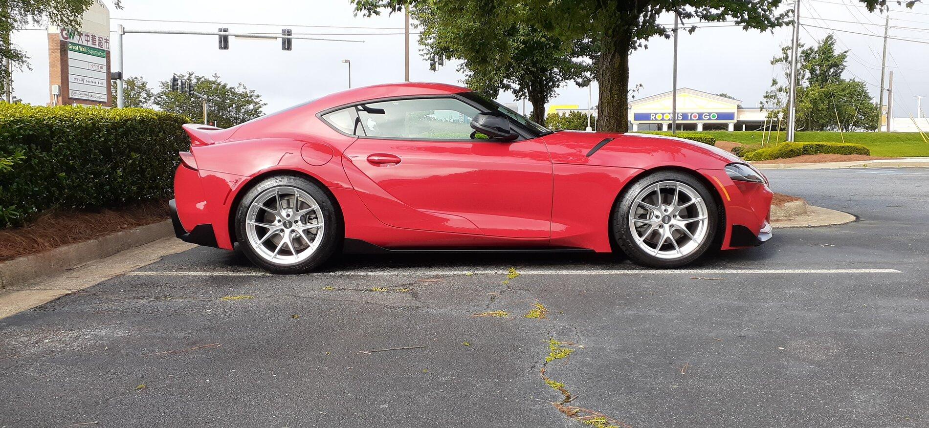

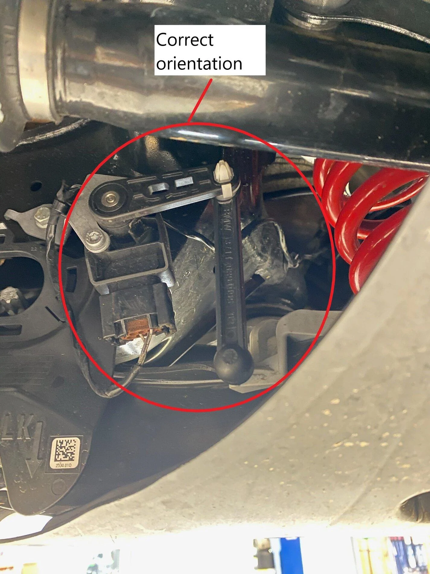

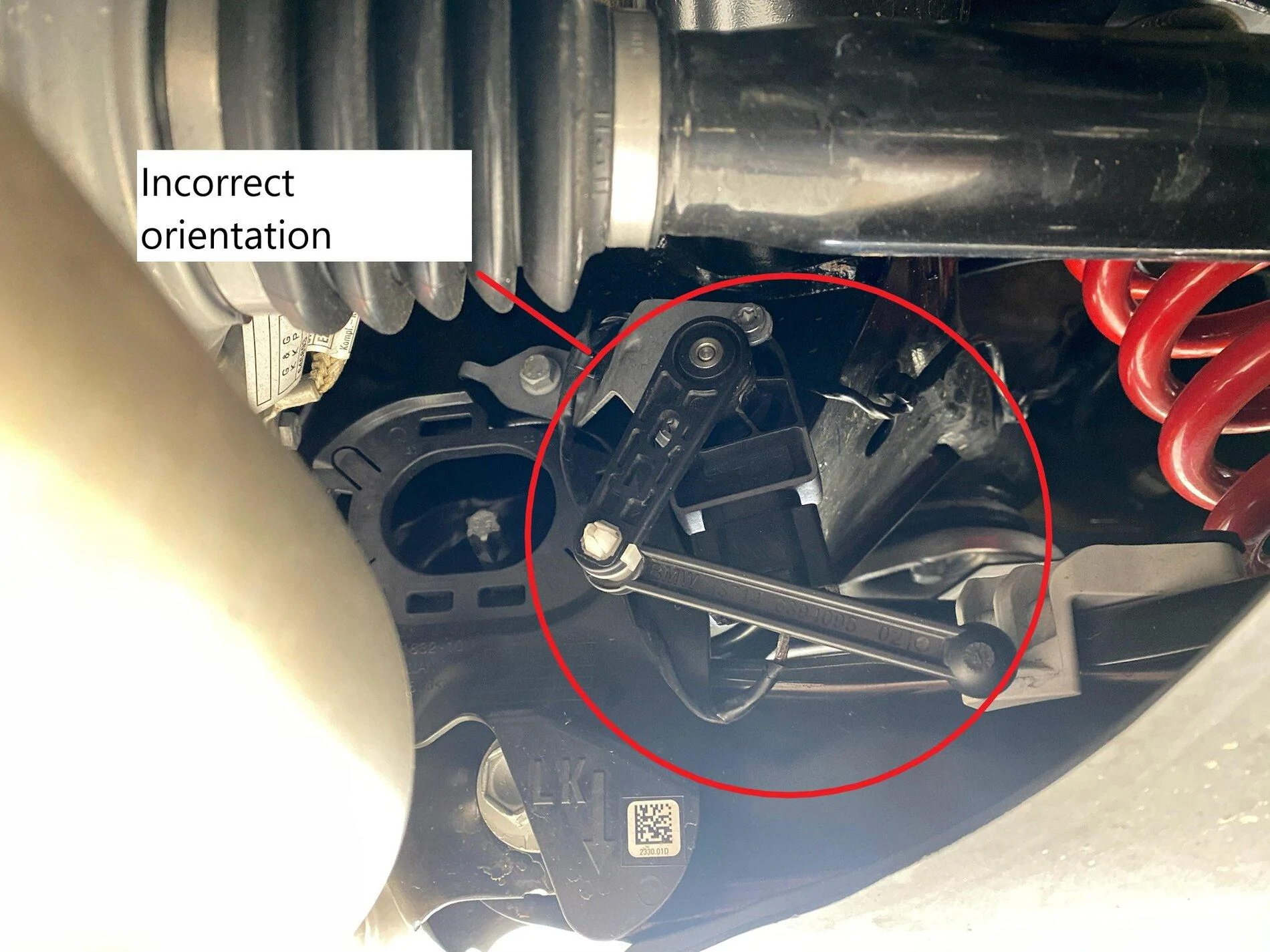

I went to another mechanic in my area, Tioga over at Automotive Solutions, and he was able to diagnose everything wrong with the car. The rattling from the rear suspension was from loose hardware on BOTH struts. The chassis/ride height error was from them re-installing the ride height sensor arm on backwards:
My car had the parts installed in about 2 days, but they did not give me my vehicle back for 15 days because they "couldn't get it aligned yet."
Velocity Motorworks spent 4 hour trying to solve the chassis error with their scanner and didn't even have the car in diagnostics mode.
It took Tioga 15 minutes to figure this out AND fix it. He's a master of his craft.
I also had the dent repaired by Ken over at Dent Dominator in Raleigh. He's a magician and worth every penny. It was very therapeutic. Him and his wife were very attentive! They also gave me cookies and coffee:D.
In the end, the car drives and looks great again.
