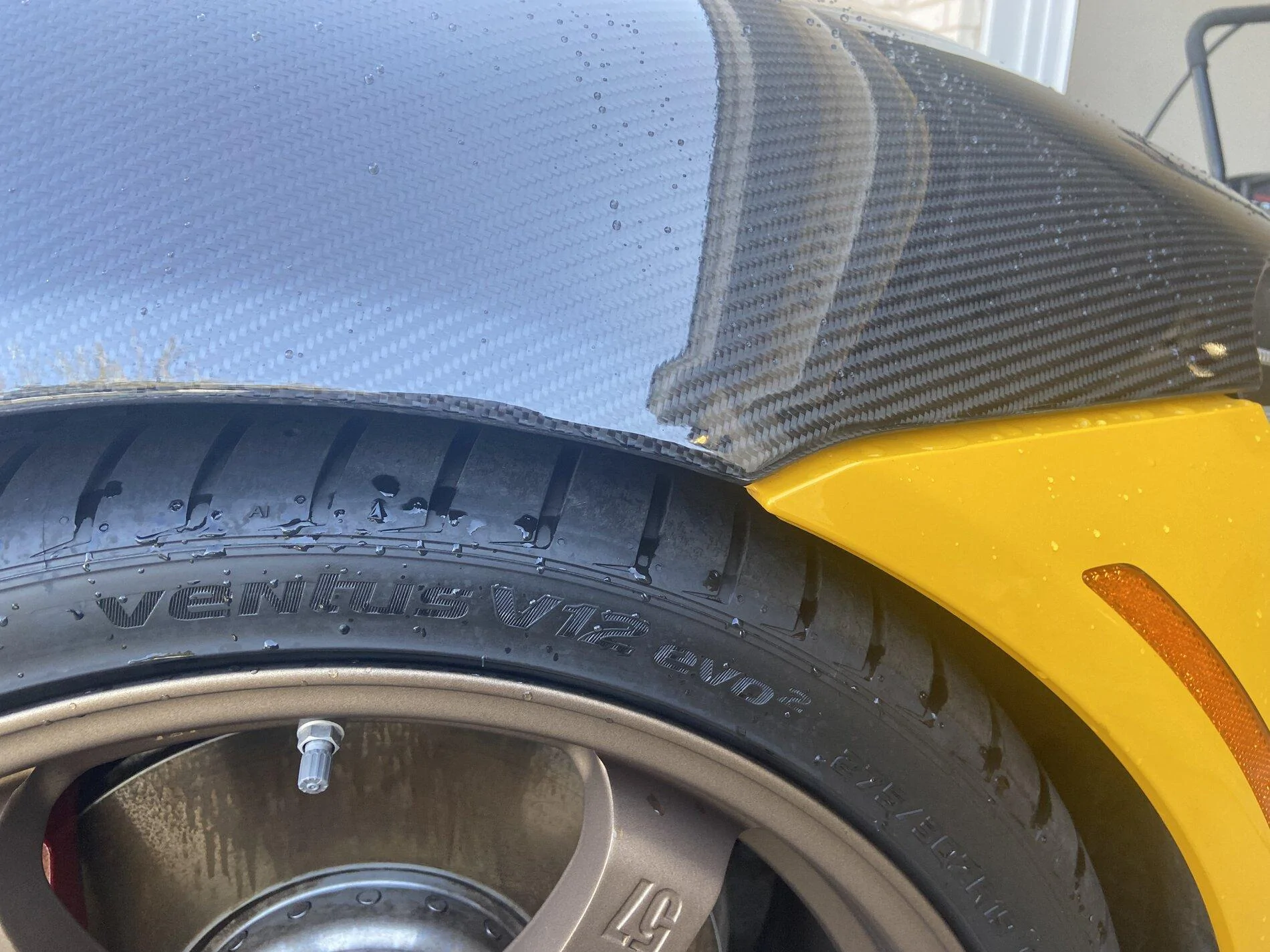

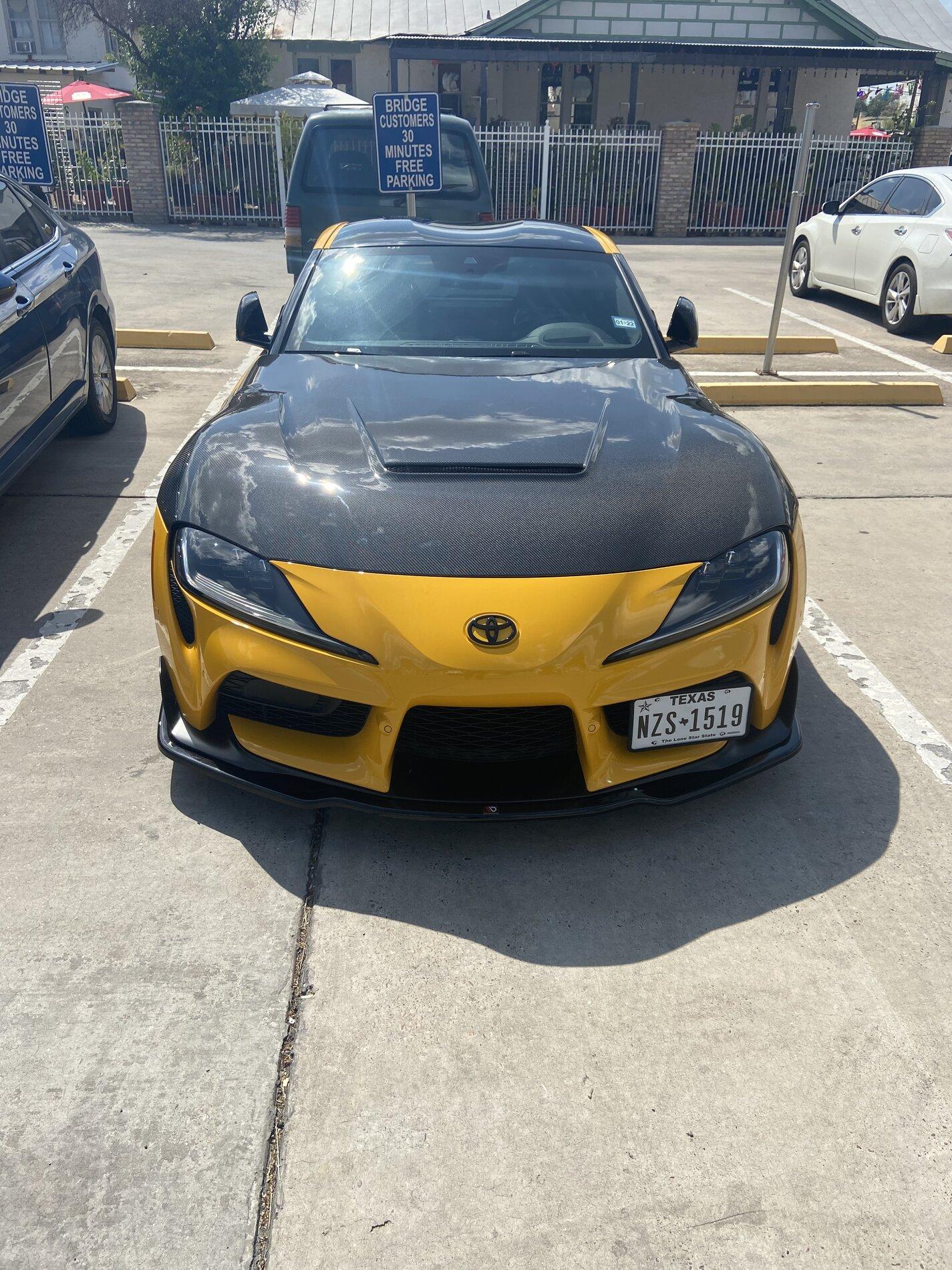

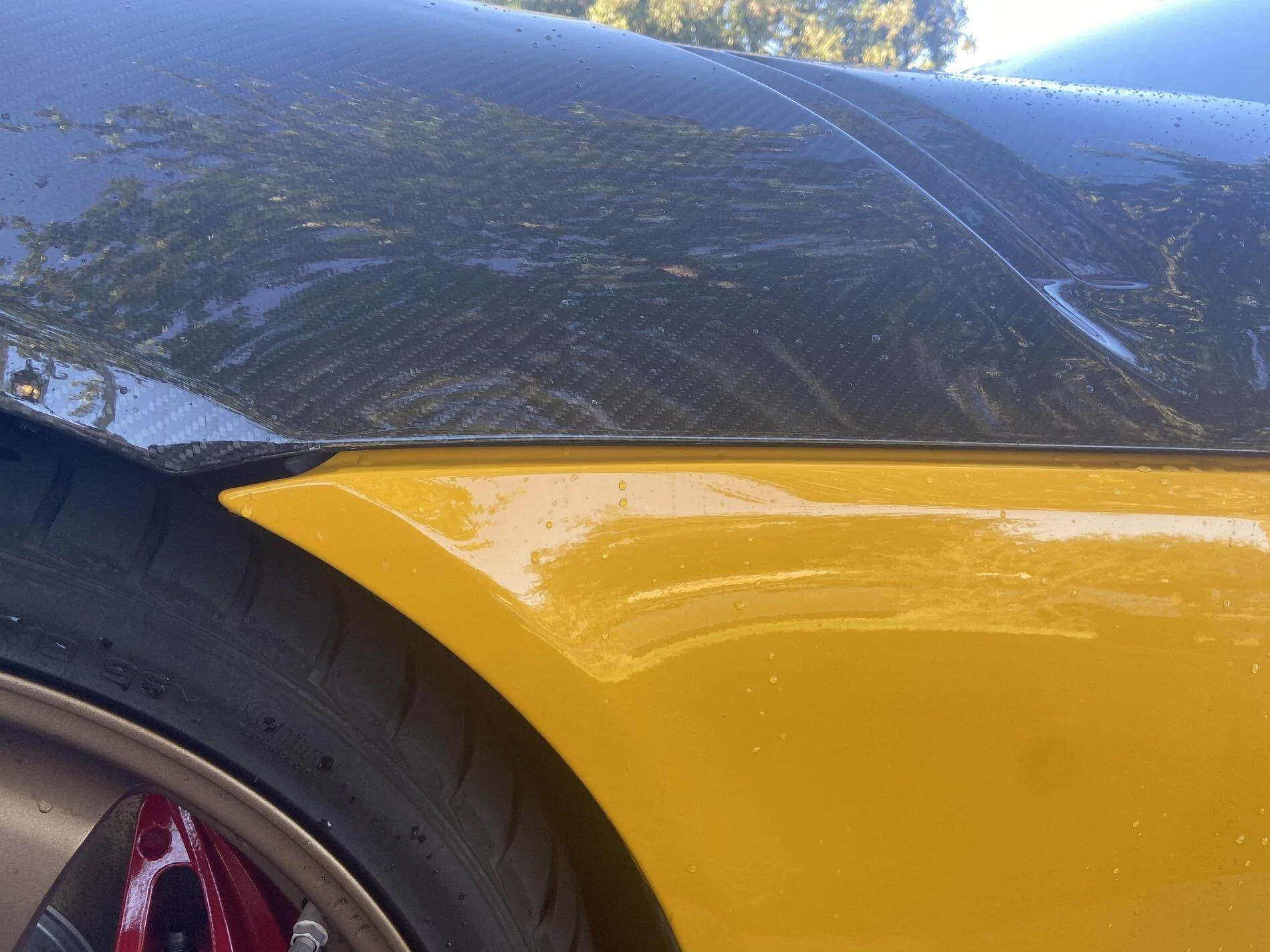

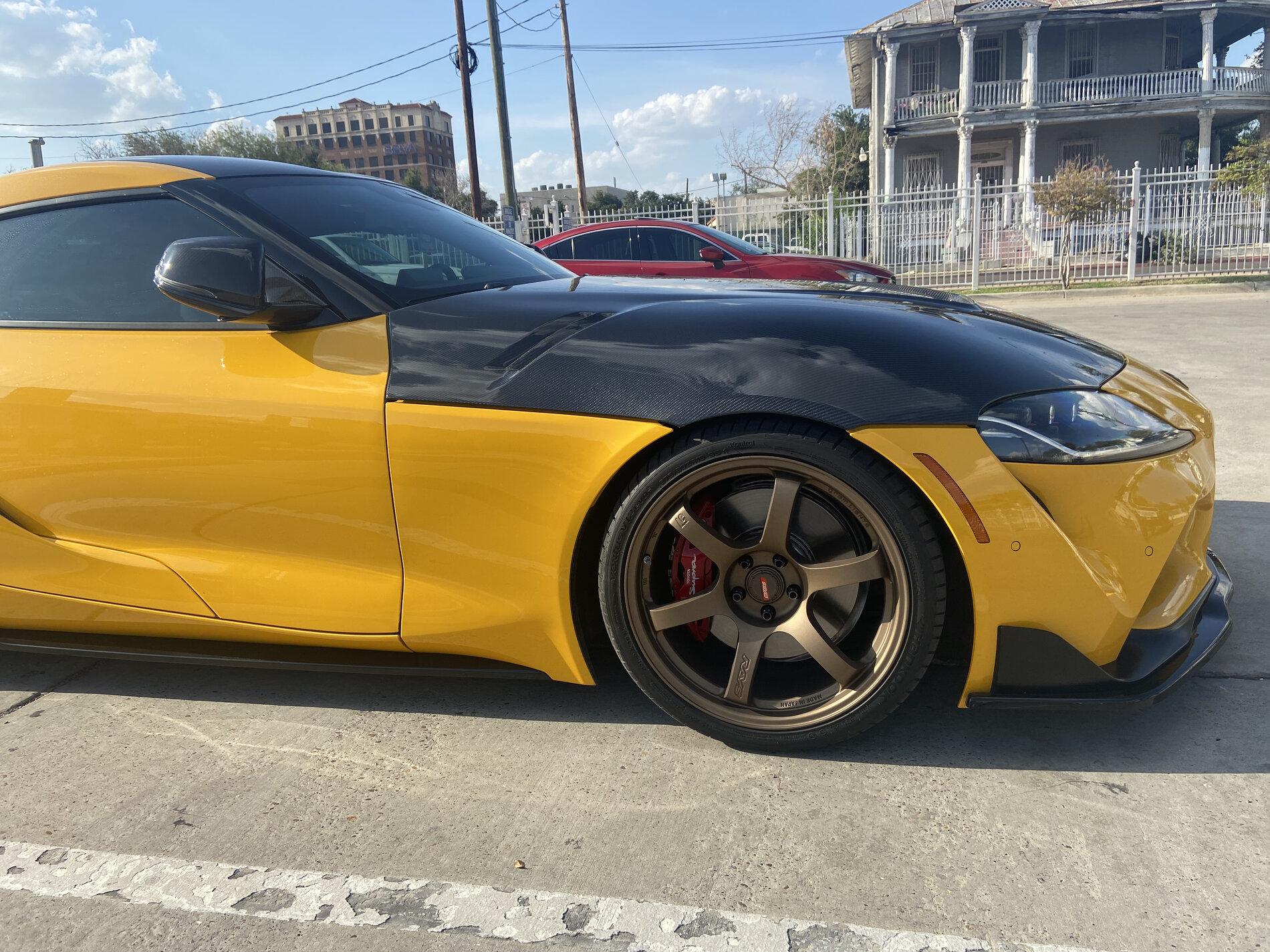

hey new to the group so i guess i put up photos of mines nitro yellow supra with pure 800 and flex fuel, tuned by payne. I’m currently having an issue with the new carbon hood where it flexes a quite a bit when at high speeds. i have adjusted the hood and it still does it.
Would you mind elaborating on the hood? I've been one click away from ordering a seibon hood for some time now but this doesn't sound great..

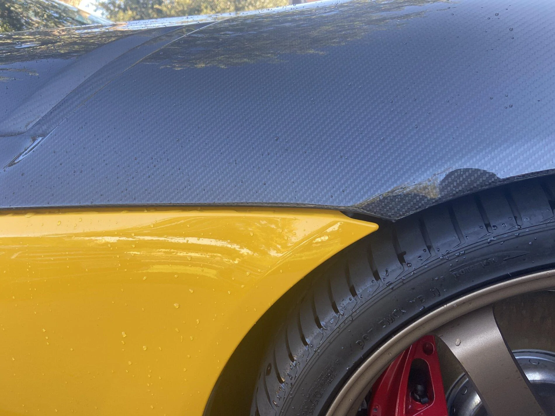

there’s a gap the causes wind to go before hood and fender

The stock hood also has a gap all the way around, posing as a body line. The real issue is that CF hoods are incredibly lightweight compared to a stock hood, and can turn into an aerofoil at speed. At best, this will cause the hood to flex and distort at speed. Worst case: the hood can catch so much upward force that it overpowers the hood latch and smashes into the windshield.
All CF hoods should be installed with hood pins or AeroCatch. Your hood is flexing because you have not yet installed the correct safety mechanisms to reliably run a CF hood.
Seibon also says on the product page for every Supra carbon hood that hood pins are required
just ordered the pins thanks, i’ve had/have many performance cars but this is the first on that i’ve ever put a carbon hood on
