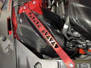

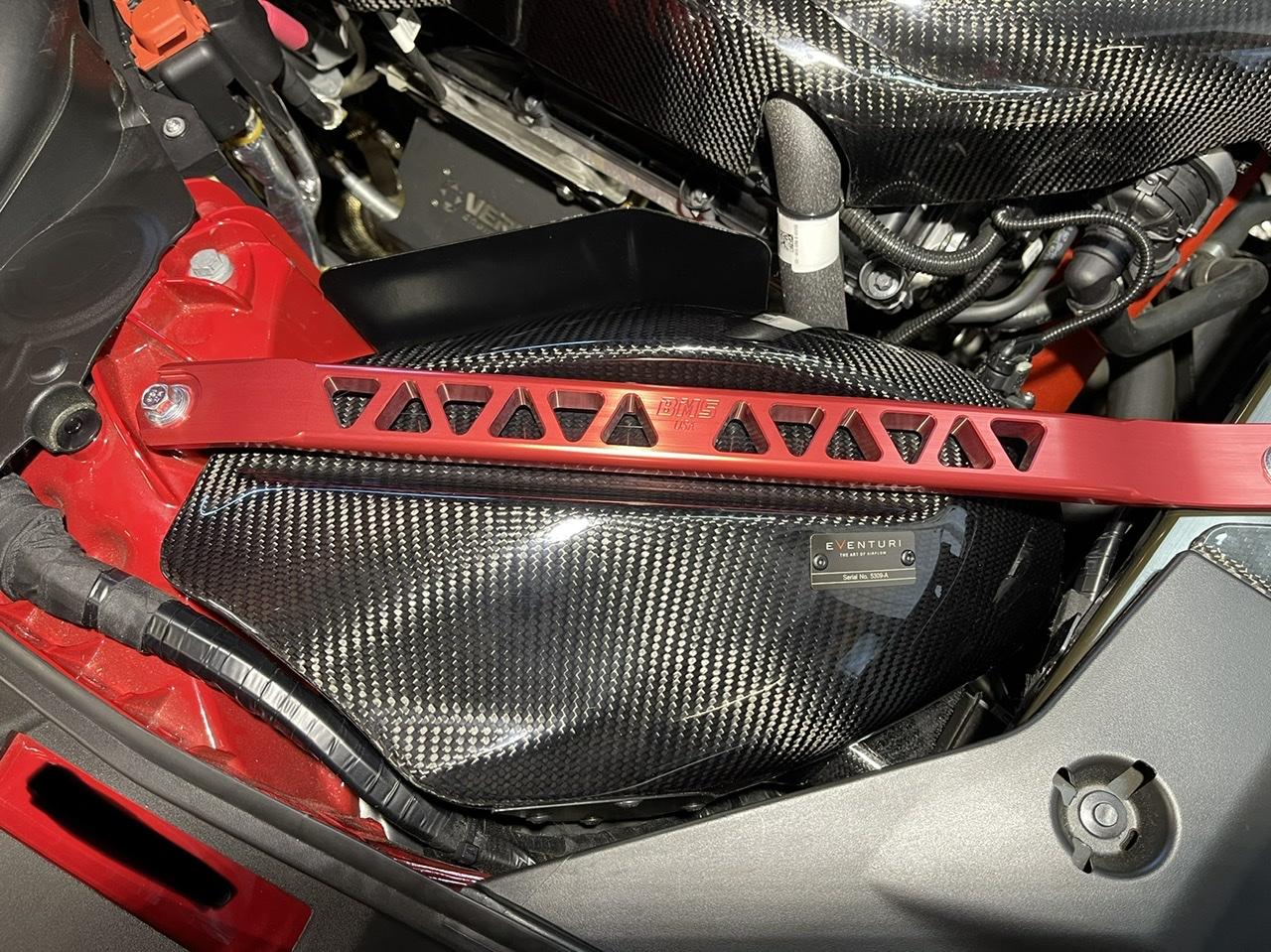

Installed the Eventuri carbon intake today. My Armaspeed intake is posted for sale for anyone looking for an awesome intake.

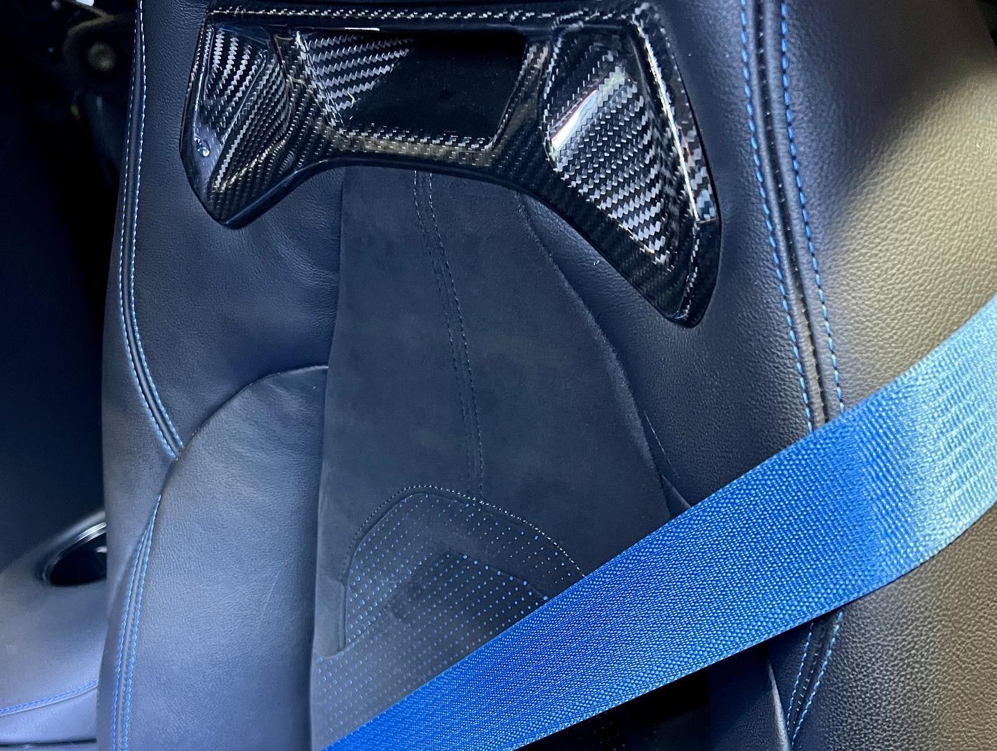

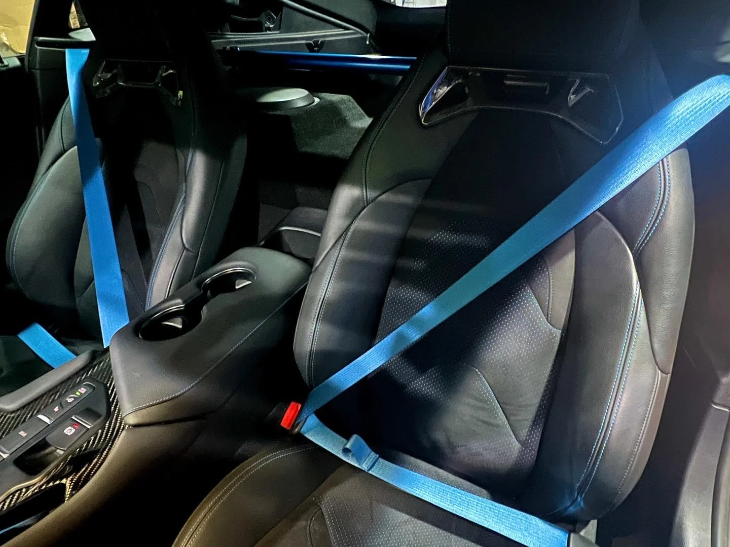

Seat belts. Missed opportunity for Toyota I think.
Where did you order them from? BMW Dealership? If so, what was the P/N. I've been thinking the same thing myself!

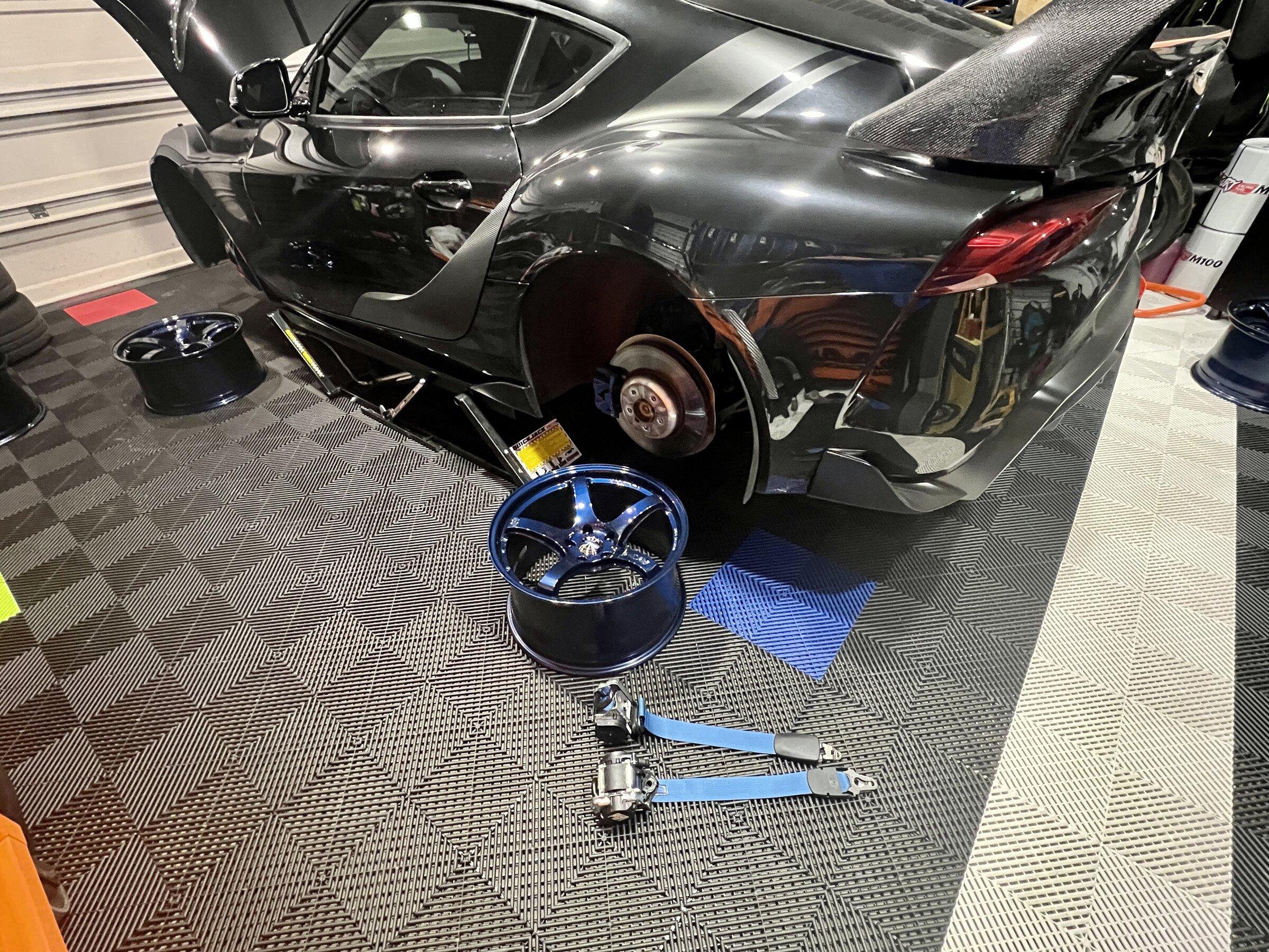

Damn, you had to take the tires off the wheels to install the seat belts!? Not doin that one myself.
Maybe he was test fitting his wheels too? I would be baffled if you had to remove the wheels to install the seatbelts but from factory, wheels is one of the things that go on last so it could be possible.
Lol, waiting on TPMS for the new rims, not related. I had the factory seatbelts sent off for rewebbing. No part number, sorry.

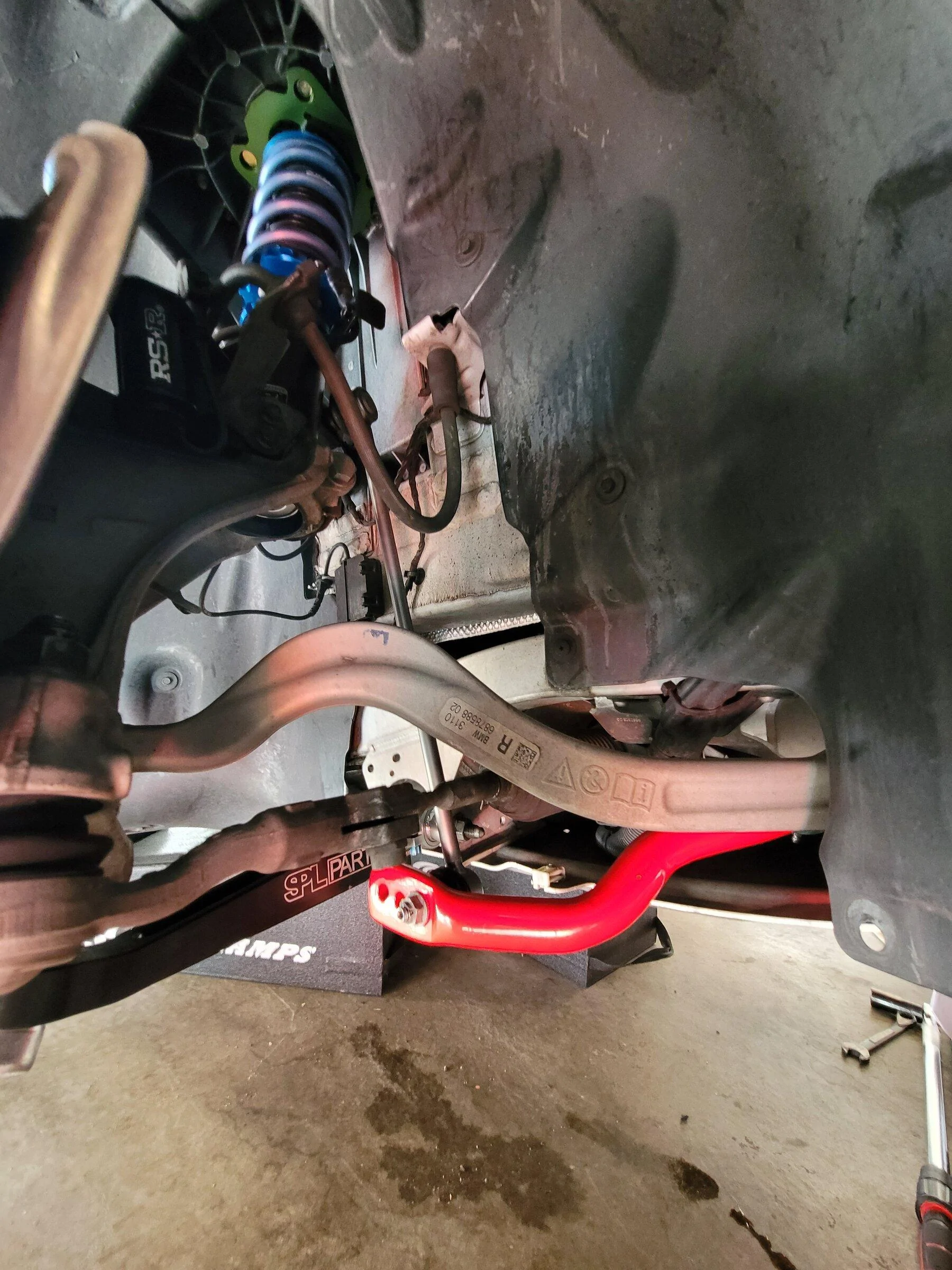

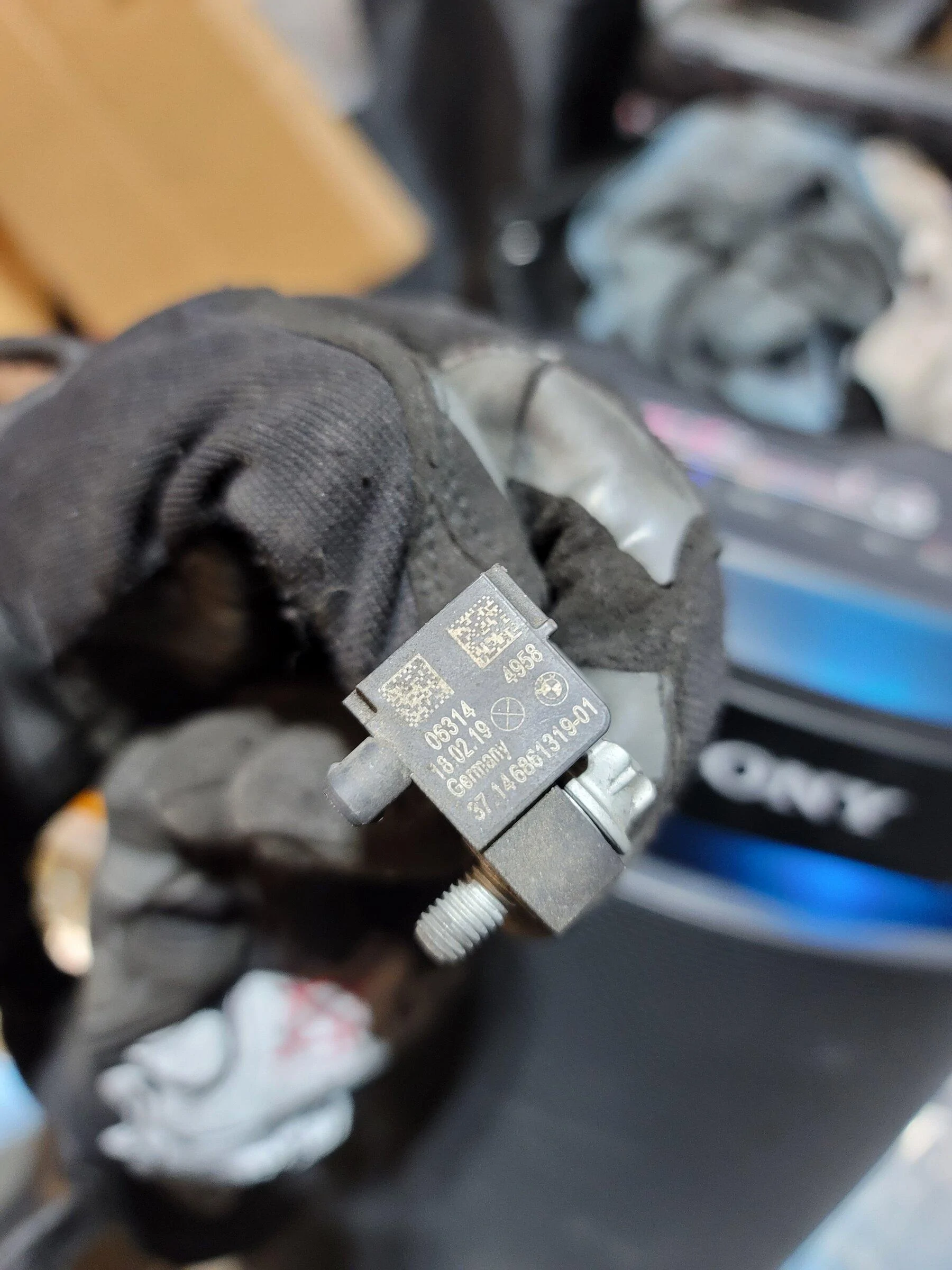

Fought with the car some more. Parts are all installed and ride height where I want it, but still getting a chassis error. Both sensors intact and as far as I can tell, not damaged. Tried two new sets of RSR cancelers as well.
for what its worth i also am running fortune auto coils with rsr cancelers, about once a month or every other month i get a chassis error for a day and then it goes away. every time i go to check it with my scan tool code is gone, i honestly gave up ? yours sounds more permanent though, did you do spl lca's same time as coils? both sensor brackets front and rear hooked up?

Found my problem, and it's my fault really for overlooking it. Didn't move the other little sensors from the stock front struts onto the new ones. Couldn't find any info on those damn things anywhere, was talking with Jackie Ding about it and they're apparently damper stroke sensors. P/N on it shows it as an acceleration sensor for the 430i and I couldn't find much else for a Toyota P/N on them. All I know is they're on the car now and the chassis error is gone.
Was also told that their orientation matters too so may be worth looking into if you're having intermittent issues.
