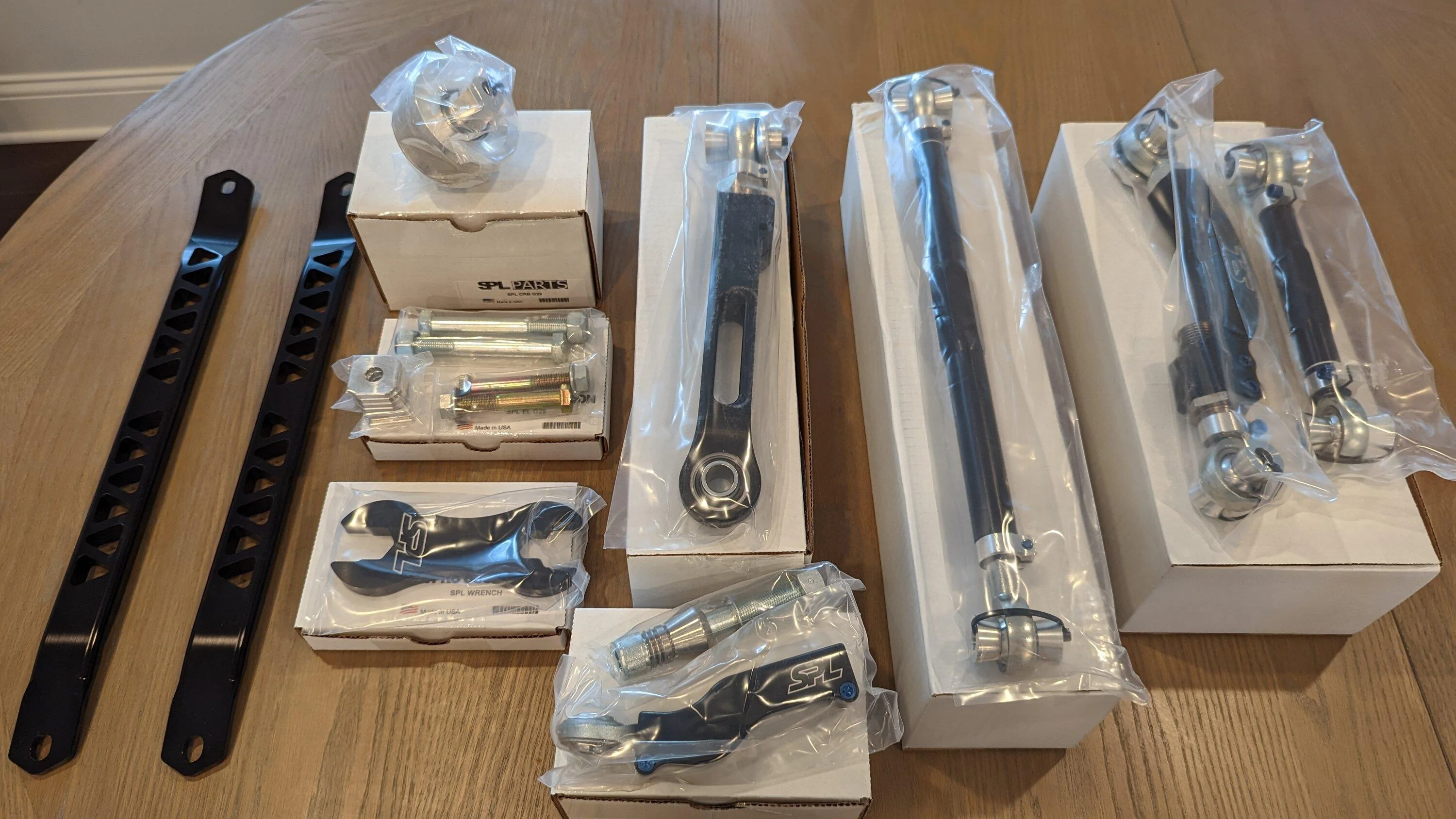

I received another round of parts yesterday! I now have all of the SPL parts to be installed with the exception of the traction links, which are already on the car. The middle of next month feels so far away now with an office full of car parts, just taunting me while I sit on conference calls all day.

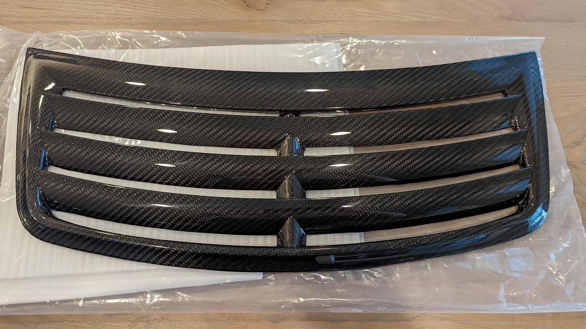

I decided to move to the the Burger Motorsports braces (black bars on the left above) from the Cusco brace under the hood to keep the path clear for the below (purchased over the summer). It appears that the cross brace on the Cusco bars, and bars like it, sit directly below the louver. It's probably not an issue, but it would bother me for sure.

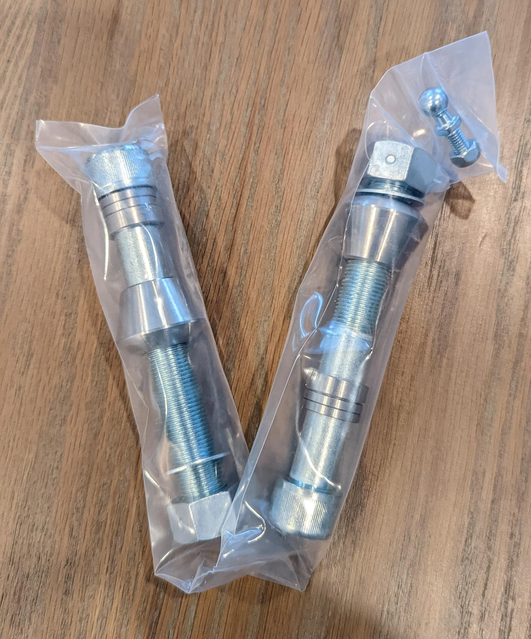

So, my 4yo got into the parts while they were sitting out while taking these pictures, and he removed these from one of the boxes. I do not, however, know which box it was taken from. ? Does anyone know which SPL component the below belongs to?
LCAs

It's one of the rear upper arms, for some stupid reason Toyota put the bolt in the "wrong" direction, so it hits the body of the car when you try to pull it out, forcing you to drop the subframe to remove it. When swapping out the arm it's a good idea (and is suggested in the SPL install docs) to insert the bolt the other direction so that it can be removed in the future without dropping the subframe again.
