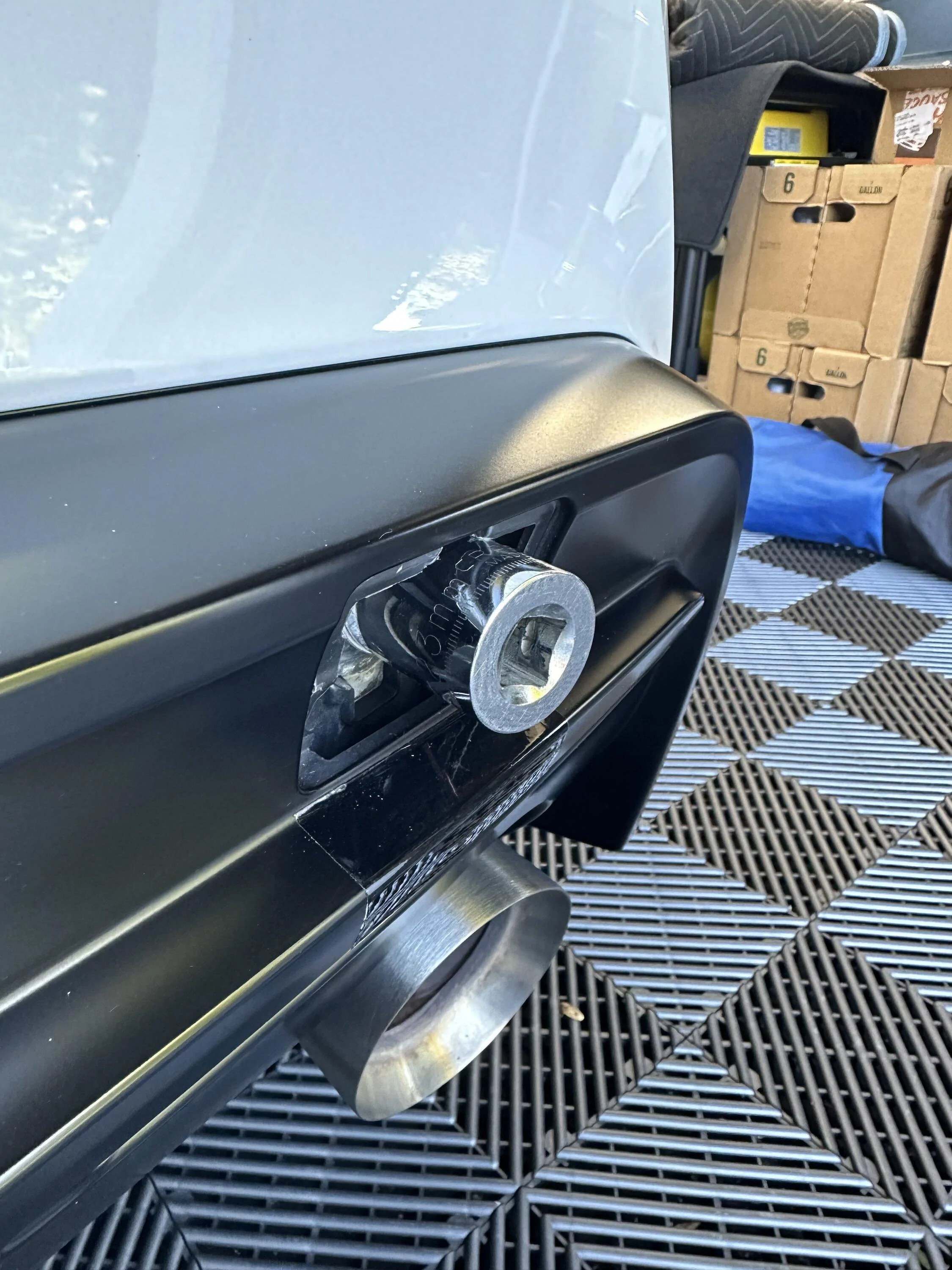

Did this last week. I've been working on cars for 30+ years and still manage to do stupid shit sometimes...
Somehow I got a socket literally stuck to the car when trying to reinstall my rear cusco tow-hook. All it does is spin and I can't pull it off. lmao
Silver lining is it made a great place to mount my external microphone. lol
I guess I have another project for this winter. Getting this F'in thing off.

Dude you can start a new trend!
