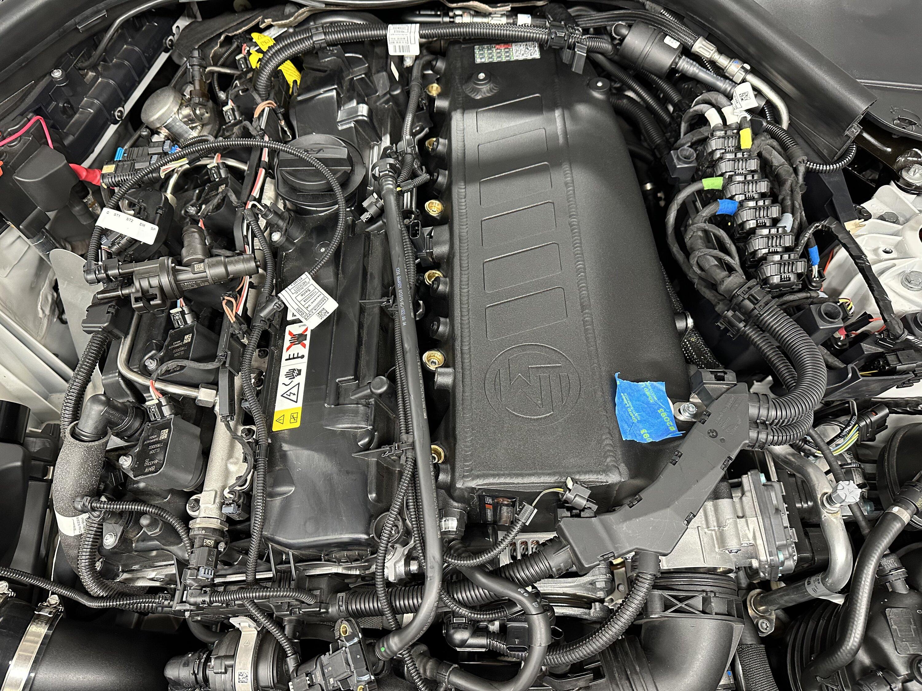

Which manifold did you install? Any tips you found? I’ll be installing the EOS next weekend most likely, and I found their instructions severely lacking. AMS’s instructions are pretty decent, and Kies has a really nice install video for the CSF. I suspect between them I can figure it all out, I just hate getting halfway into a big install and then running into an unexpected roadblock.

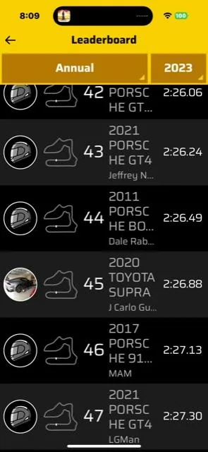

Are you doing this for tracking? It’s hot as balls down here this weekend at Sebring. Only once did I experience some sort of “lag”. But we can all tell as the day goes on, our cars definitely feel the heat. It’s not just Supras. We’re all having our best times in the morning when it’s 10 degrees cooler.
No mods, super fast Carlo will be driving today. Will be curious how he does in the 90+ heat (over 100 on track). This holy grail EOS manifold came up yesterday in conversation. No haters down here in Florida. Let us know how she does on track afterwards. Some kids will continue to track the next 6 months and the EOS manny may be worth every penny for hot as hades tracking.
Edit: never mind, he did fine ? and so did I. I’m just lower down on the page at 2:28.08 ?

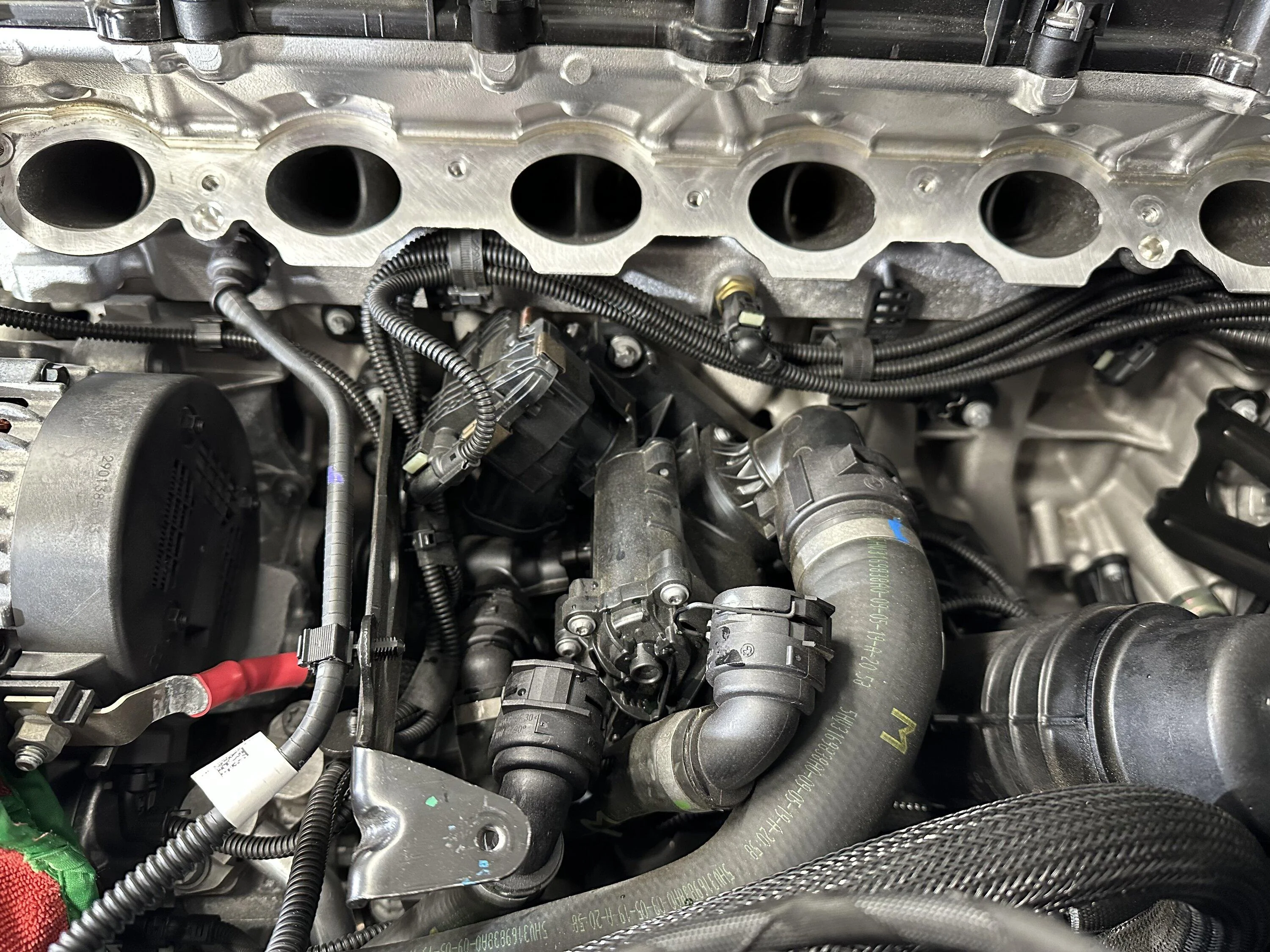

Find someone with small hands and skinny arms. Make sure you have long pick tools and a long flathead screwdriver helps to pry the coolant connections off the oem manifold.
Everything but the coolant connections are super easy on the oem manifold.
Installing the aftermarket manifold is a pain in the ass since it’s much larger and there is like zero space because of it.
