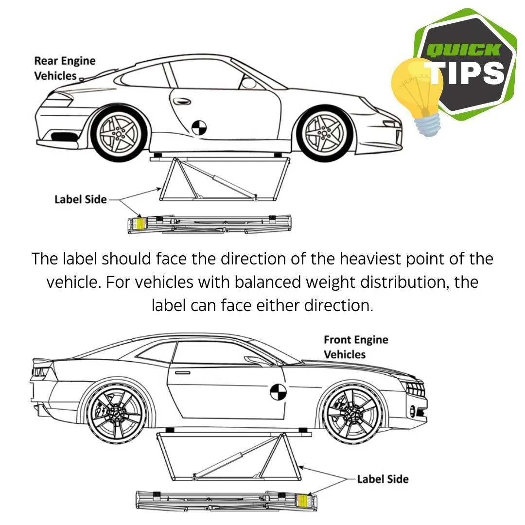

As long as the lock is on the outside, what does it matter?
Sticker is always supposed to be closer to the engine/heavier side of the car.
Honestly it doesn't matter that much to us (probably more of a concern with trucks and other vehicles with significantly different weight distribution)

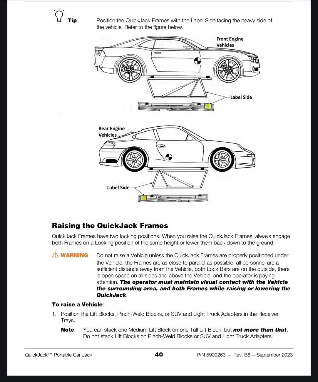

Not trying to be an ass. Honest curiosity. I can’t find any reference to this in my manual. Just says in like 5 places, in bold, that the locks must be outside. Now, when I use mine for my Daughter’s truck, using common sense I place them as far forward as possible since the center of gravity is closer to the front.

It does say it in there I read it this morning after it was pointed out.

Lol, I actually can't seem to find it in my manual, though I'm not sure mine is the latest version.
This is from Quickjack themselves though via their Facebook page

Page 40 of the manual.
Still not seeing it. Re-read p 39-41. My version is J5 (Jan 2020). Also pulled up on QuickJack site, version Oct 2021, which is the same as my version on those pages…
That works. It’s funny, I set mine up this way anyhow. Not for any reason than that’s how it was the first time and I just keep doing it that way!
This is right from the one you can download from there site.
?. Mystery solved. It’s not in the older versions. And no idea why the older 2021 version came up when I went to their site.

I’d say common sense would tell you not to have the heavier end balancing on a fulcrum while it’s being raised, and thus 50/50 weight would mean it didn’t matter. But agree fully with safety catches on the outside. I’ve seen it the other way and it makes me wonder how they’ve managed to live as long as they have.
