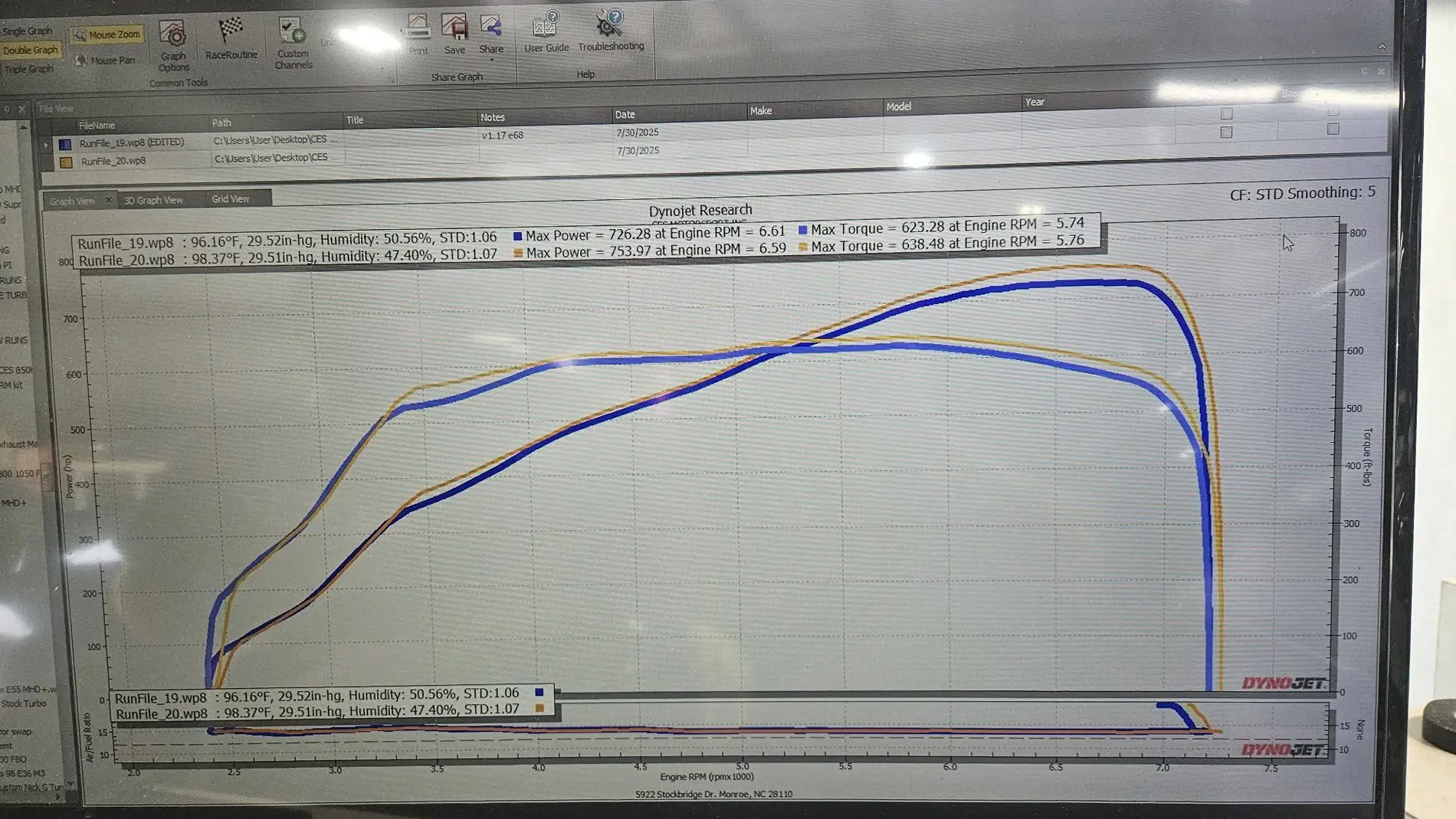

I am asking regarding what should my expectations be when completing my pure800 build. I found a pure800 at a good price and after watching CES’s video regarding tuning with it I feel like it is very close to the power level I am looking for.
I was shooting for 700-800whp, ideally landing in the middle. I have easy access to E so that’s why I am open to building it out. I have spent a lot of time reading the forums here alongside the Routes to Big Power since that was the inspiration for starting my build.
I saw that CES’s landed on 717 I believe and that is a little shorter than what I am shooting for but not far off. Is that a realistic goal to extract from the Pure 800 with PI?
I have been slowly attaining parts and have continued to research parts as I am currently looking into my intake manifold, in another thread, but I was wondering if the turbo can push me there.
I have also read that the stock internals can make it to about 800hp without too much fear and that’s why I am shooting for this power level, alongside being able to match/beat a model S plaid in a 60-130 run.
I do also want to maintain some level of reliability since I do know I can push it to the limit and just wait till it pops, I prefer NOT to do that. I just want to be able to meet/beat that goal when necessary and the rest of the time just enjoy occasional pulls and driving since I am not too harsh with my cars regardless and live in a pretty stable climate, where 75 degree days and no humidity is standard.
I might ambitious with my goals but since I have begun, I want to build it right to achieve my goal. I am open to hearing about power levels of the pure 800 alongside any advice relating to my power goal.
Pretty sure there is a 2 port P900 now or at least very soon.
I posted in another thread yesterday about it but on a dyno I'm making 747whp and 908nm (at 4350rpm) on mainline hub.
My setup is 6 port P900, do88 manifold (mera), port injection / reflex with 2 LPFP in fuel tank that feeds my surge tank and brushless in surge that primes, Upgraded PTB Clutch + DMF fly wheel as I'm manual, and other obvious mods like downpipe, catch can etc.
In terms of engine longevity, that really comes down to where you are making your power and shaping your torque. I'd also recommend sorting out PCV issues with block off pins if you don't want to tear your PCV diaphragm apart. Also depends on how you treat your car, if you are doing back to back pulls every day without being careful of temps you will break something.
For real world driving, I've managed a 4.94s 100-200kmh but as far as I can tell, is the fastest documented time for 6MT, so in an auto you'd likely be hitting closer to 4.5-4.6s.
Also I'm stock axles and driveshafts, no idea how people are snapping their axles to be honest but I also don't launch my car, always rolling.
