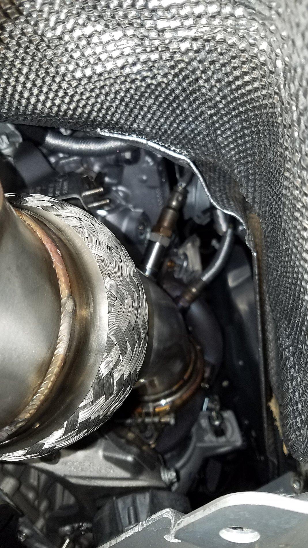

    Fabspeed is a quaility product, but it still throws a P0141 O2 heater code since it does not heat up the sensor fast enough... I am trying one other one I got in from ebay for $15 until I say screw it and chalk it up as an L and get a tune :)
    It is weird though, the test the sensor is failing for, almost makes me think it is a bad sensor...

    P0141 generally indicates the sensor itself is bad; specifically the heater circuit within the sensor and/or associated wiring. If the mini cat wasn't working well enough I would expect a catalyst inefficiency code like a P0420. I'd check continuity and replace the sensor before anything else.

    I understand that a P0141 would seem like a failed sensor, which I mentioned earlier as I thought the same... and I would agree with you if this sensor didn't only have 1000 miles on it, didn't read open between the heater resistor (read 6 ohms) and that the ohmic value dropped to within tolerance today after I put the ebay spacer in today, which moved the sensor closer to the exhaust.

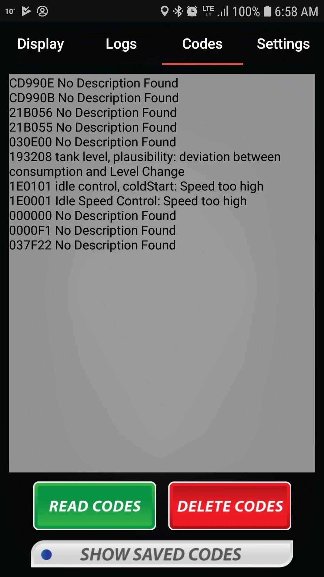

    I got the CEL today too but is it related to downpipe?
