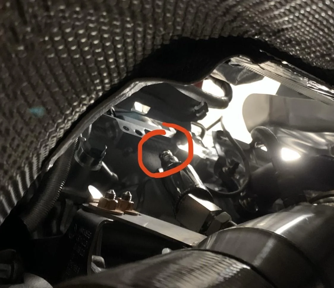

084runnerltd
Jake
Feb 15, 2019
452
502
ND
I have never had patience....
Got home from work, my “race ramps” won’t arrive til tomorrow, I thought, what the hell, let’s give it a go and try the install with my 6” plastic ramps...
2.5 hours later, the DP is in....I know, I know, I am a little slow. However, doing the downpipe with your nose rubbing on the underbody of the car sucks. I had to do some magic just to pull the downpipe out as there wasn’t enough clearance between the ground and the car to remove it. Lol
I installed the fabspeed spacer. No codes, but all I have done is start the car to check for leaks. We got snow today, so I couldn’t drive it and I didn’t want wake the neighbors revving it.
One concern I have is the wires from the secondary cat are pretty close to the engine (due to the spacer)...when I first started the car, I smelt some melting....I think it was just the new pipe, but now I am paranoid and may go in and try to move the spacer further from the engine...
Running JB4 as well...map 1 for now.
Should I be worried about this wires location?
That spacer looks different than my Fabspeed spacer. When I ordered through Titan they didn’t specify which I would be getting. Maybe the other one would clear the CEL

larrymz3
Sep 8, 2019
293
143
Arkansas
Looks the same as what I got from Titan. Yeah, the Fabspeed mini cat is large - there isn't much room. As long as the o2 cables aren't touching anything you should be fine.
