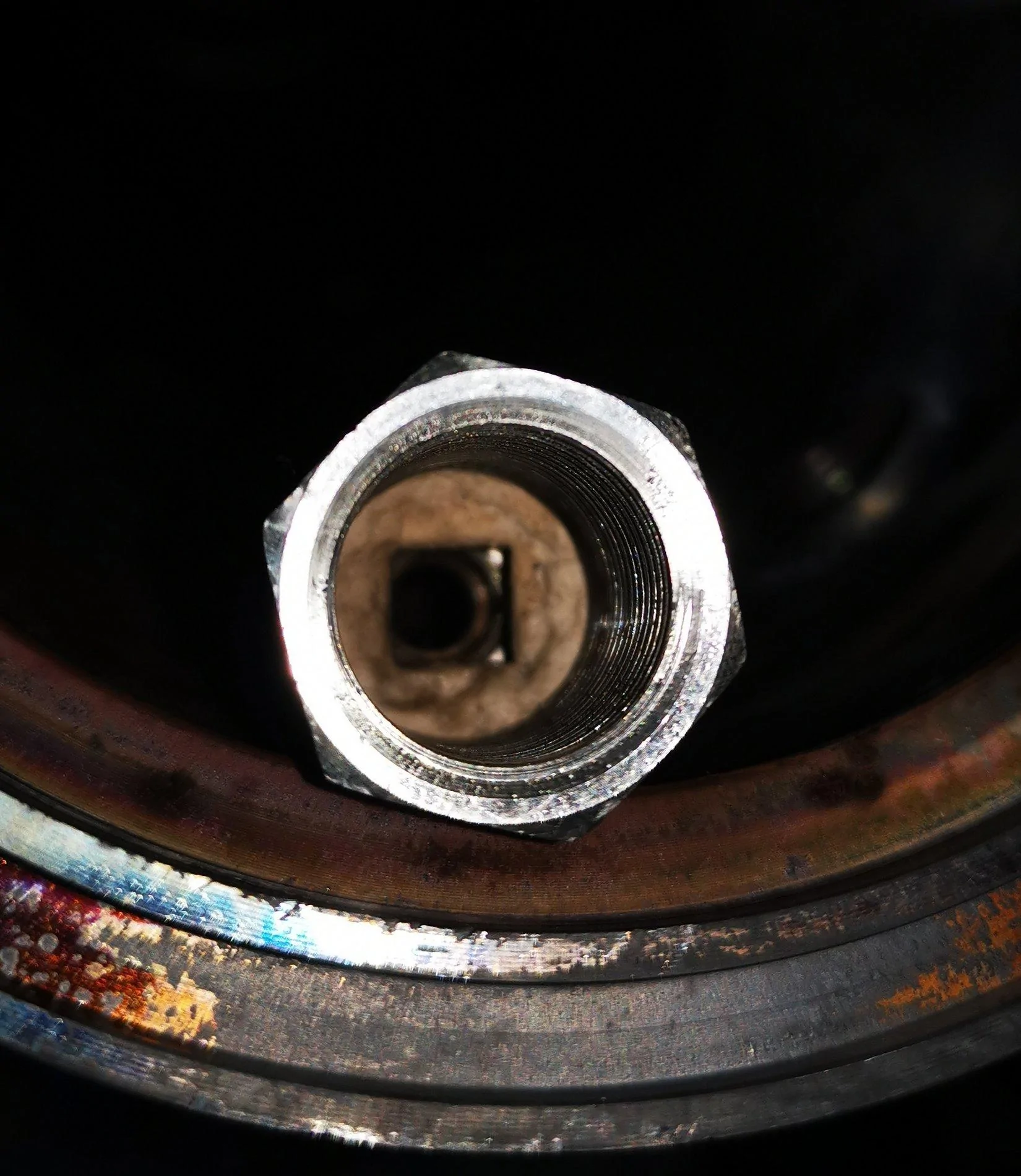

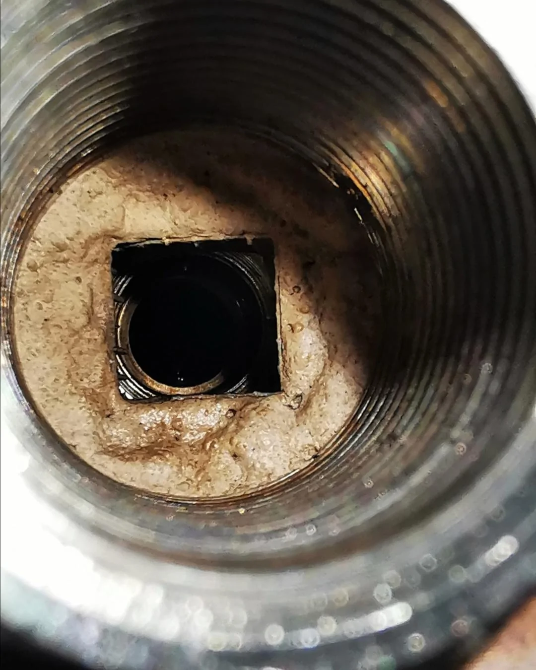

Guys, these extenders just don't work, I had the CEL come on even after installing big daddies extender, piece of $&#t, and I decided to remove it today and found the whole cat material gone, with only 3000 miles on it, on stock turbo, these ghetto parts definatley can't take boost.
Stick with a flash to override the CEL or just keep deleting the code when it pops like I do through the JB4.
What is going on in the picture? What are those gunks?
