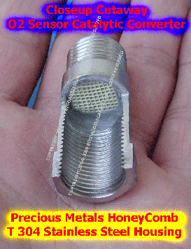

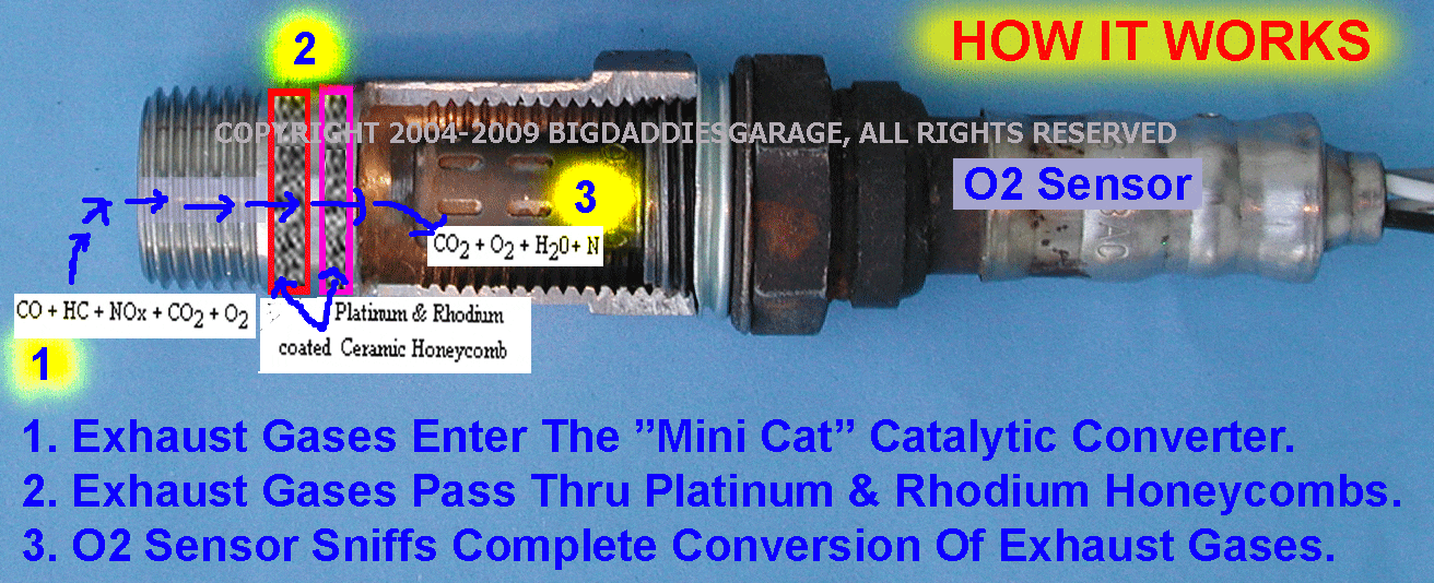

What is going on in the picture? What are those gunks?
There used to be a mini cat honeycomb imbedded in that area that takes care of the CEL, it just dissintegrated it self .
