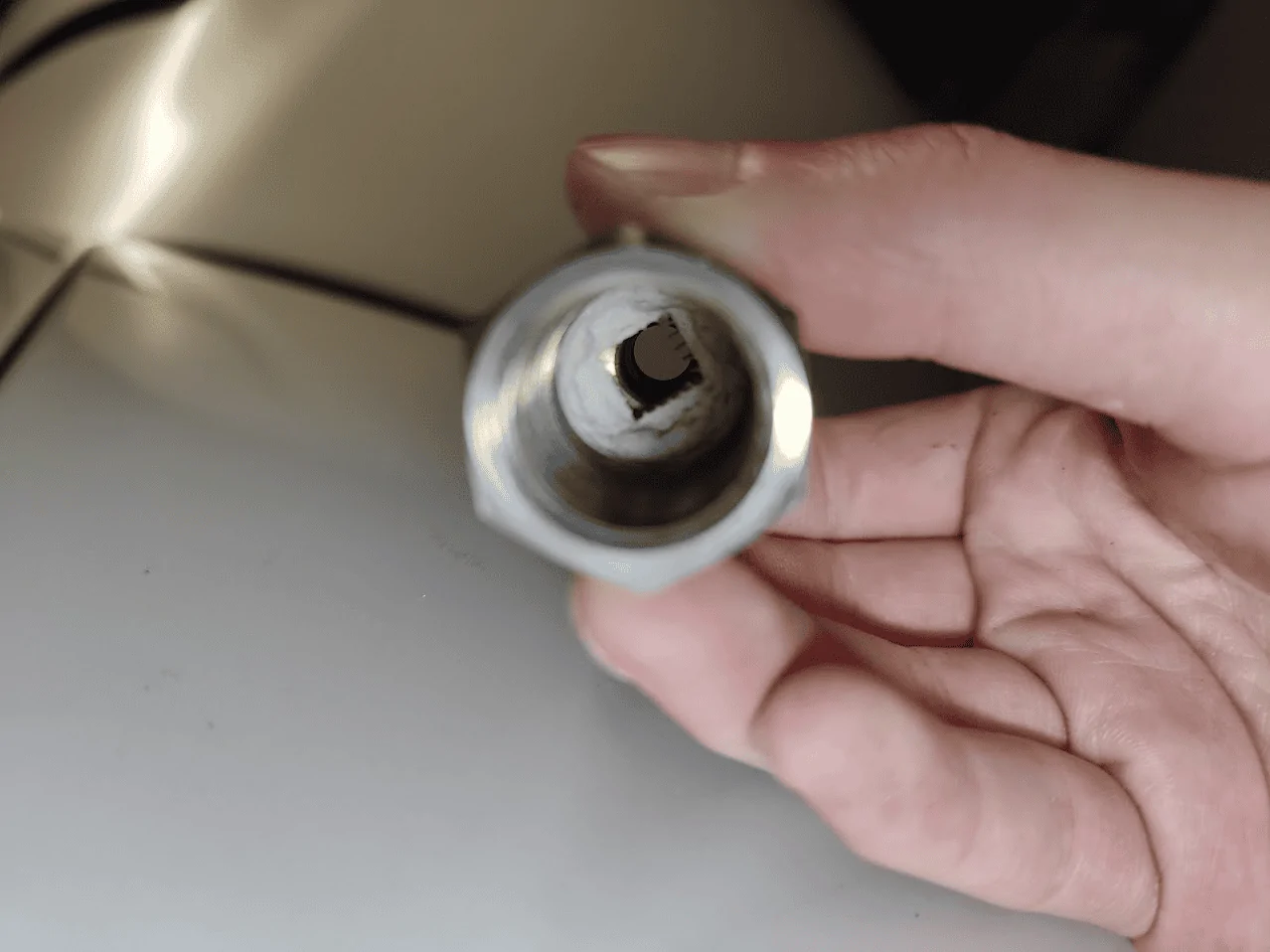

Took the Big Daddies O2 spacer off some time ago.
The special "mini-cat" melted, in less than ~1000 miles.
Was still on stock tune when I had it on.
Forgot to post lol.
Recently tuned on BM3, so CEL is gone.
Edit: YMMV ofc
If it matters: Stock tune was S18T-22-03-535 (March 2022).
Also have Versus 6-port turbo shield installed.
Could've died from extra heat. :dunno:

Not surprised. I could see no way that thing was going to last. I guess you could just drop 50 bucks every few months or so...?

I'm not sure if it melted right away lol.
But the CEL did stay off for a little while.
Unsure if its from clearing the codes after install.
I knew it was going to be a temporary solution until I could get tuned.
Bought it for $15 from another forum member.
After a few weeks, I found out local tuner was doing a sale on bench unlocks and BM3 licenses.
Discovered my ECU was tunable, went that route and havent looked back.
Edit: In the pic, the material melted towards the O2 sensor.
Can potentially damage the sensor.
