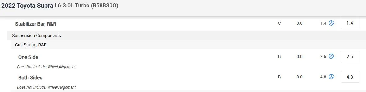

I'm not defending whatever shop they got a quote from, however, most places will go off book time and not straight time for swapping stuff out. For some reason book time calls 4.8 hours for the front springs and 2 hours for the rear. Dealer I work at if someone came in and asked for a labor quote would be $1161 and they charge $129.95 for alignment.
I'm not saying it's right as I know you can change them out in probably a couple hours, just stating why he was quoted what he was quoted

wait. this table style.. reminds me of ALLDATA. this makes sense now.. but i hate it. thanks lol
