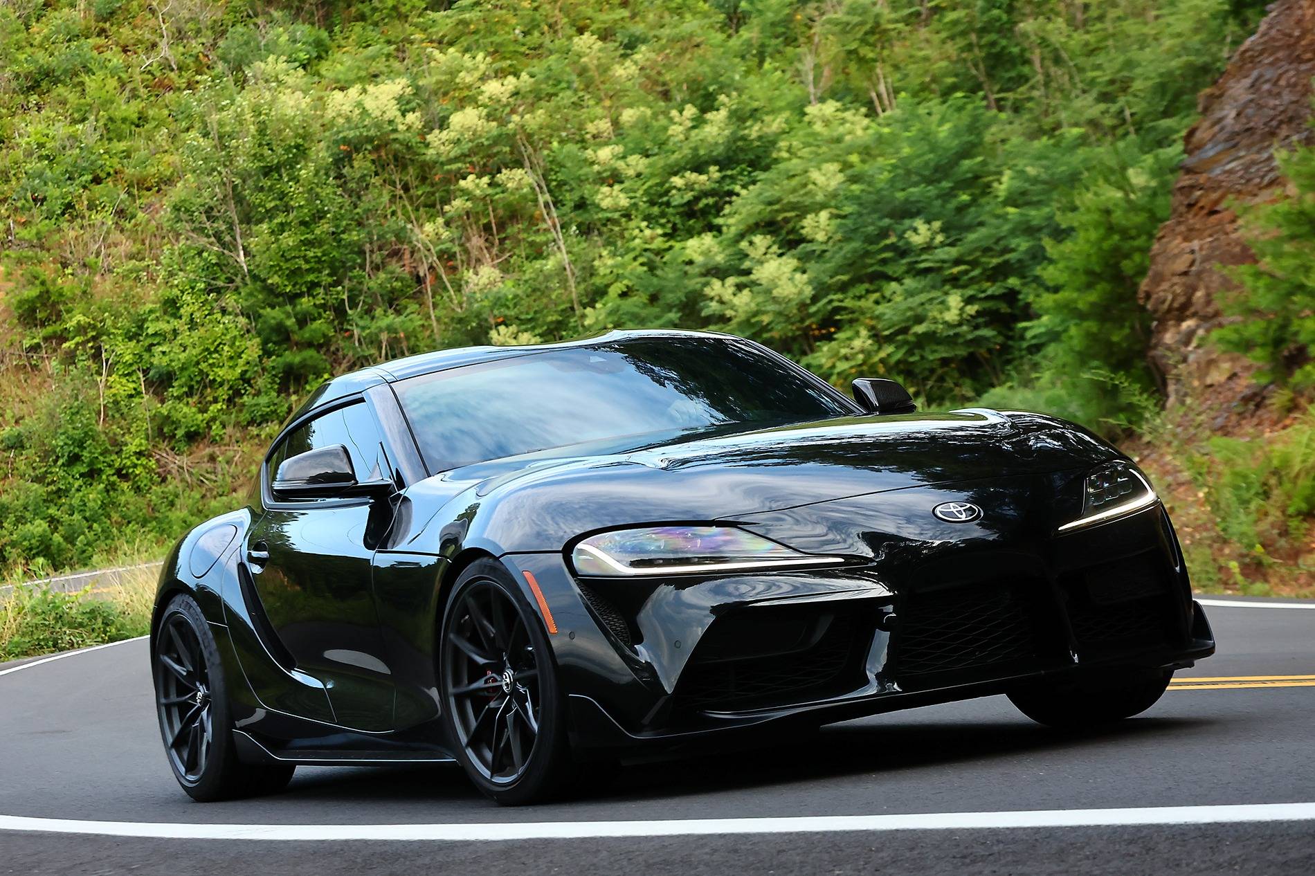

13mm up front
15mm in the rear
These are the most common sizes for our cars, I went with these sizes also and I think they are perfect for a non poke flush fitment. I went with Burger Motorsports spacer.

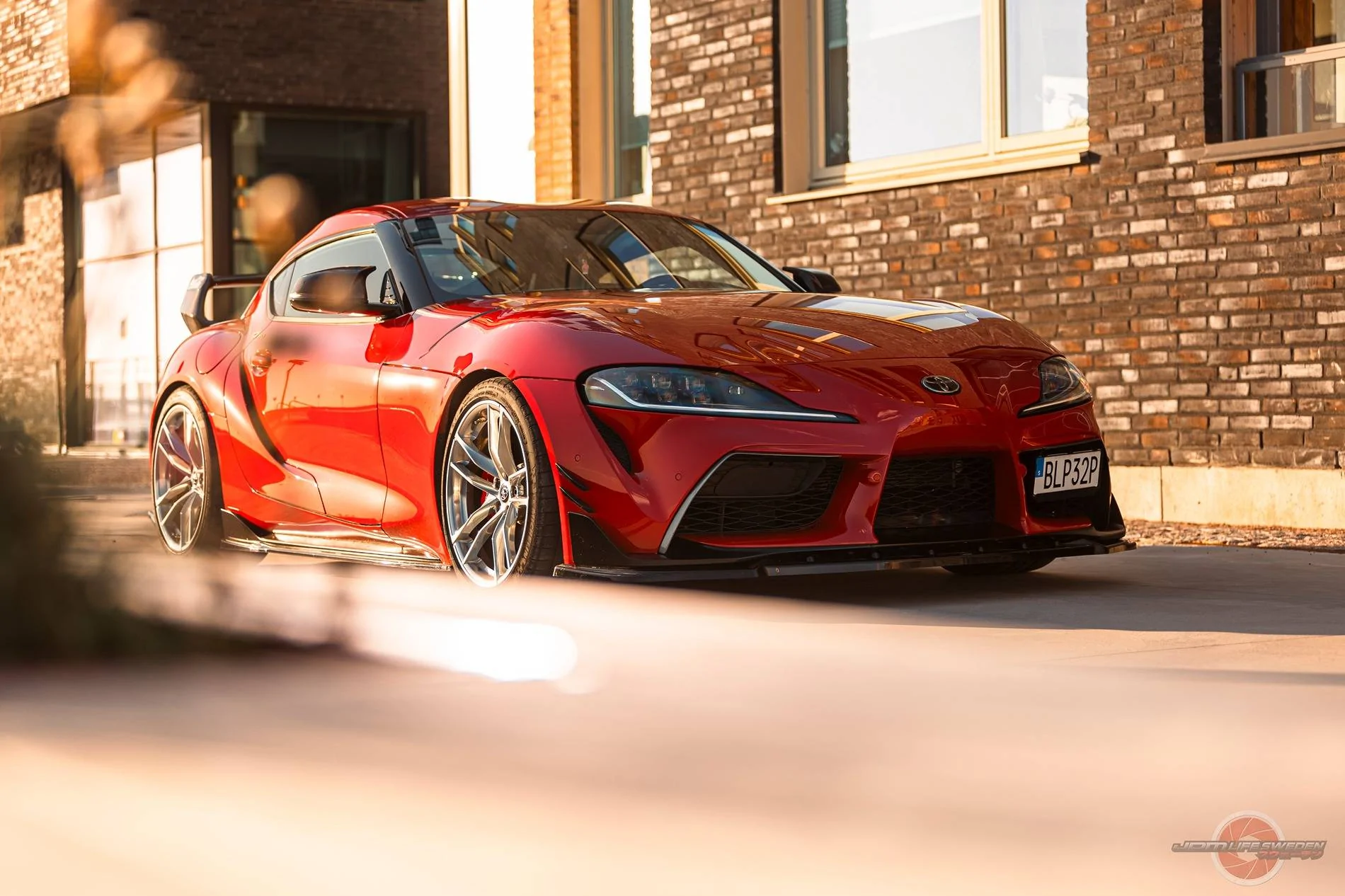

I had 12mm front and 15mm rear spacers. Fit just perfect in my opinion :)
Lowered on Tein springs and stock tire dimensions for reference.
