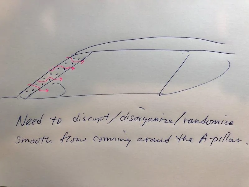

There are many band-aid fixes people could be trying. Add roughness/randomness to the A-pillar surface, try adding trip strips/dots, try a fence/groove, etc. Basically, interrupt the smooth rounded shape that allows flow to roll off in a sheet.
Off the top of my head, some fixes to try would be:
1) cut a sawtooth pattern into the edge of some flexible material about 1/4" thick and stick it to the A-pillar (sawtooth facing forward). I have seen self-adhesive foam sheet that would work.
2) buy some self-adhesive rubber bumpers approx 1/4" high and place them along the A-pillar in a zigzag pattern, maybe one every 2" or so.
3) stick down a small piece of wood strip along the A-pillar about 1/2" high. Variations on shape/size.
Etc... Consider this experimental but with an eye towards something that would look OK when made out of the right material to be permanent.
