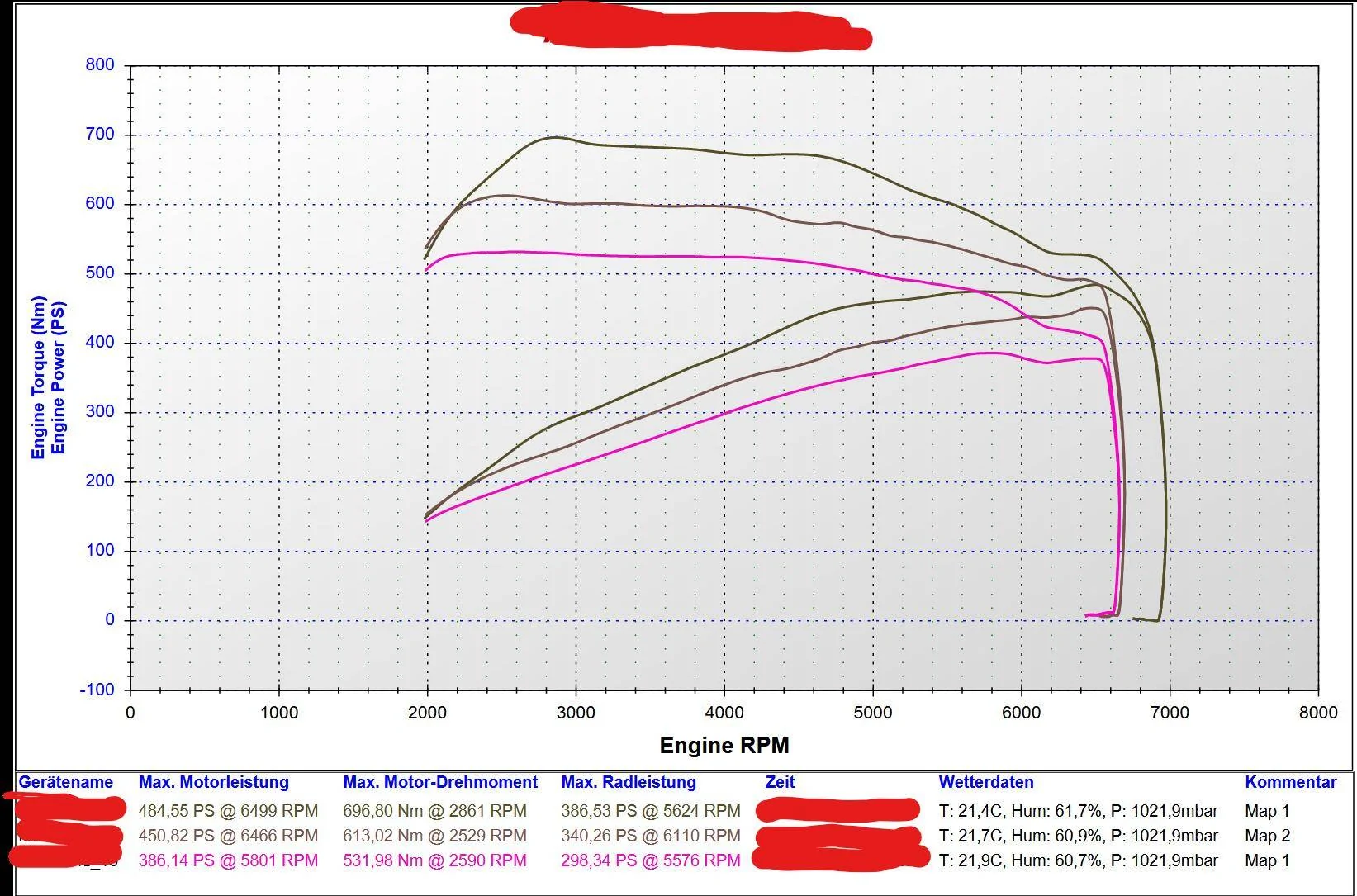

Went to get the tune. He installed a 200 cel downpipe, MHD+ and did the dyno tune.
Can you guys check the results and tell me if its "good" ? 484 HP seems decent to me.

484.55 PS = 477.7 hp
696.8 Nm = 513.9 lb/ft
Seems about right, if not a little high.
I'm assuming the first run was with stock tune?
387 hp / 392 lb/ft
Gains of +90hp / +121tq
Thank you. Its the EU Supra which has a twin port and rated for 340 HP which in reality is around 387 and I asked for a "Stock map" so yeah I guess the first run is the stock map. I think we can see the 3 Maps he did for me, although he has Map 1 two time here, which confuses me a bit but I guess its just a typo.

Yea that dyno is probably set to be closer to flywheel numbers and not wheels. Even the 2 ports here in North America without OPF don't dyno that high to the wheels. More like 340whp or less. The 6 ports dyno 360-380whp.
However, you have a before and after which is what matters, and your gains look great.
