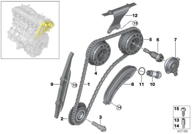

Has anyone looked at the valve solenoid issue on B58? (VANOS) see below :
This is from BMW tuning on B58 engine issues.
B58 VANOS Solenoids
VANOS is BMW’s terminology for VVT, or variable valve timing. Ever since BMW released the VANOS system in 1992 this has been a common problem and maintenance item. Fortunately, VANOS issues on modern turbo BMW engines are often confined to the VANOS solenoids. Solenoids are relatively inexpensive and easy to replace. However, the is one catch on the B58.
The B58 timing chain was moved to the rear of the engine. Guess where the VANOS components reside? Right by the timing chain…at the back of the engine. So, we’ve got a bit of a headache here. Although, let’s put a rumor to death quickly. Replacing B58 VANOS components does NOT require lifting the engine. This is a misconception. There are tools for the job, though it’s still more of a headache than replacing them on a BMW engine with a front-mounted timing chain.
We’ve already seen some VANOS problems with the B58 engine. They are currently far and few between. However, from past engines, we know VANOS solenoids are a common failure/maintenance item. Be on the look-out for more of these issues to pop up in the coming years.
Symptoms of B58 VANOS Solenoid Failure
  • Power loss/limp mode
  • Engine hesitation and bogging, especially at lower RPM’s
  • Rough idle
  • VANOS fault codes
  • Poor fuel efficiency
The above are common symptoms of B58 VANOS solenoid issues, but may not always point to a VANOS problem. Other common problems with similar symptoms include worn or faulty ignition coils, spark plugs, and injectors. However, fault codes will help point you in the right direction. VANOS solenoids may be considered a normal wear and tear item. Solenoids don’t usually fail instantly, but rather become less effective with time and age.
B58 VANOS Solenoid Replacement
The B58 uses two solenoids. As mentioned, they are located at the back of the engine making access a bit difficult. Although, VANOS work can be done without lifting the engine. Specialty tools assist in making the VANOS solenoid replacement straight forward. Expect B58 solenoid issues to arise around the 80,000-100,000 mile mark. However, you may make it well past without issues. Two of our N54’s are nearing 120,000 miles on original VANOS components.
Valve actuator
https://www.fcpeuro.com/products/bmw-actuator-11367614288
BMW revamped the VANOS system on the B36/B38, B46/B48, and B58 engines by replacing solenoid valves with a VANOS actuator. This actuator is responsible for physically moving the VANOS central valve in the camshaft. This system is relatively straight forward compared to previous VANOS systems.
Part #7 valve actuator
Special pin wrench tool
https://www.ecstuning.com/b-genuine-bmw-parts/pin-wrench/83302360895~oeb/
