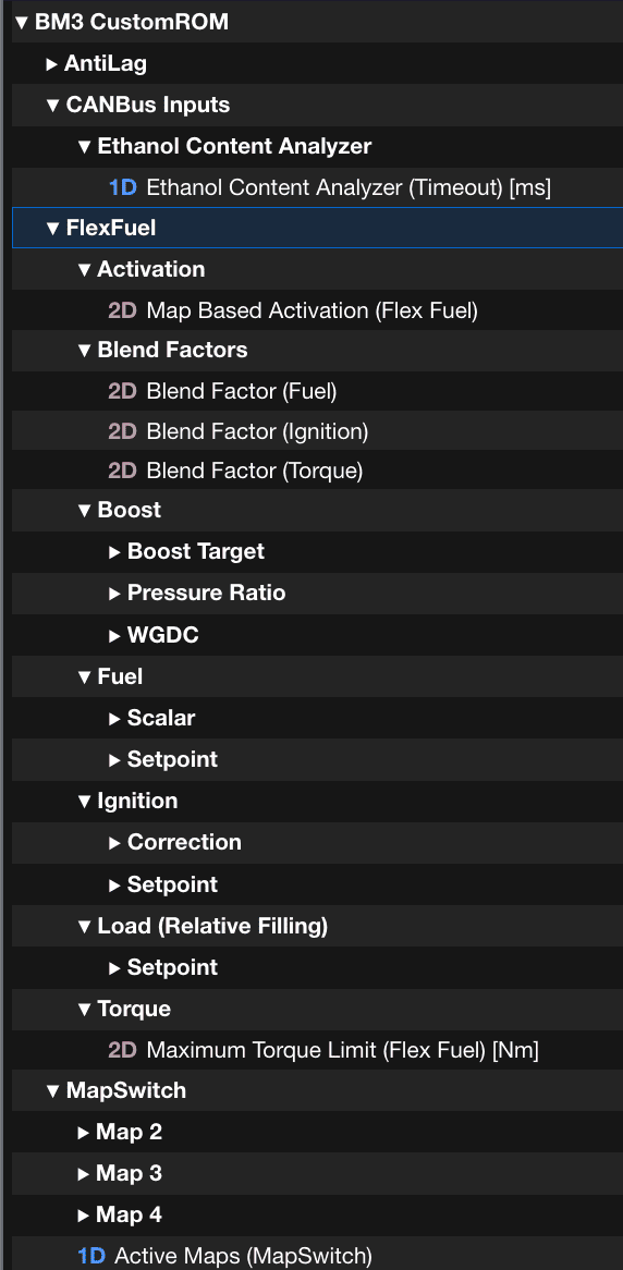

I'm confused on the statements of no map-switching and flex fuel interpolation with BM3. My BM3 custom rom tuning is showing both capabilities with all tables included...
Cant use Canbus Customrom without cloning the ECU unless you have a normal tunable ECU.
