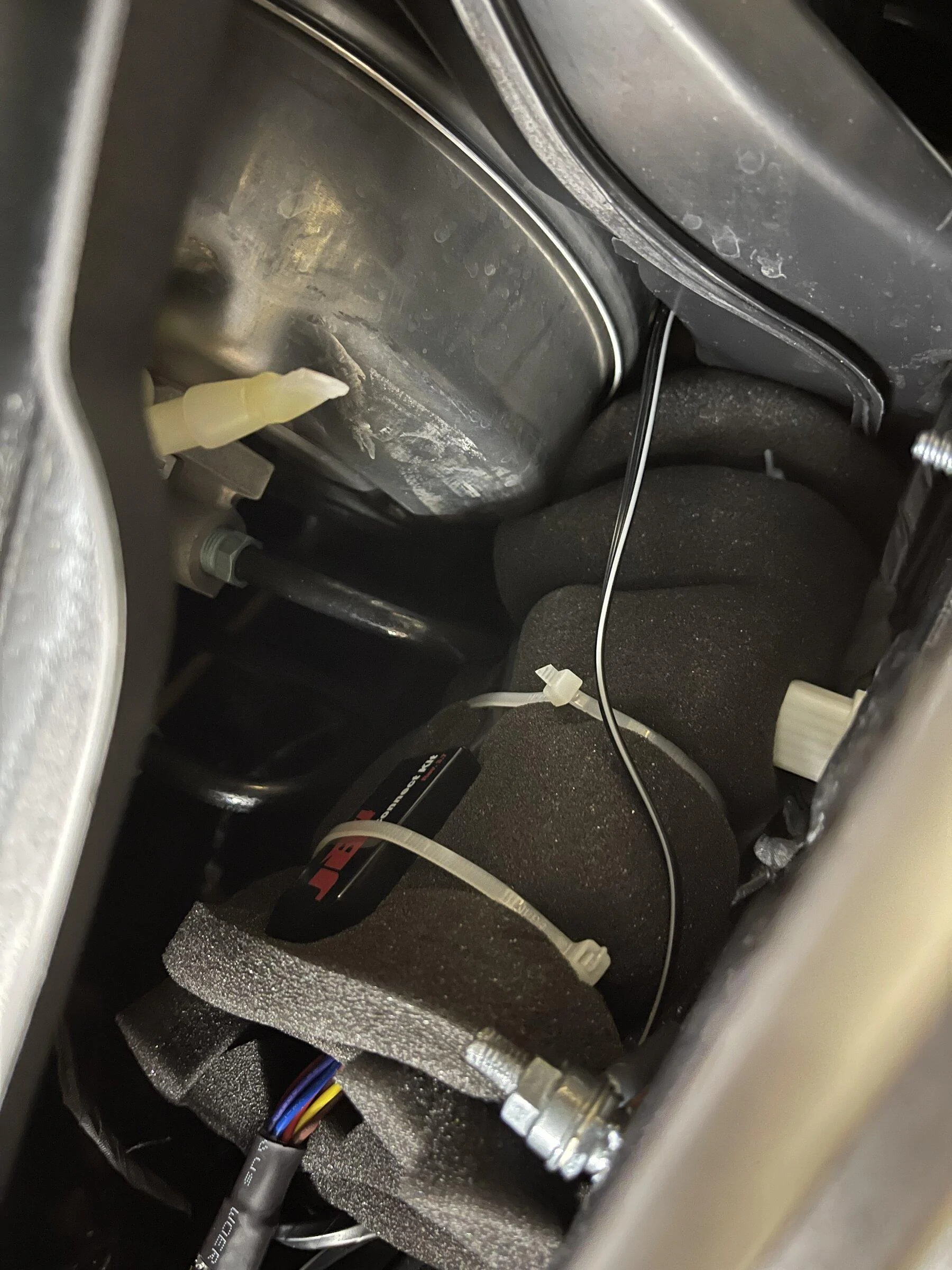

Just left in the cubby above brake fluid. It did fine for 15-20 track days before I went ecutek
No need to mount unless it just bothers u

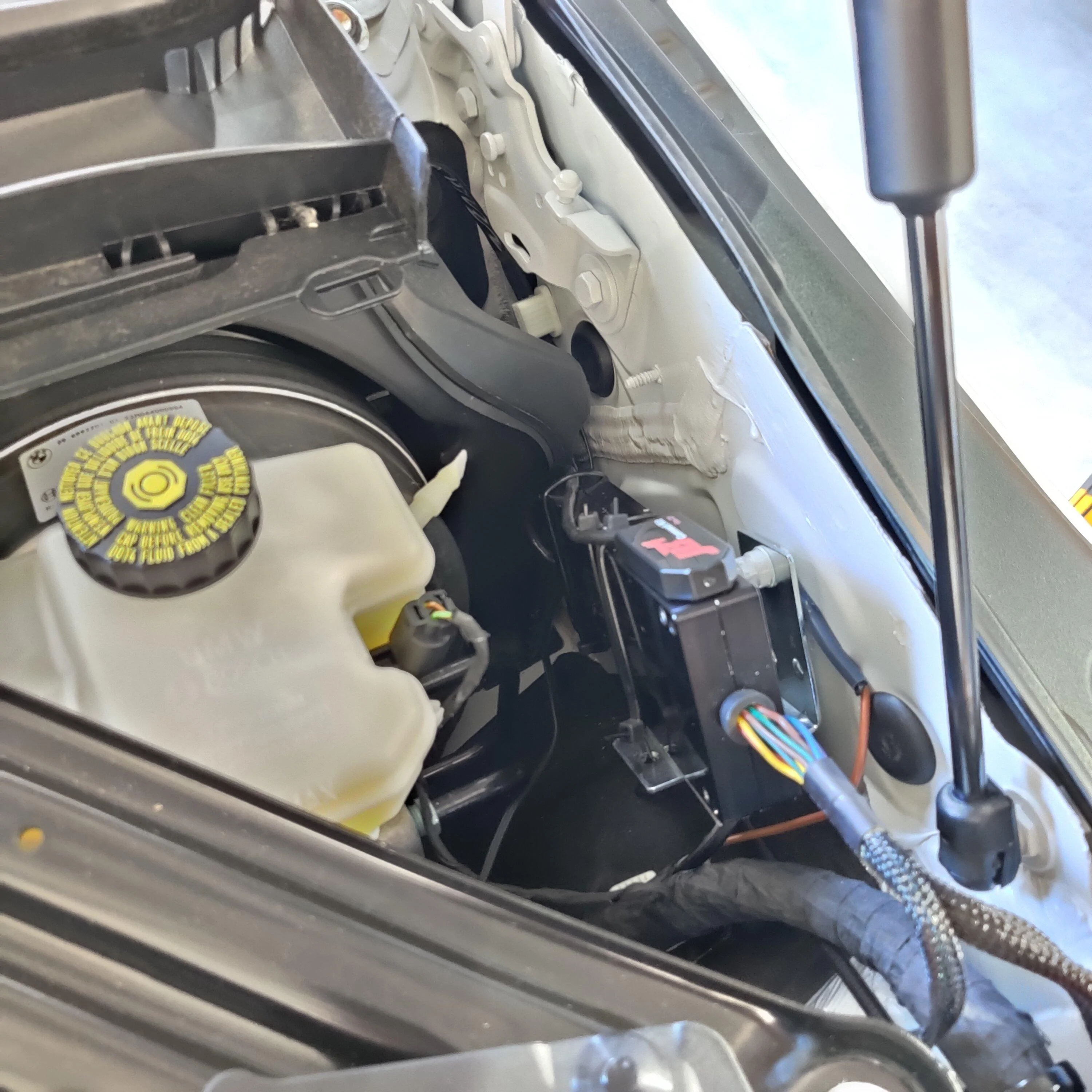

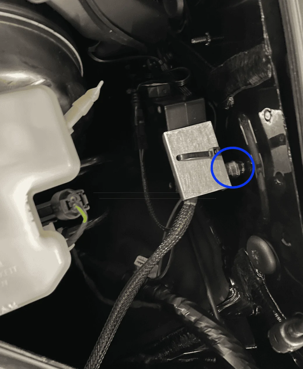

I took an aluminum Ikea door handle for wardrobe to make a little bracket. The JB4 and wireless module is zip tied to the bracket. There is a bolt sticking out from side of the engine bay so used that to secure the bracket. My unit is secure, no play.

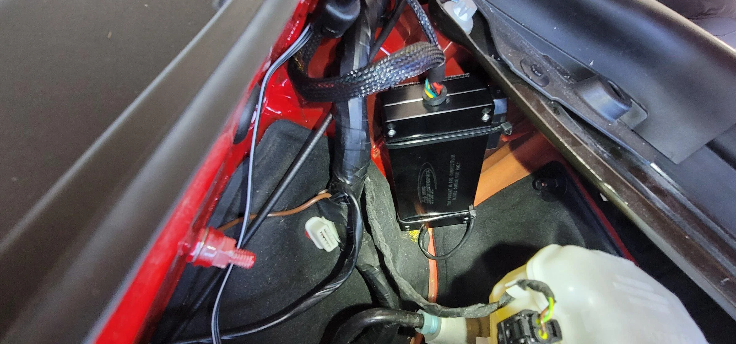

i I have the JB4 Velcroed to the wall infront of the brake booster with the wireless phone connection module zip tied to the JB4 unit itself.
This is the Velcro tape I used I got it on Amazon BTW.

When I finally get mine I’m planning on using avionics bracketry to hard mount somewhere

i used the double wide bracket suggested here and used the grounding stud. will need to hog out the hole a tiny bit with a drill. orient the bracket at a slight downward angle (about 20 degrees) and you should be able to mount the jb4 without making contact with the firewall or the rain cover.
Rather than velcro, I used 3M dual lock tape. The same stuff that comes with your Tollway I-pass/E-ZPass. Use an extra long strip on the jb4 itself so you can adjust it either way. And then a pair of zip ties in an X configuration to make it extra secure once you're happy with the position.
parts list:
https://www.homedepot.com/p/Everbil...Corner-Brace-2-Piece-per-Pack-20744/205338336
https://www.amazon.com/3M-Reclosable-Fastener-SJ3560-Clear/dp/B00JHKTDMA
