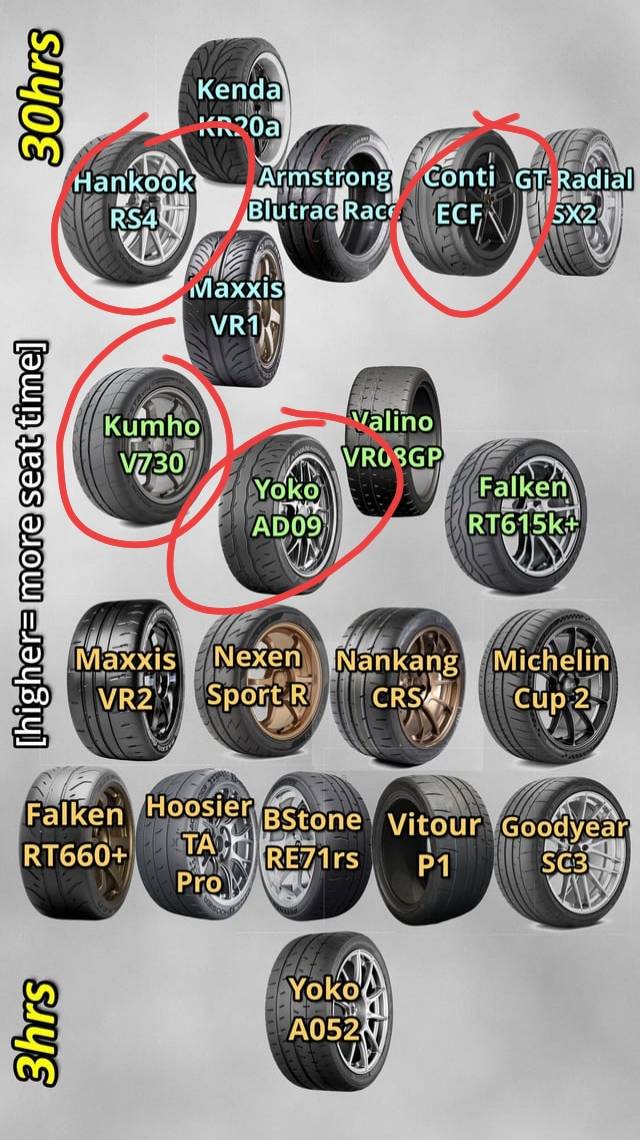

The circled endurance 200 tires had good pace and life when reading thru the individual GRM articles. The ECF was one that wasn't on my radar until recently.
Otherwise, rs4 and v730 are pretty much the most popular choices for intermediate hpde.

This is the most odd graphic. This isn't by pace is it? Because it's way off if so.
Out of the ones you circled, V730 is the fastest, and probably the cheapest. $900 for four 275/35/18 is probably the best price/performance ratio out right now.
ECF is like a modern day RS4. Slow as balls but lasts forever.
Vertical axis is life. Horizontal doesn't have a meaning, iirc. I prefer this to the GRM table when giving a quick recommendation to someone that hasn't read the articles yet, since the info is pretty dense. It only makes sense after you've read a couple.
Vertical axis doesn't have any meaning either though :p
Problem is all the testing is done on a car that weighs 25lbs wet with 1.53hp. Most GRM tests I just read as entertainment.
It is quite comical to see them claim that tires with a zillion heat cycles are faster than stickers. I should be charging a premium for my take offs!
