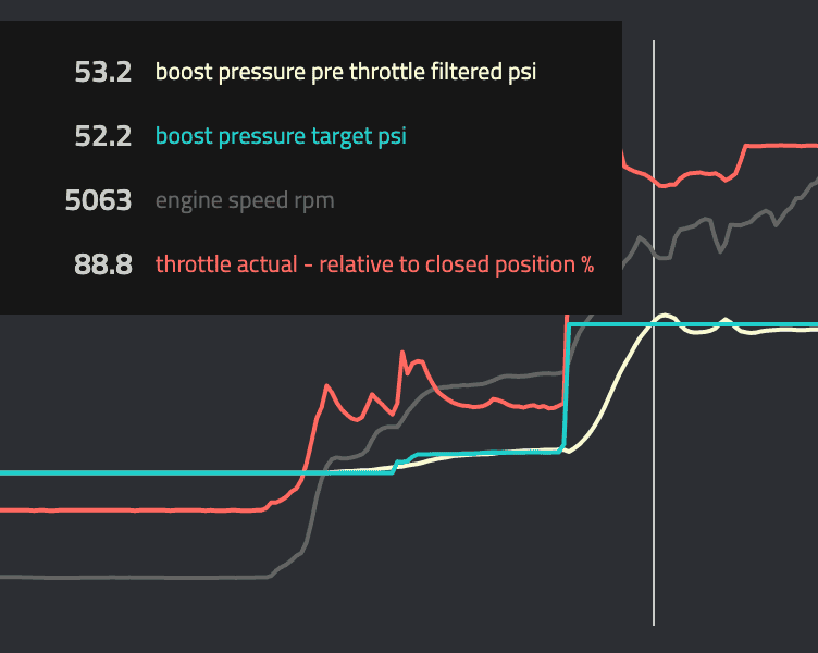

Well, TFA for one, and the fact the throttle blade is used heavily to regulate boost as a second.
In other words, in normal driving, the “gas pedal” controls the Valvetronic hardware rather than the throttle plate.
"Normal Driving" refers to driving a car to work and back, not under boost, where the B58 uses the throttle blade to regulate boost heavily. We rely heavily on the throttle body, and it's a key parameter for tuning. (Yes, the VANOS and Valve stuff is also in the logs; I don't log it because it's completely unnecessary, at least until cams aren't back ordered any more).
Also, "Valvetronic" controls like that don't respond quick enough for things like aggressive changes in load (launch) or WOT conditions.
That is interesting to know and TIL. I would have thought boost would be regulated with turbo wastegate. Thanks for the info.
