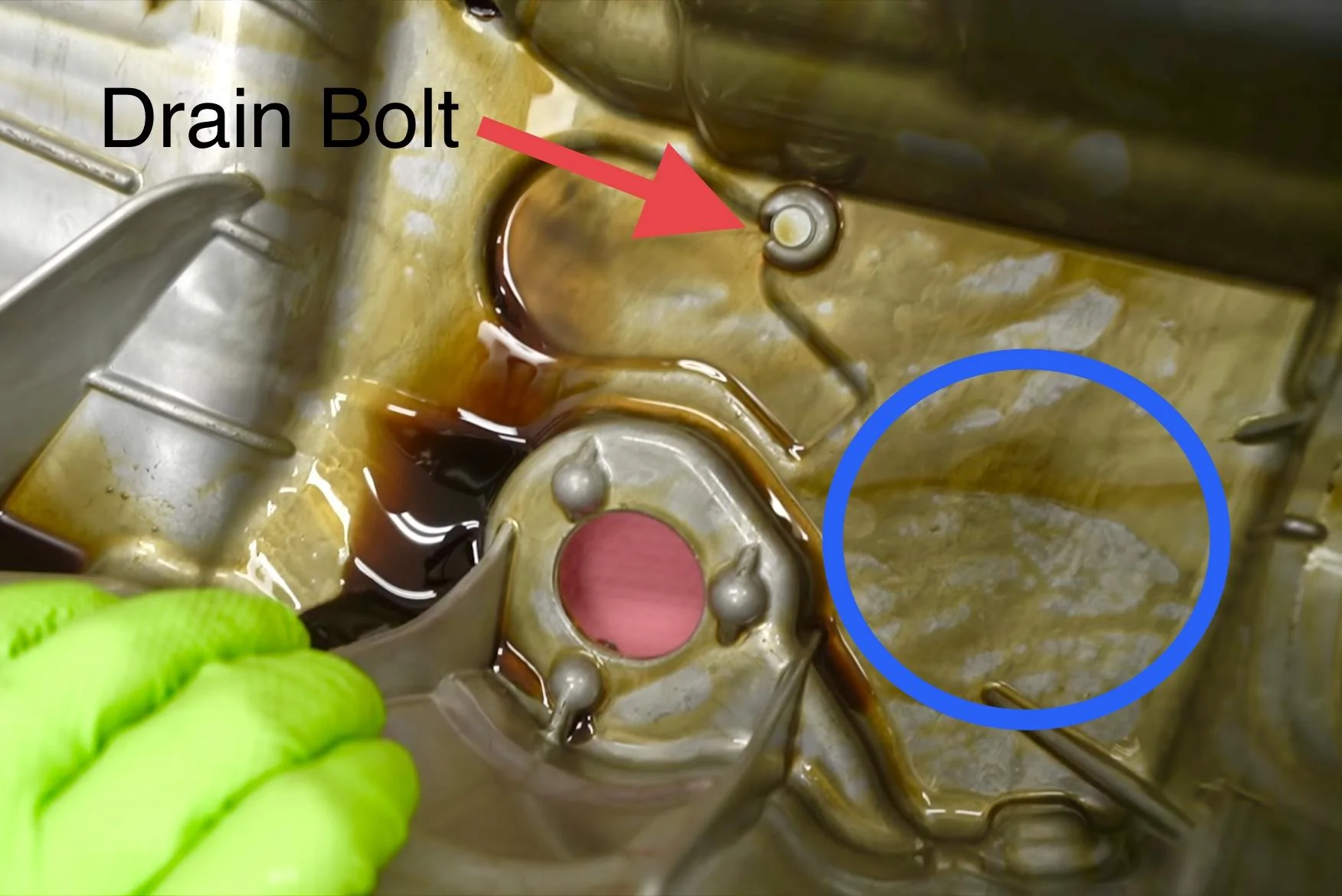

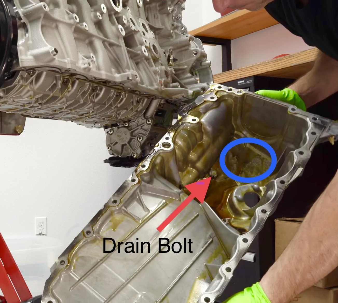

You bring up some valid points. I bet some dealerships don’t have the right rectangular adapters for the lift points.
Also, the drain plug isn’t completely at the back of the pan. There is a section that could pool a small amount of oil based on the angle of the car.
There are a couple of methods for oil changes, ramps, hydraulic jack, and jack stands. It really depends on your budget and what tools you have in the garage.

Interesting. So I did the oil change. The car is too low for even low slope ramps. So I just drove it up onto two 2x6s, which worked great! And by the way, I agree that a little oil must have been left in the pan as I refilled with only 6 liters and it showed full.
