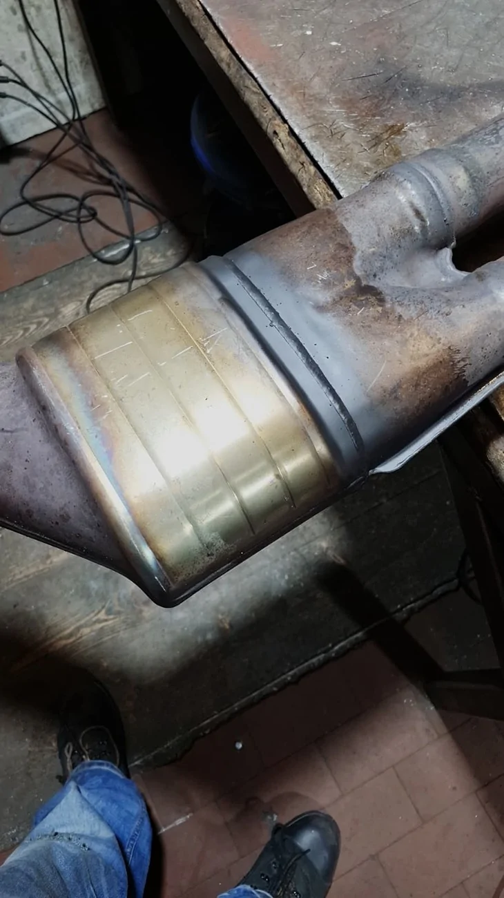

So, the conversion is completed guys!

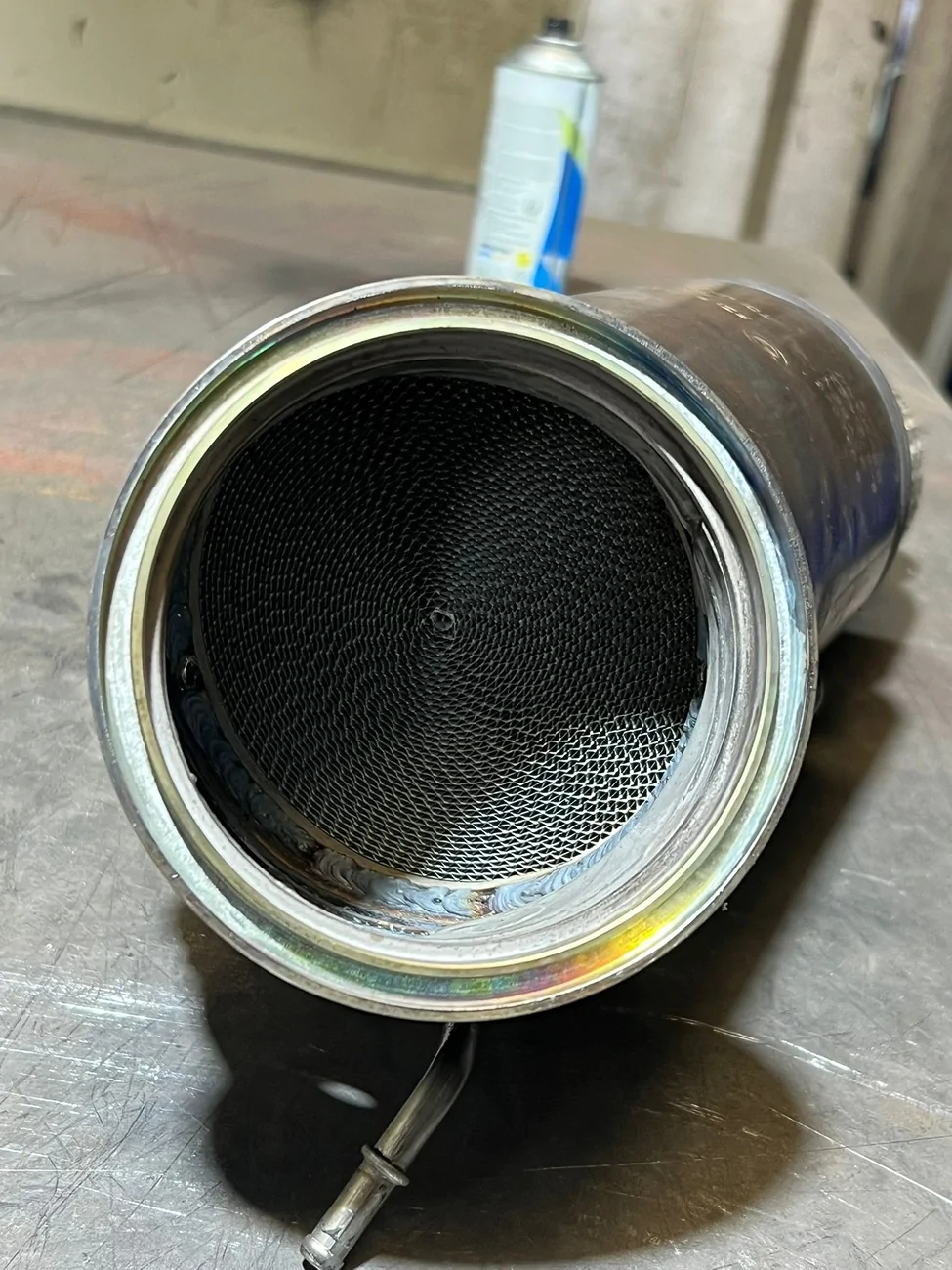

First, I changed/modified the downpipe.
The catalytic converter was removed from the OEM downpipe and replaced with a 300 cell one.
Before:
After:

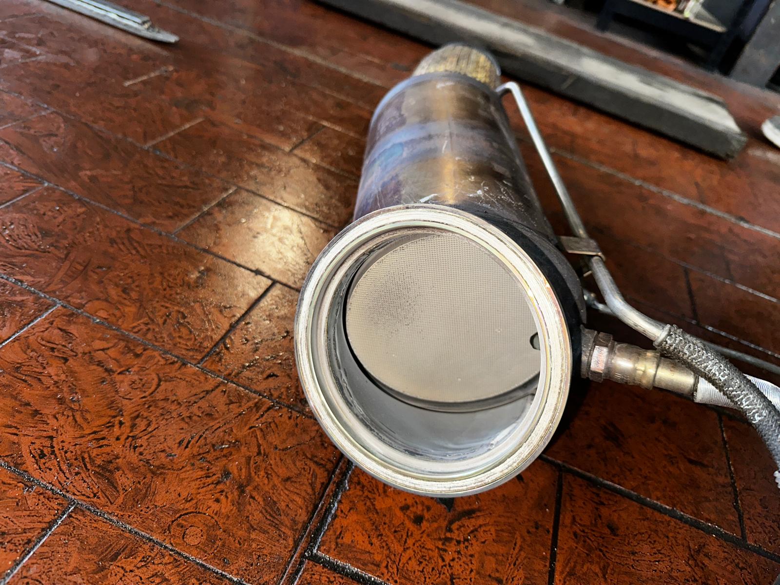

At the same time, the OPF was removed/deleted
Looks original from outside:

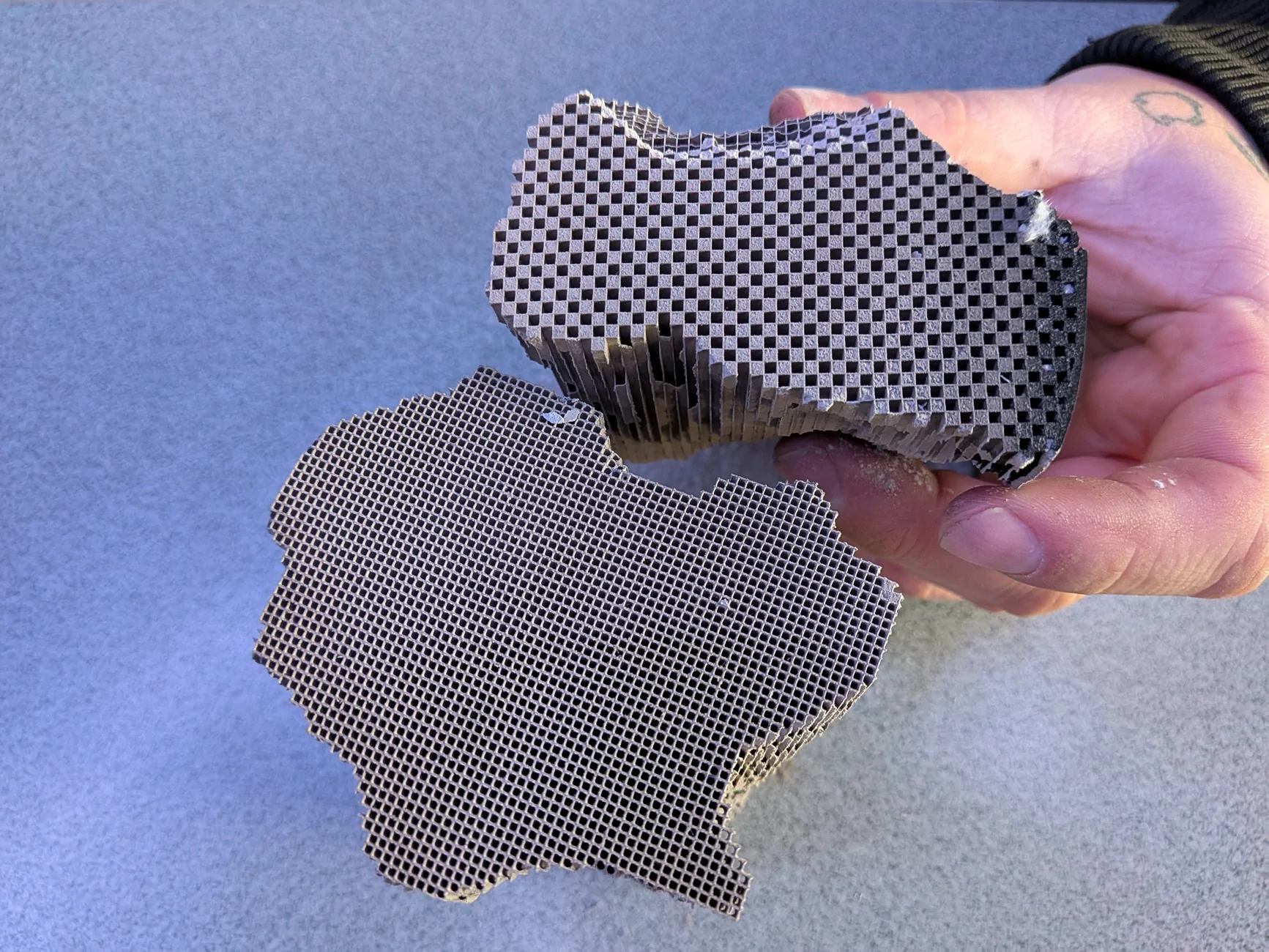

OEM Cat & OPF was removed

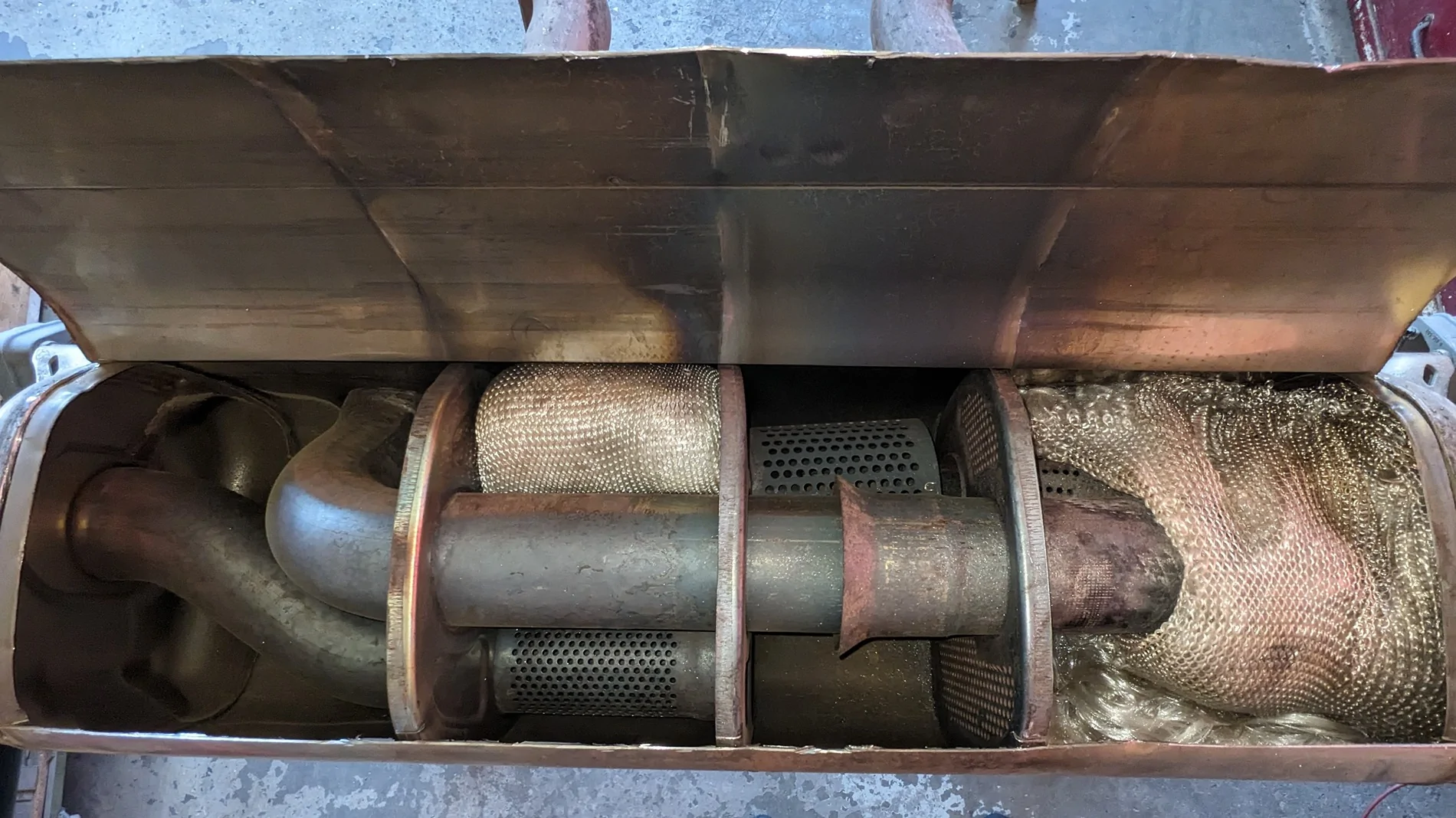

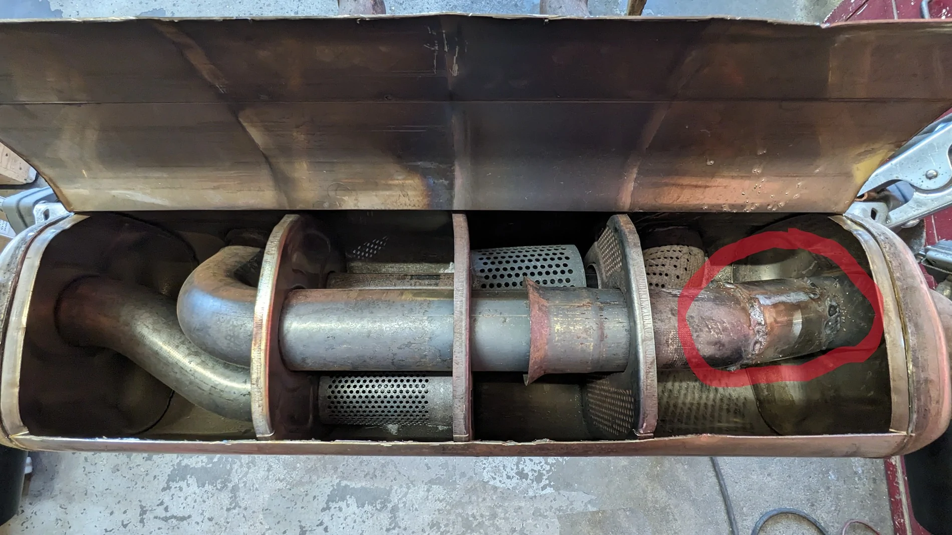

So, I modified the OEM muffler as well..

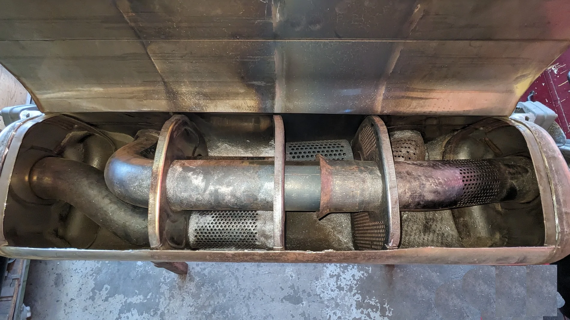

OEM muffler:
Before
After:
From outside, everything looks original.
