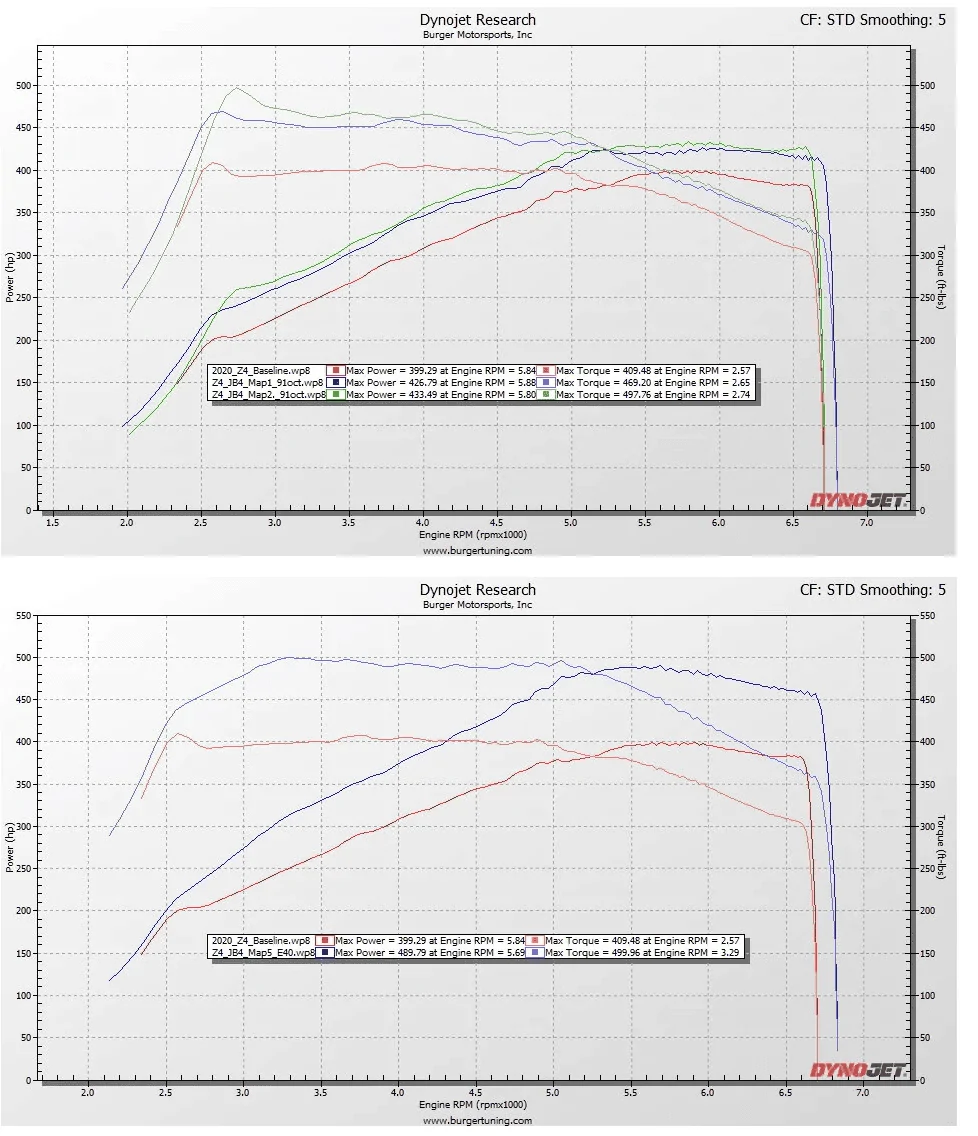

This was on a stock Supra with just JB4??
Look closely, it’s a stock z4. Starts at a higher baseline. In map 5 (e40) the same engine is seeing a +80hp gain.

I saw the Z4 but I didn’t know if they had to select that for the Supra, like BimmerCode..
There’s various people on this forum that have run each map on dyno, I could only find the 2020 numbers though, so I felt it was irrelevant to this thread. Same type of gains
