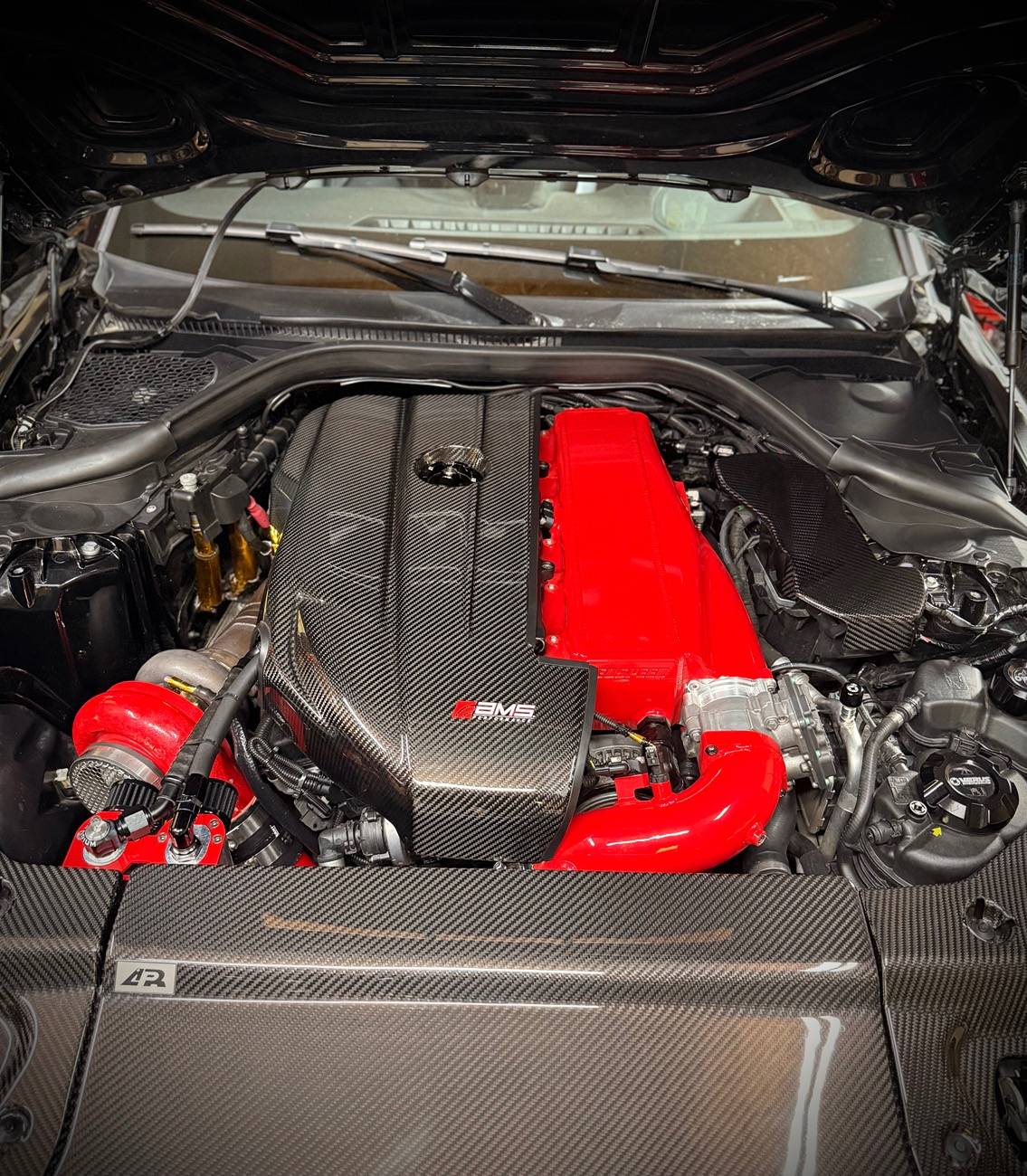

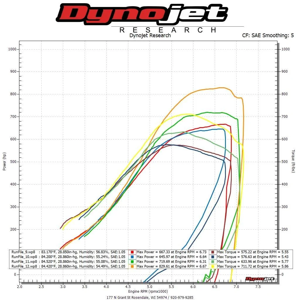

Edit: added a dyno graph
Wanted to share for anyone who might be interested.
This is the P2uned Series 1 Turbo Kit with the EOS Intake Manifold and Port Injection. I’m running a Xona 9564s, with two turbosmart wastegates and a Tial Q50 blow off valve.
This setup on E85 makes between 800-900whp at ~40psi.
1/4 mile trap speeds between 140-150, ETs between 9.2-9.8, 60-130 between 4.7-5.5.
Total cost before drivetrain modifications: $12,800
