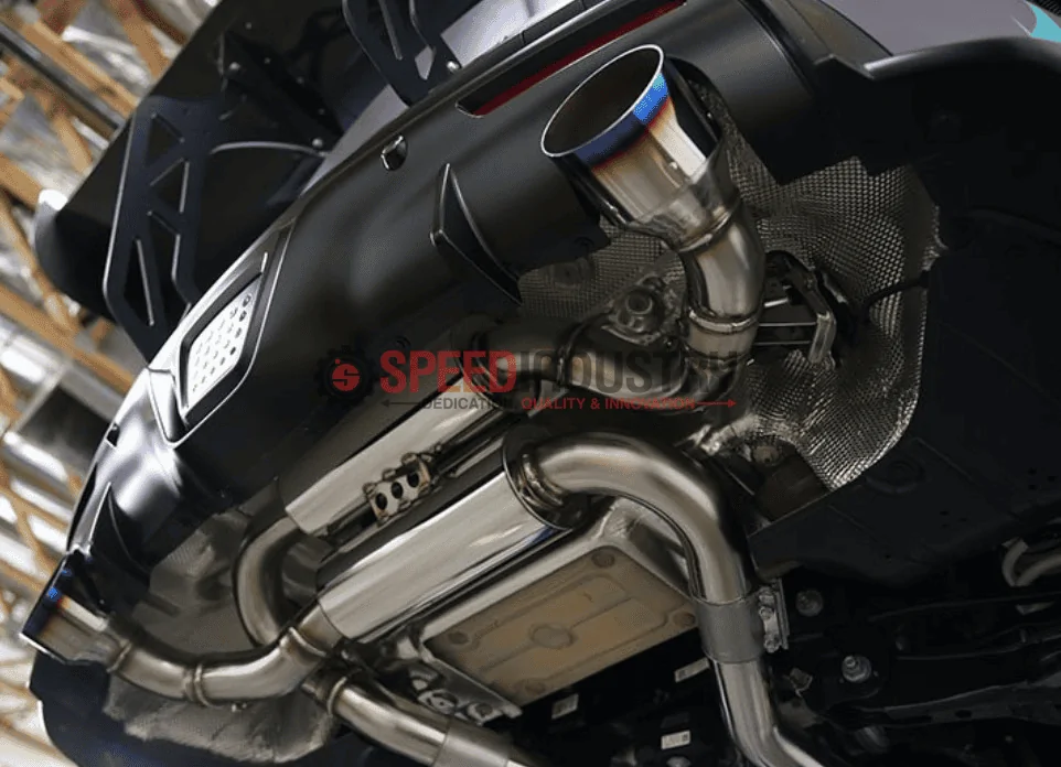

Okay riddle me this about the HKS setup because it's been brought up repeatedly - maybe I'm just looking at pictures and not seeing what's going on. It looks to me an awful lot like the piping is the exact same after the Y on both the valved and non-valved side.
So if that's true, what difference are you getting in sound aside from the changes in the engine map to turn up the pops and burbles? Is the valve not just there to keep the car's ECU happy?
When that valve closes, I actually want it to do something. On the GT350, it may as well have been a mute button. You'd never know how loud the car could get when you were cruising the interstate at 75mph in 6th.
The 2nd "muffler" acts like a resonator/damper when the valve is closed. This should eliminate droning, "rasp", and amplitude (sound pressure levels).
The 2nd muffler also has a different internal configuration than the primary muffler and allows gas to move more freely through it when the valve is open.
Finally when the secondary muffler is open it effectively doubles the area the gas is allowed to flow through.
All of these combined add up to a significant increase in sound pressure levels when the valve is activated.
Keep in mind however that Japan has some serious restrictions on how loud an aftermarket exhaust is allowed to be and HKS had to conform to those standards to be able to sell their product in Japan.
If you want Jekyll and Hyde you can always get the Magnaflow exhaust and run it with a muffler on the primary side and a bypass on the valve side.
