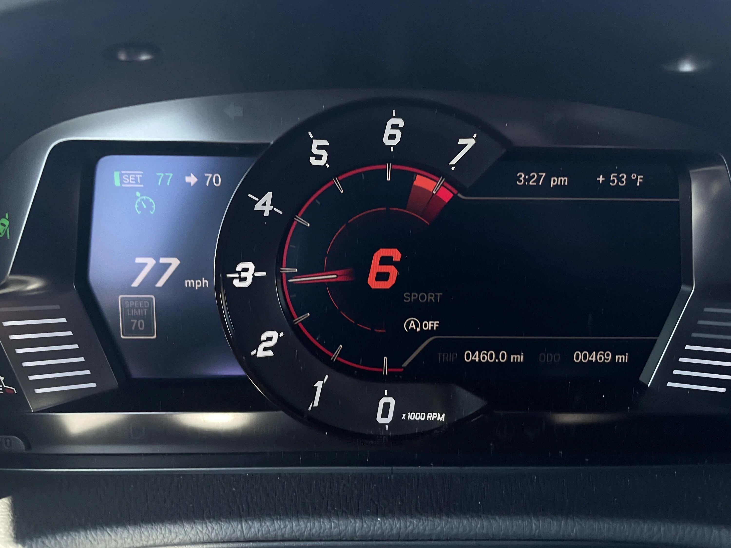

Here’s something that may be worth considering… a lot of the reviews that say “no drone” were done with automatics. The extra gears mean lower revs on the freeway. Here’s a shot of the revs the manual is turning in 6th gear at interstate speeds:
So part of question might become: what exhausts are actually drone-free at nearly 3000rpm?
Disclaimer for Internet Karens: this car has a typical BMW speedometer that reads way fast. 77mph on the speedo is 74mph confirmed with GPS.?‍♂
You can also just do the math with the gear ratios and tire diameters.

manuals drone a lot more, no way around it. what does not drone an auto, does have a little drone on mine
