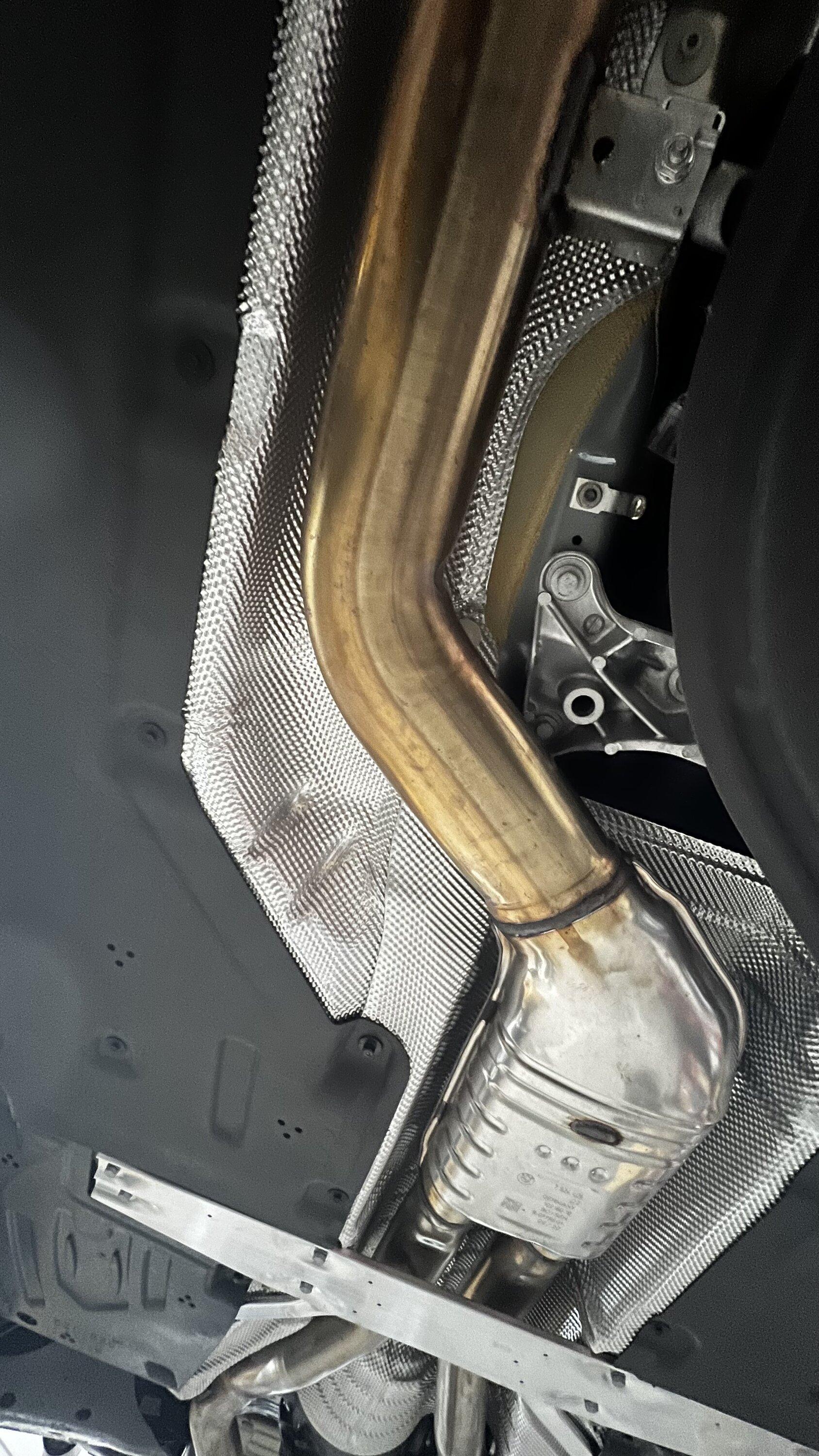

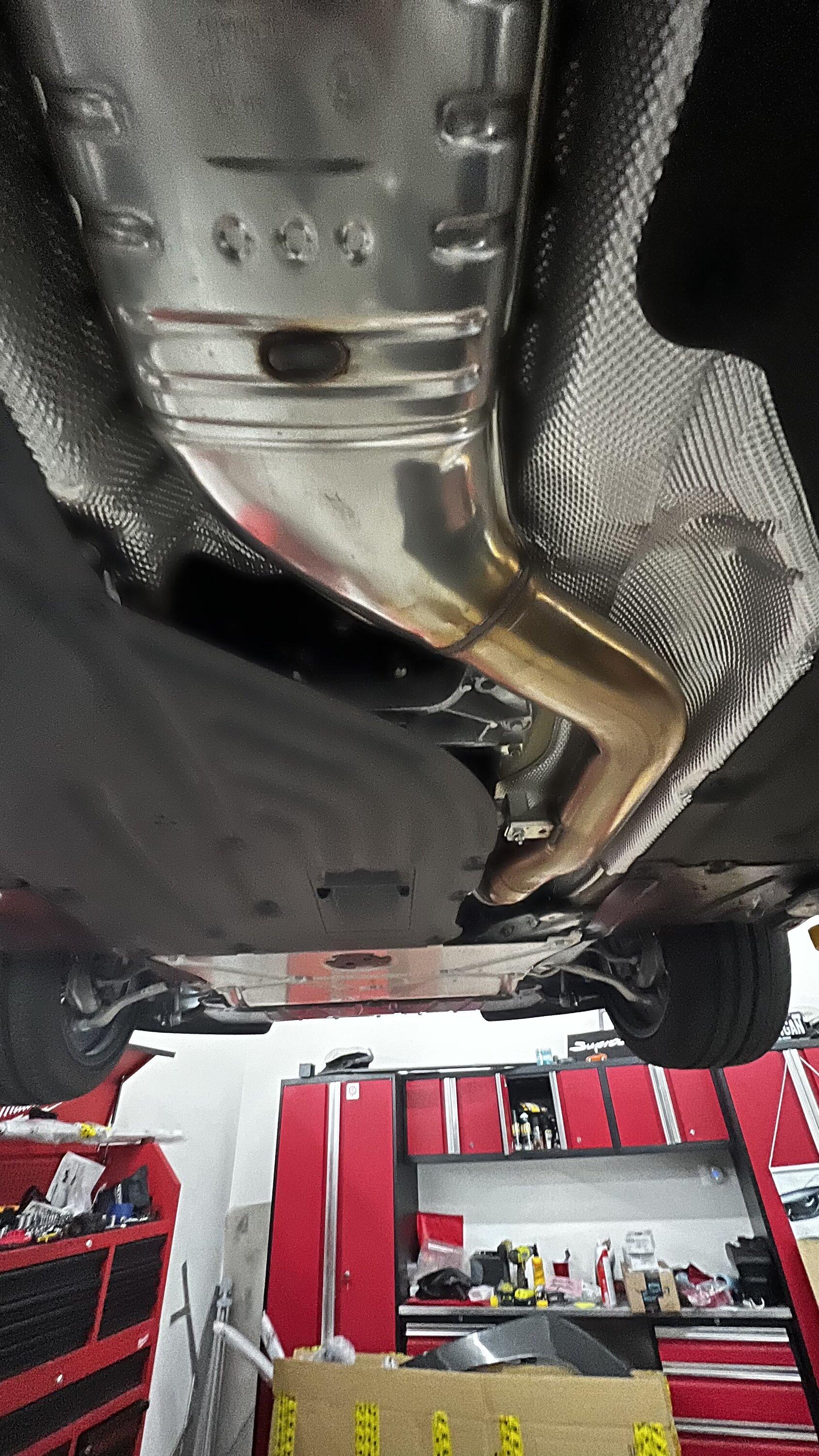

I’ve installed just about every exhaust that’s been mentioned here except the Injen which I’m doing this Friday. (I do install work for Speed Industry) or at least attempting to on a manual car. While underneath the only thing we think that may be in the way is the trans mount??? I took picture of the manual, doing a exhaust install on Wednesday on a auto to see if they are/look the same.
