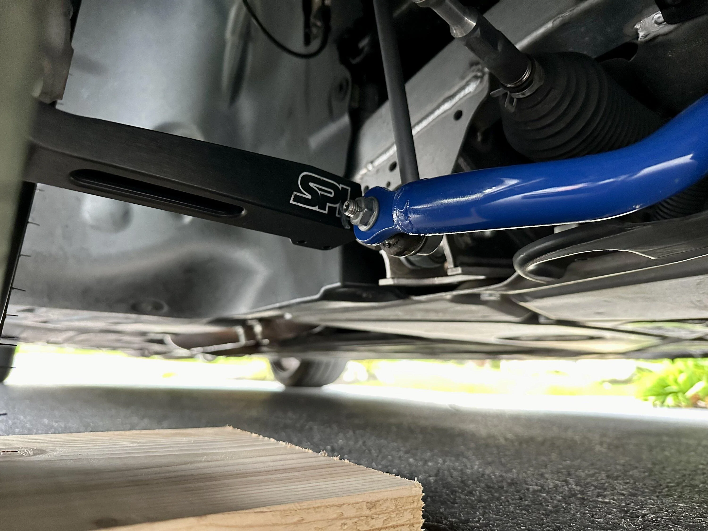

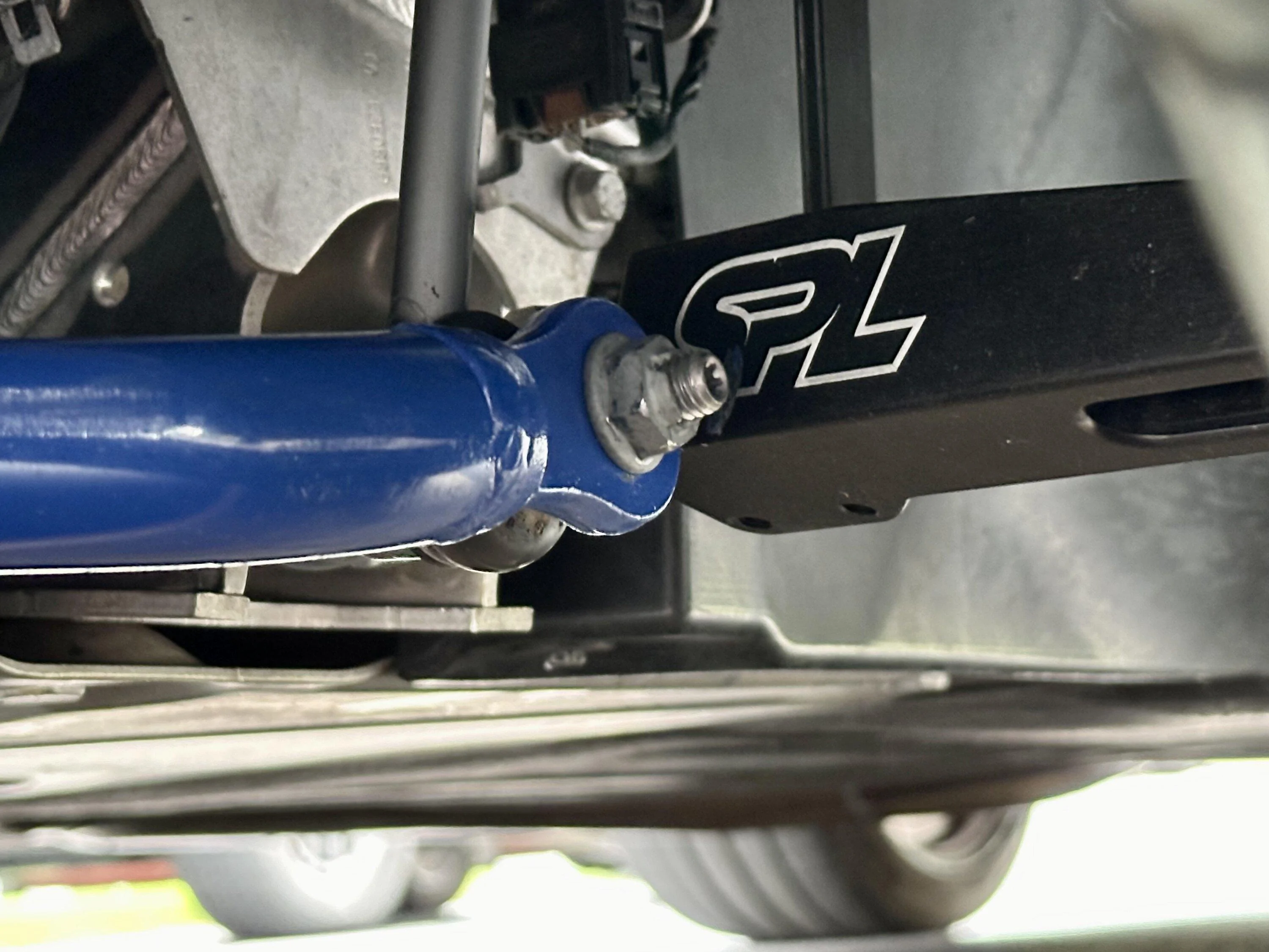

Finally got around to shortening the end links. This is the shortest they could go and this photo was taken at right height with the steering wheel at full lock.
I think I’m in the clear now. Really wanted to get this fixed and prevent any more wear to the rod end bearings I just had to replace.

Just checking in! I just had the SPL front lower control arms installed along with the Cusco non-adjustable front sway bar. Everything else is stock. I noticed some rubbing with turning and periodic clunking when hitting bumps. I checked underneath and there is some slight rubbing. Did simply shortening the adjustable end links to their shortest setting remedy the issue? Thanks! Appreciate the help.

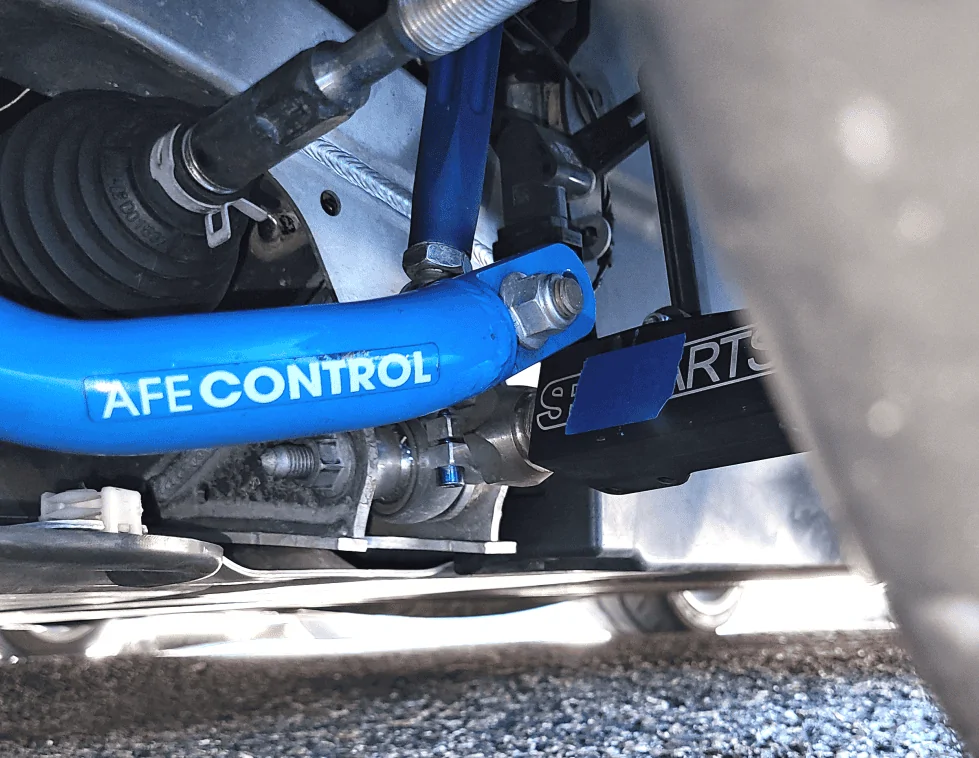

Also noticed from the image on the first post that your end links are extended. I'd suggest shortening them. At full droop it may look like lengthening the end links will make it better, but at ride height, the sway bar end actually lives just above the SPL arm. If you shorten them, the sway bar will rotate up and away from the SPL arm during normal operation.
Here is my car at ride height (swift springs). aFe sway bars and end links. End links are adjusted to the shortest length. I'm on the stiffest setting and no chopping. I have blue tape there to show any witness marks after shifting the bushings brackets all the way forward.

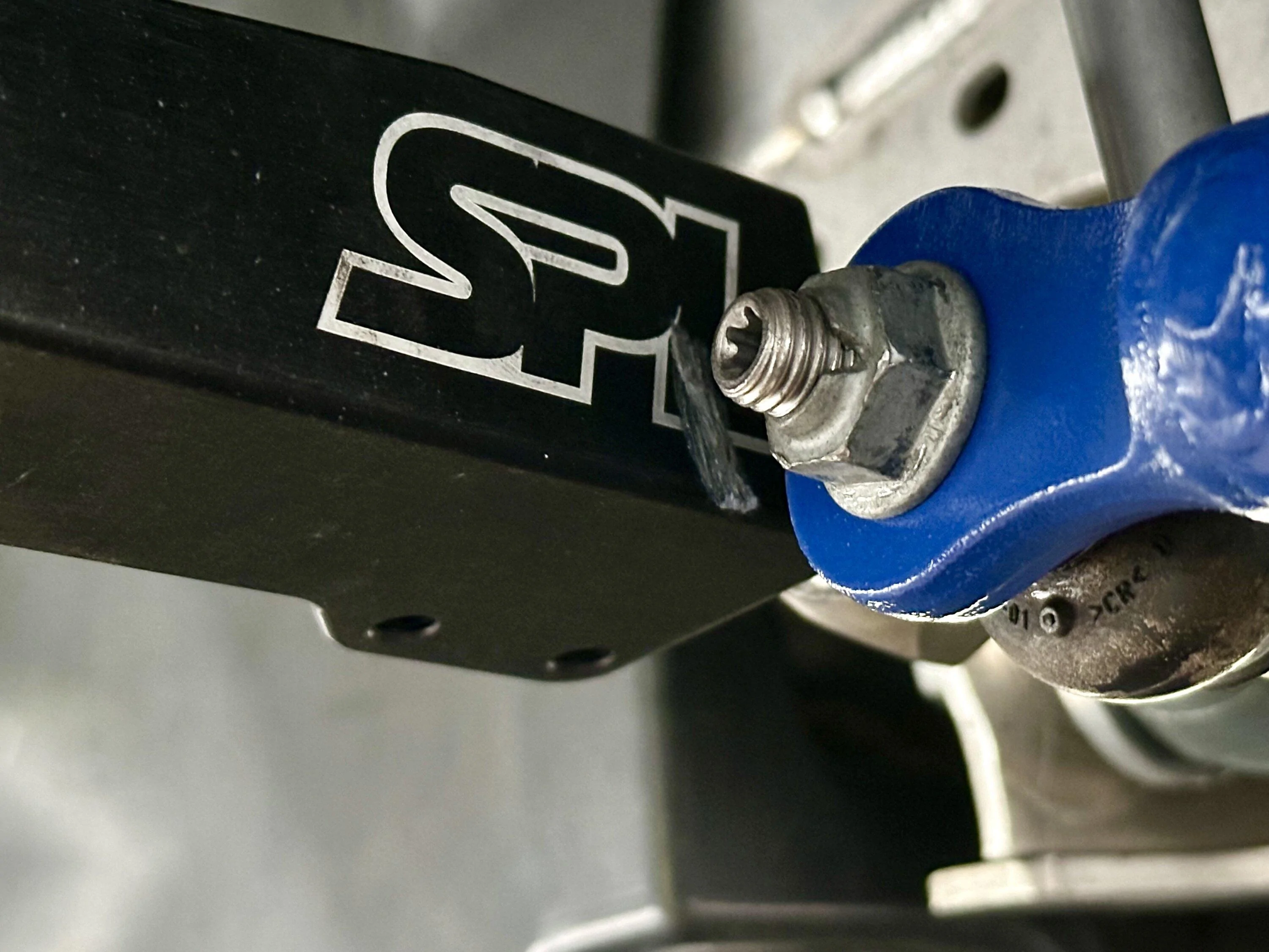

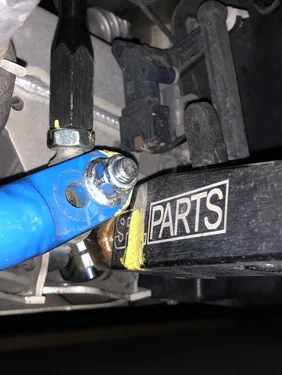

I drove the Supra around a bit today and this is what I’m looking at. Honestly the rub is barely noticeable while driving and I only hear it when making very sharp turns. Is this even anything to worry about? Maybe just a little grinding off the end of the sway bar would do the trick.

Having the same marks with stock sway / endlink / SPL arms.
